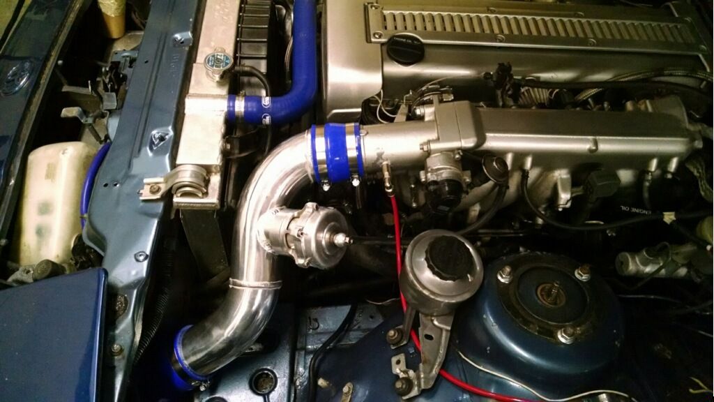

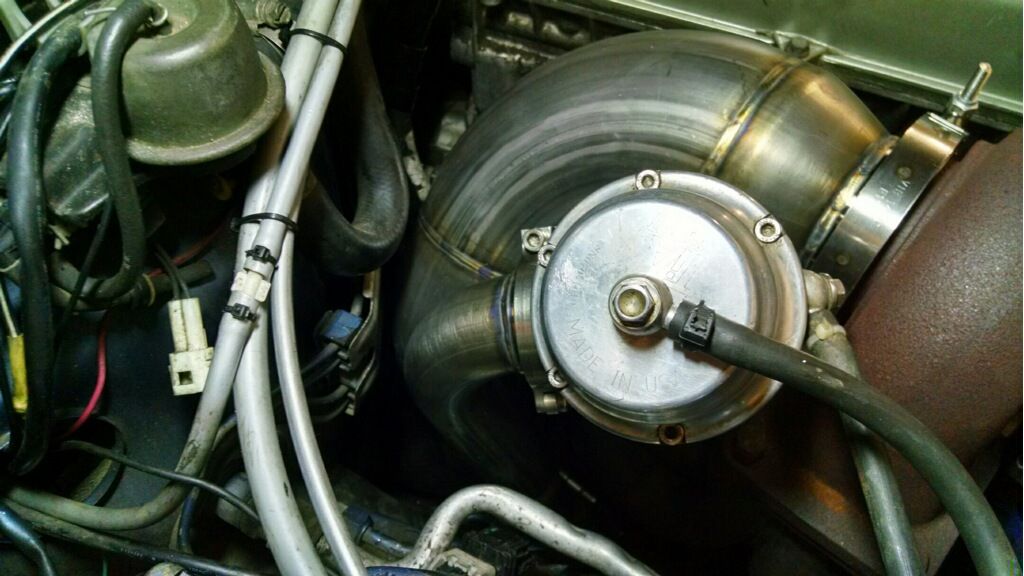

Here's a picture of my new down pipe.
Here's a picture of the cold side as well as where he drilled and tapped my methanol injection into the throttle body. The cold side is now 3" but the hot side is still 2 1/2"
