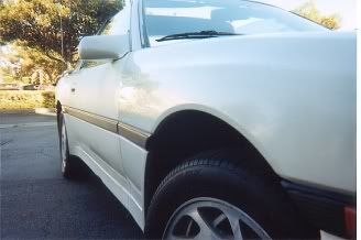

In this pic look at the difference between the fender and the door...my entire car used to look like the door does in that pic. :aigo: And that isn't even as shiny as it turned out when it was done!
