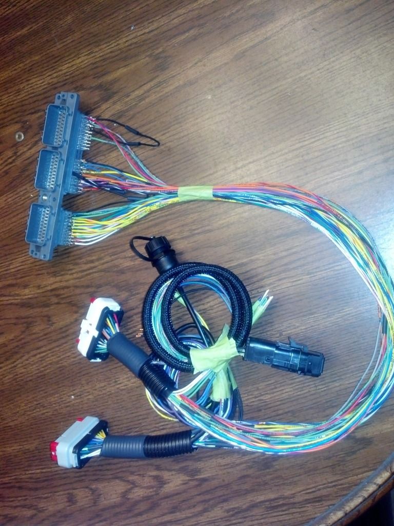

I also ran into a problem with my harness.
following this picture from MSextra:
My colors aren't matching(That's a brown wire BTW)

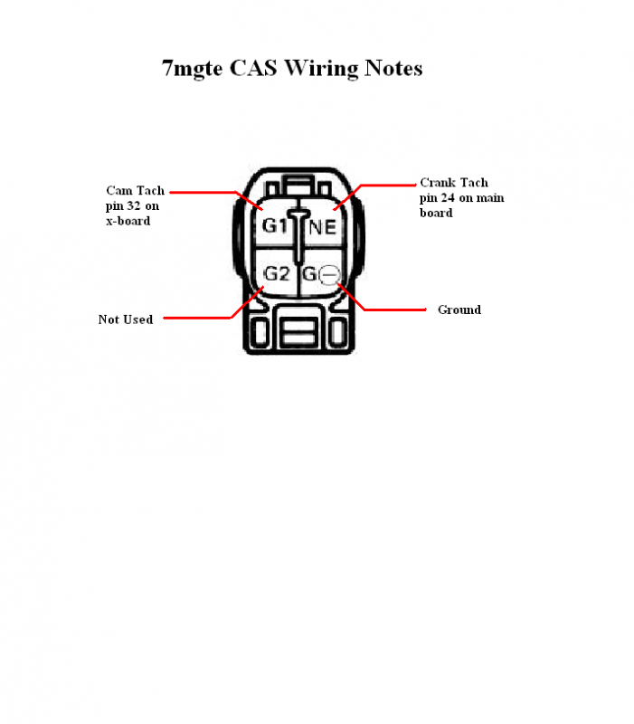

3tc power
Jan 3, 2009
106
Tampa FL.
you will need to use the shielded wire to hook up the CAS. you might need more shielded wire for your setup! so you will be using both the main and the X-cards to run the cas ok. now look and the main board diagram its pretty straight forward! the shielded wire that is in the ms3 kit has a black,white, and bare wire which is ground for shielding layer. the black wire goes to pin1 on the main board, then the bare wire goes to pin2, and the white wire which is signal will go to pin24. that is how your connector should be solder for the wire harness. now the CAS is simple main board pin24 goes to (NE), then the black goes to (G-) the the other shielded will be used from the pin32 on the X-board to (G1) and G2 is not used.
NOTE: you do not need a ground wire for the wire coming from the signal wire on the X-board....all you need is to run the wire from Pin32 to G1 done.
