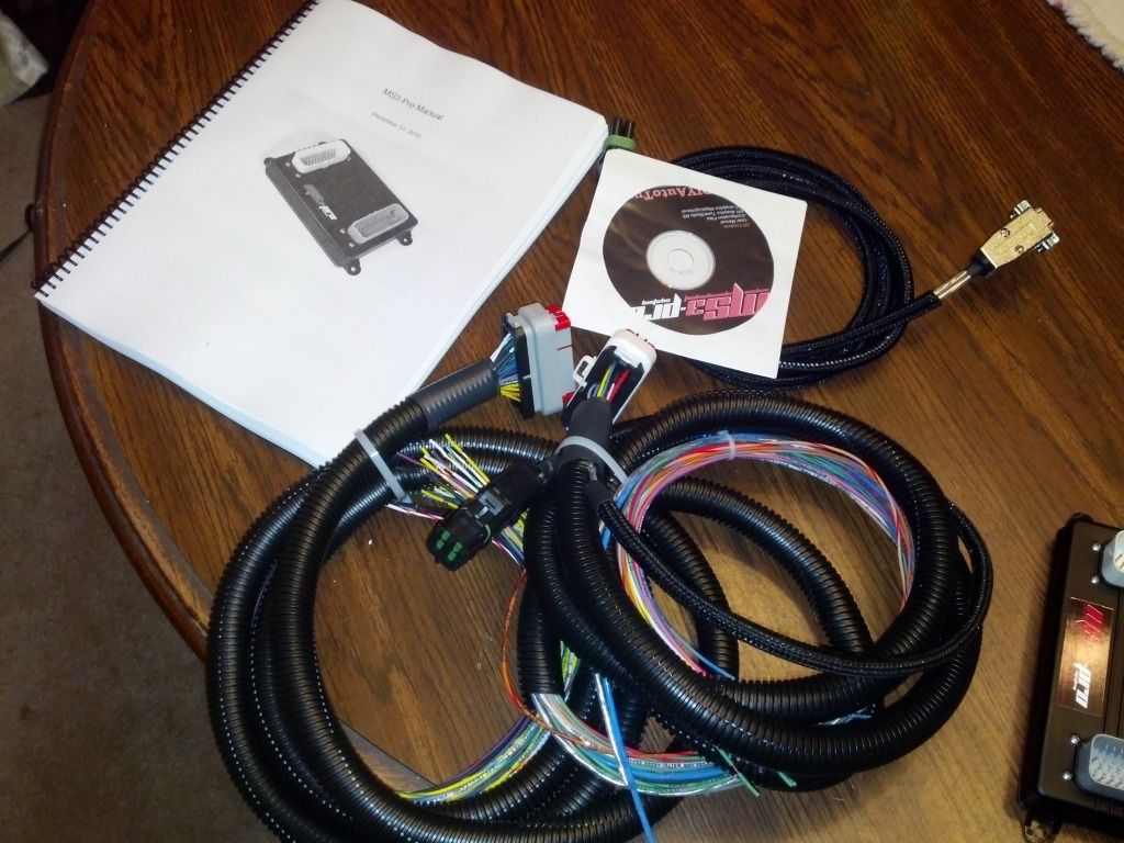

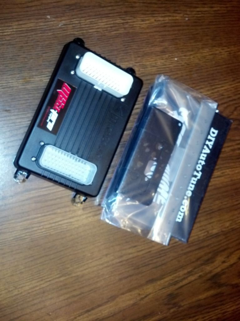

Lookie what came today.
This is Pro next to a regular MS alum case, about the same footprint, lower profile.
