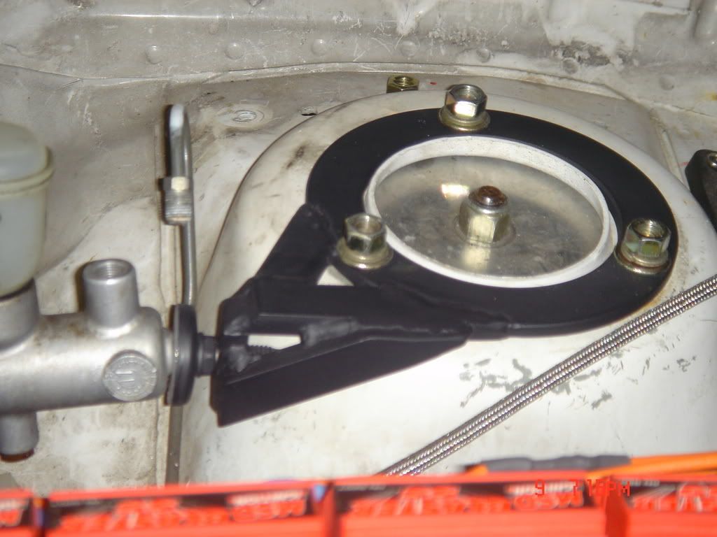

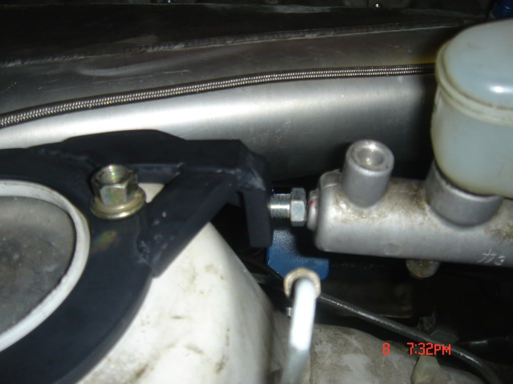

how dose it exactly attach to the master cylinder? through the mounting brackets on the fire wall??
No it bolts to the strut tower and has an adjustible bolt or like foot that you can slightley preload the master cylinder to stop the movment under hard braking.

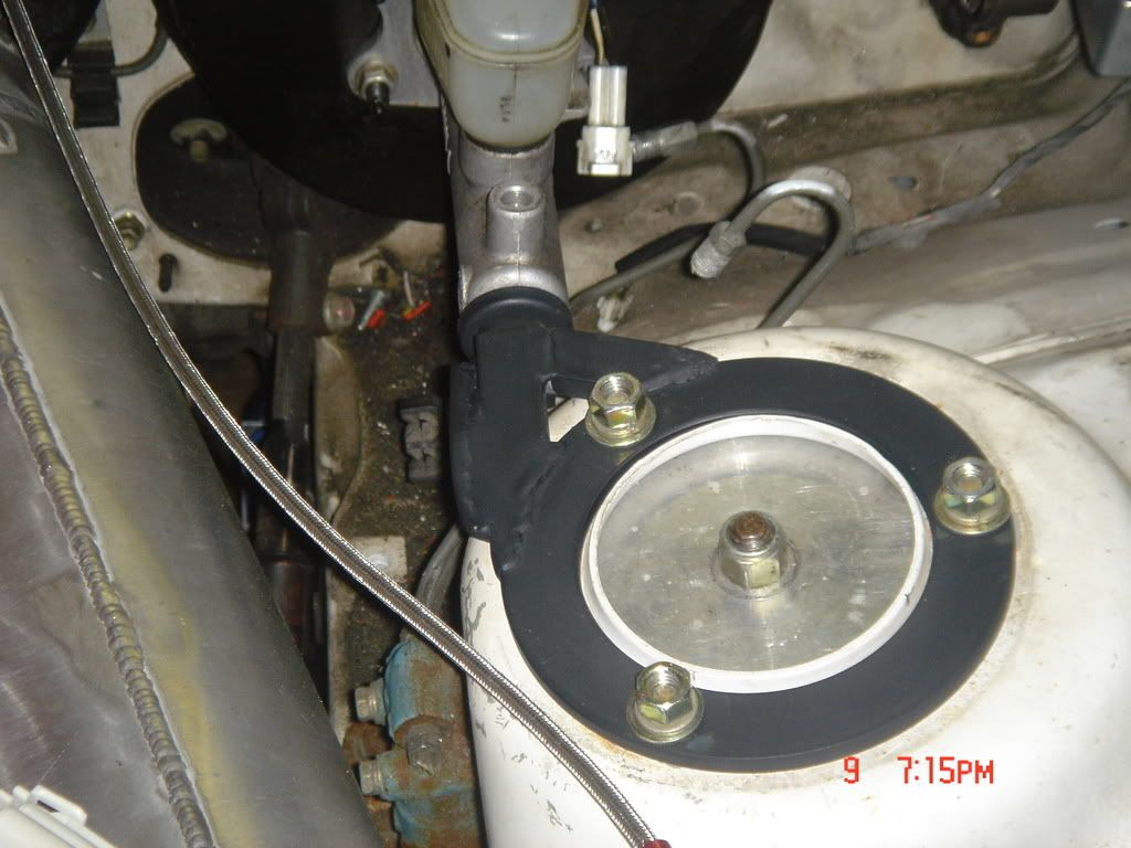

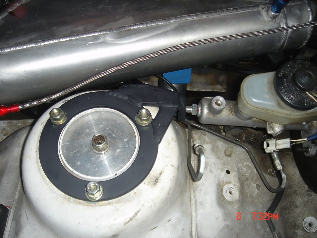

Ok well here are the pics but rember its a prototype so if any thing needs changed or adjusted nows the time so i need your guys input. The bolts should be in tomorrow so when they come in ill post some better pics
