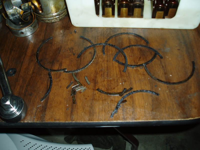

no the 1 - 3 -2 were written on the rod caps, only the one with 2, cyl 3, was bad, the rest are still intact, perfect.
Burning oil sucks.bigaaron said:A new set of rings and a cylinder hone would be required unless you want your engine burning oil.
