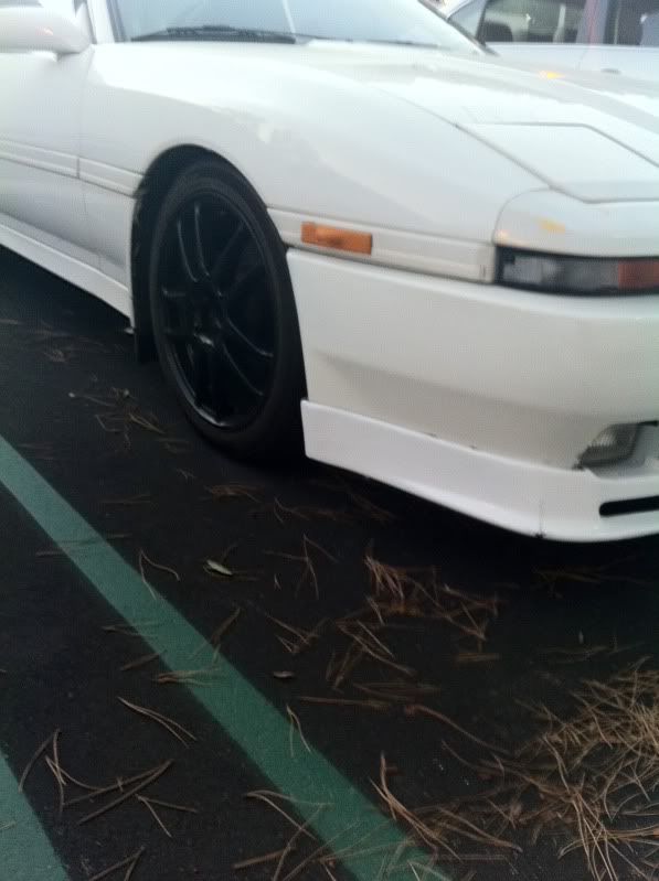

Anytime youi slam a car with bigger proper fitting wheels you will most likely have to roll and possibly pull depending on what you want to run. Along with that the fender liner will either need to be modified or removed.

Took a couple days but here are the shots of the front fitment. You can see the right side where the tire as pulled out the fender. And just to reiterate, this is stock size tires on stock rims, with illumina II struts with h&r springs.

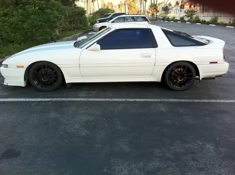

damn thats weak sauce. my car is lowered 2" with cheap ebay d2 springs and cheapy kyb g2r's shocks and i havent even rubbed once. check it
