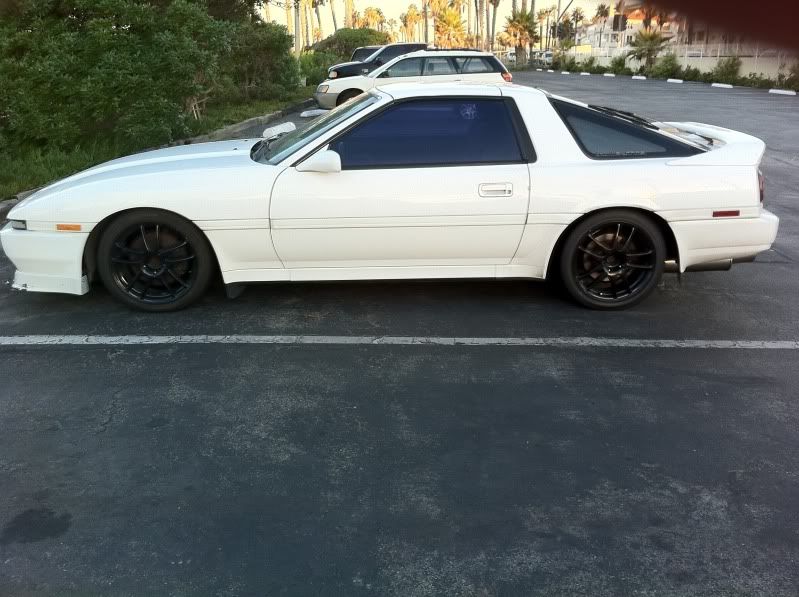

see and for me this is where i im gonna have to compromise because the front looks perfect in the front but the back looks too low for my taste...i kinda like that slightly higher in the back look...not much but a bit...im thinking the rsr race would be good for me or the eibachs i guess....

These might help you decide. Eibach/tockico ill2 combo. I like it better than old tired set that was on there.

i like it! still would like to see the back up and the nose down just a touch if it was mine...but without coil overs thats the best ive seen so far....do shocks effect the stance or height at all? now just need to see one with the rsr race on it....

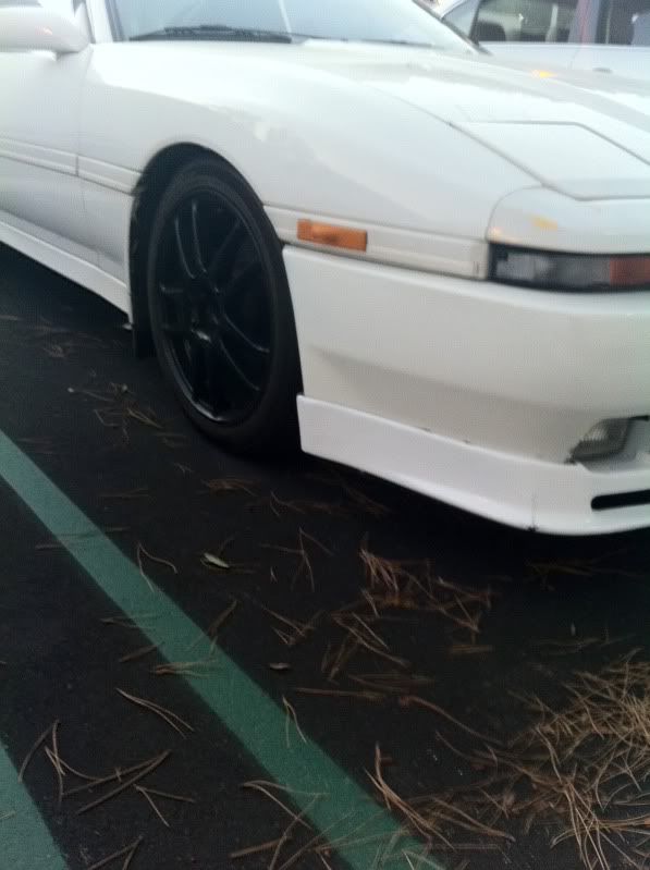

^ on normal driving style the front end is too low with H&Rs, they tend to rub up on the inner fender wells whenever you dip or hit a bump etc.

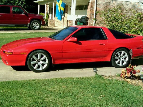

Ihave them with eibachs. Im a tad lower than friends with just eibachs and say kybs. Only prob is (cant remember) fronts are as low as they go and rears are on high. Might be other way around But its not like you can just slam it with them. But bilsteins are amoung the top quality shocks and have been for years.

nice so thats exactly what i needed to see...eibachs on bilstiens...i like it....now i just need to see the rsr race springs with bilstiens....looks good...
