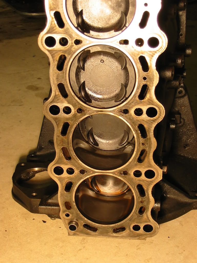

Mark, here's a picture of what I was trying to tell you about earlier. This was posted on Surpaforums and it's gte block.
Awesome, let's do this. I see what you you mean about the valve reliefs.....
EDIT: Are you saying that the block you have is a GTE block?!?!?!
I bought it as a ge block, but the pistons look like those. I'll look at it tomorrow and see if it has oil squirters. I'm sure it's a ge block, but you never know.
