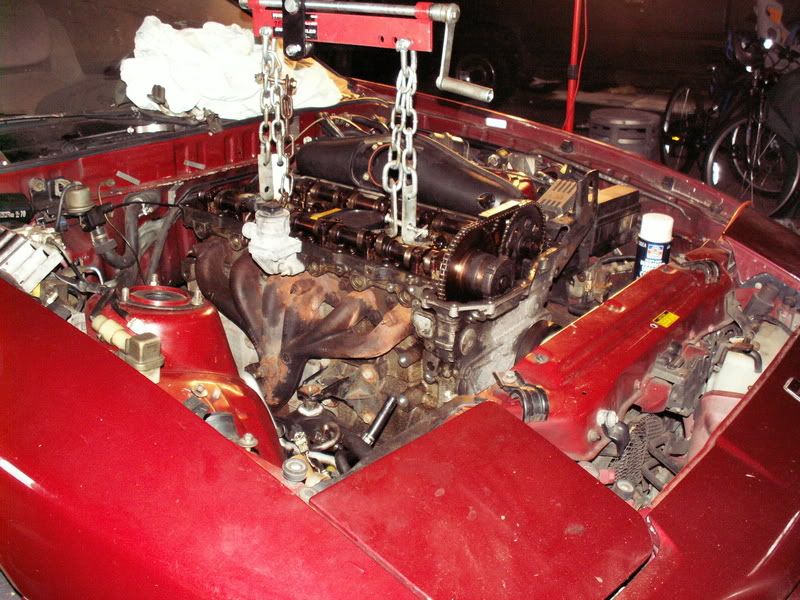

Now I can lower the engine on to the mounts!
Hmm, it's sitting a little crooked. My driver side mount came out a little taller than I intended. Next step rework that and try to fit the bellhousing...

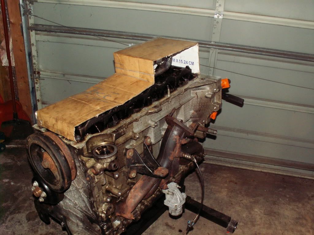

Could just be the angles of the pictures, but in those last shots with the 4.2 resting on the Spacer/Mounts, it's looking like the top of the engine will still be interfering with the Hood.
I'd just say "f" it, and mock up a stock hood with a taller Cowl.

The engine was sitting a bit crooked because I tried to bend my driver side mount instead of just welding it. I re-did it and now the engine is sitting nice and straight. I propped up the rear and took the cherry picker off. This is how it's going to sit.

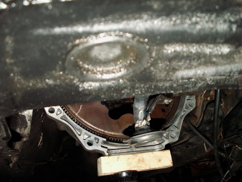

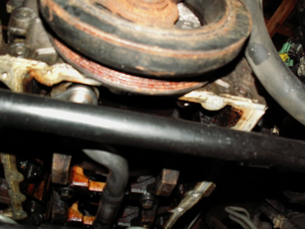

With the exact engine placement locked down, I had to rework my pickup tube. With the stock sump depth, my pickup would be the lowest point on the car by almost two inches. Not a good thing to high-center on. I took about 2 inches out of the tube and re-brazed it:

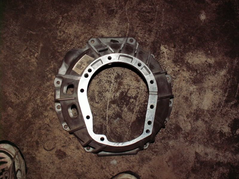

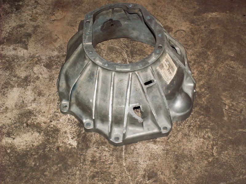

I'm using a bellhousing from a Hummer H3. It bolts the 4200 to any of Aisin's AR5 or R series transmissions. Prior to this swap, I had replaced the R154 from the Supra with an AR5 from a Pontiac Solstice. So now, the entire drivetrain will be MY2006 "GM".
It took a little grinding on the ribs to get the bell to fit in the Supra's tunnel. As pictured, I can raise the engine until it is level with the chassis and still have a modicum of clearance. I'll see how the trans mount lines up later.
