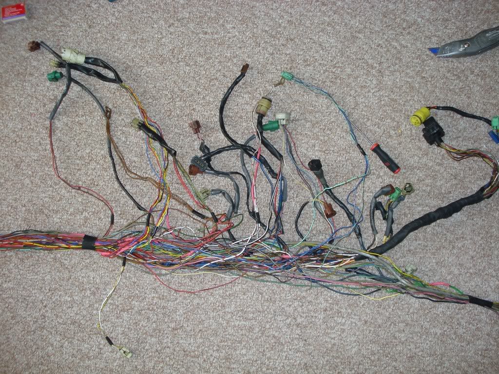

I can't believe that I forgot to update this thread. Here's what the wiring harness looked like when I finished it.

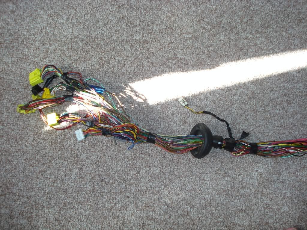

ECU side unwrapped.

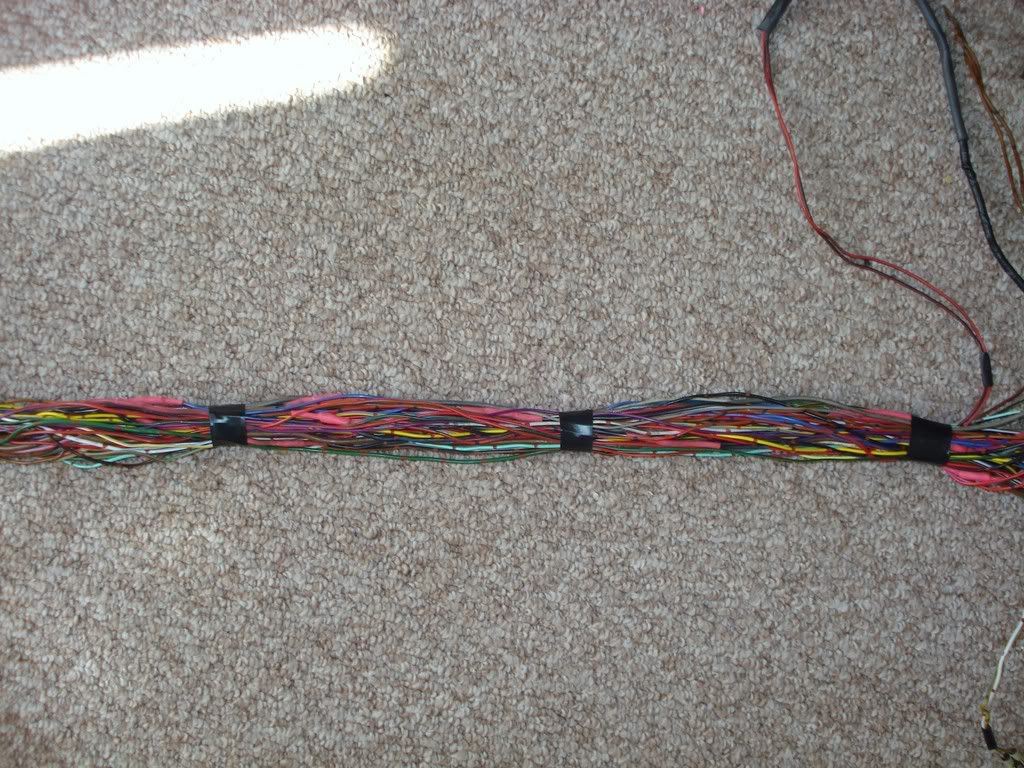

Middle of the harness bundled together. Note the few splices I did make are staggered, and kept sealed with heat shrink tubing.

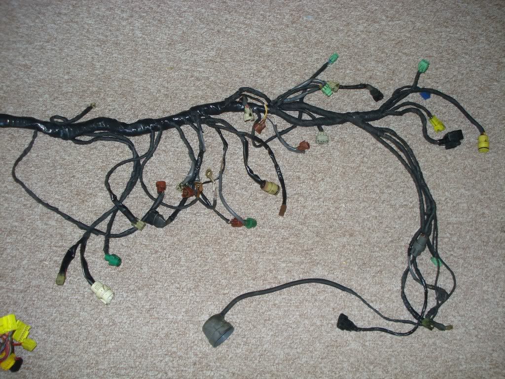

Engine side of the harness.

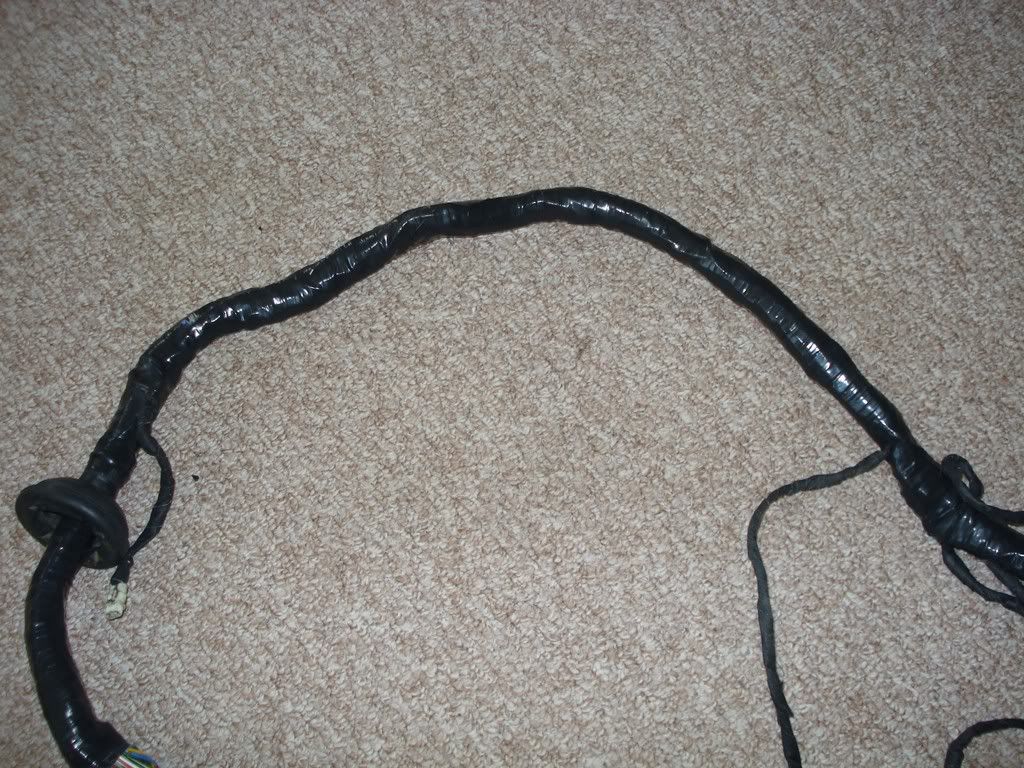

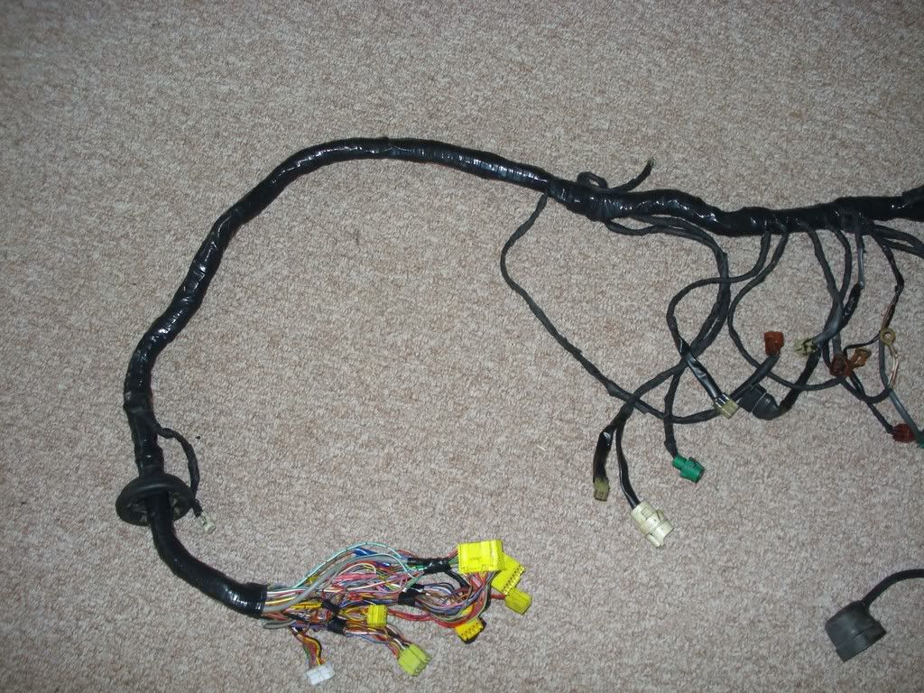

Here's the harness after it has been taped up, and wrapped with silicone tape.
I didn't wrap each connector with silicone tape, as I plan on using wire loom to cover and protect that. All in all, it was about a week and a half worth of work. (A few hours a day, mostly while watching TV at night). It wasn't too hard to repair, but it was very tedious to say the least.
