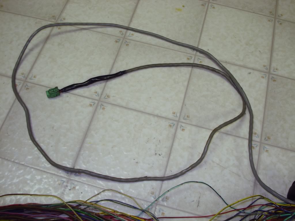

One thing I noticed, You have two very thick brown insulated wires. Those are your knock sensor wires. You need to replace those with very good insulated wiring. I'll have pictures of the wires I used to do that with. Basically, I used thinner RCA cable, double insulated. It was a crazy challenge to strip and ground, but worth it. I see that your old Knock Sensor wiring is burned as well. I seperated these 2 wires from the rest of the harness. Like I said, I'll have pictures probably Monday to show you.

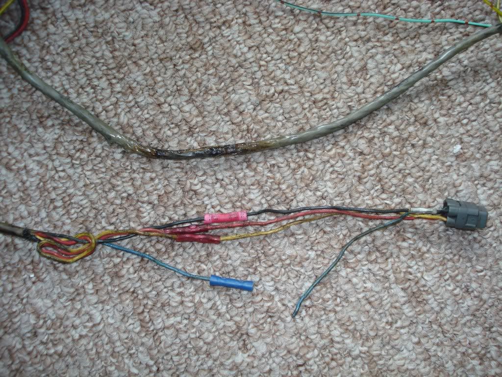

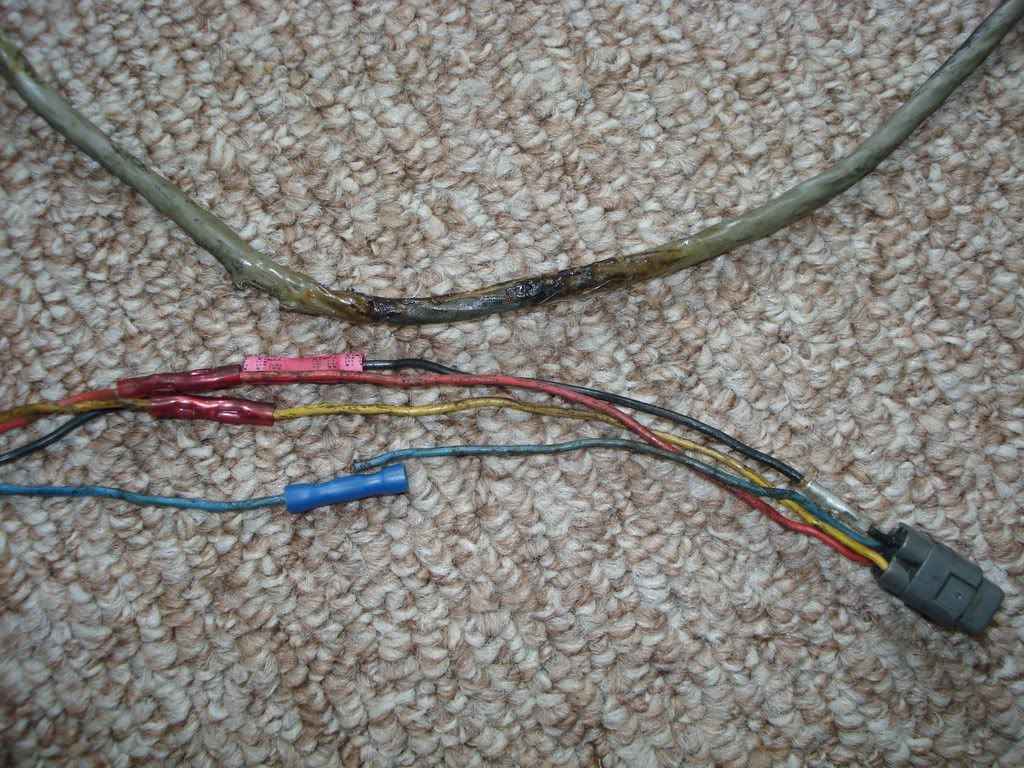

Back on topic, here's a good pic of some of the wiring hacks that I'm dealing with. This is the wiring going to the CPS plug:

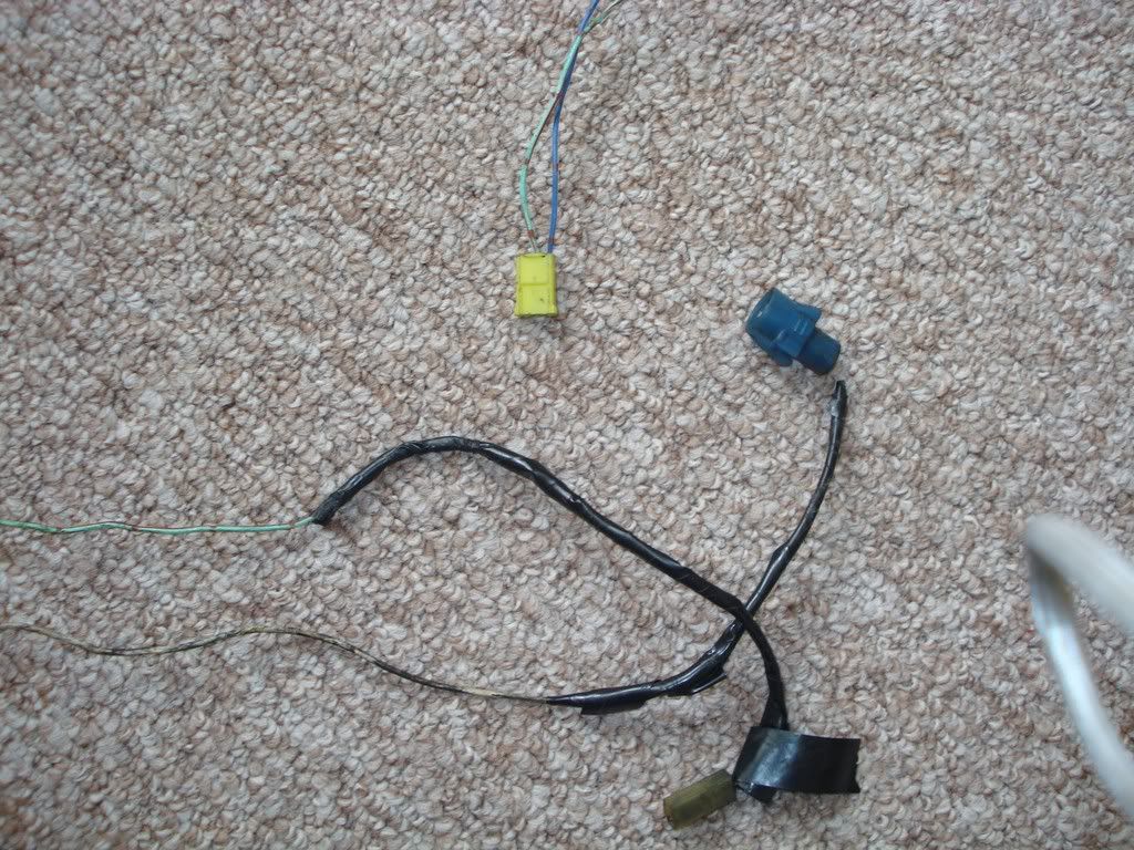

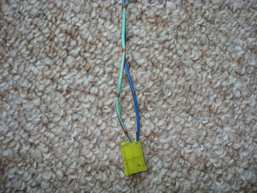

Also, one quick question. I have this plug on the engine harness that's by the ECU; however, once installed, there is nowhere to plug into my vehicle. I've looked under my dash numerous times, but I don't see where it should plug in.
Here's the wires that the plugs run to:
It looks as if they go to two temp sensors by the thermostat.

Um, is it the plug that goes into your glove box light? There's a little plug I remember down there that plugs into the glove box. That looks like it. Damn if only I'd had pictures. I was just re-wiring my knock sensor wiring, and had my ECU and glove box out.

Show me the face of the connector, I've got my whole shebang disassembled and can tell you tomorrow if I don't remember off the top of my head.

Those are the A/C fan switch pugs. Your early NA chassis isnt going to have the pulg for those unless you swap the main harness out. You also will not have a working cruise conrol without swapping main harness.

Good to know. I'm not swapping out the main harness, so I guess that plug will just hang there. (Or I can just delete it from the harness, as I already have those two wires separated from the harness).
Out of curiosity, why wouldn't the cruise work without swapping the main harness? Everything else plugs in, except for those two plugs; which seem to be temp sensor related. Is there something else that's missing which the cruise control needs?

Update: Here's the repaired CPS wiring in the harness:
The wiring that I pulled out of the other harness was missing a few inches of ground wire, so that was soldered in, and wrapped with heat shrink tubing.
On that note, I carefully studied the ground wires on this new harness; and there's no way I can replace them with the ground wires from the GE harness. The other cables that tie into the grounds are too different to use on the GTE harness. Some splicing of cables will be inevitable, but I'm still going to keep the splicing down to a minimum. In fact, I think I can replace the ground from a tie-in point, to another tie-in point; so the splices will be where they are when the factory spliced in some other wires. That should make it so that there are no unnecessary splices where there shouldn't be splices.
