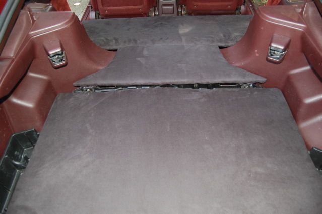

Here is what my trunk looks like now-
I just need a little more fabric for the center section to create a flap to hid the oem hinge thingie
Thanks to this thread/ #04 I'm going to install a spare tire sub woofer once I find one for a decent price. I like that you can remove the woofer and tire to lighten up the back.

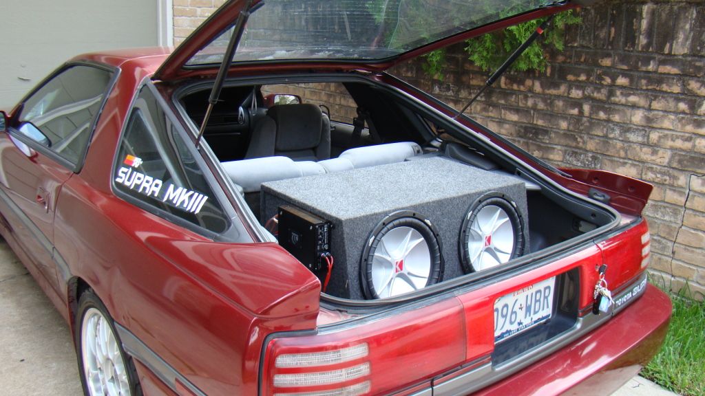

Makes my sub look massive.. Its just the right size to fit right under the cargo cover and slide onto the rear seats. When they're folded down of course. :D
