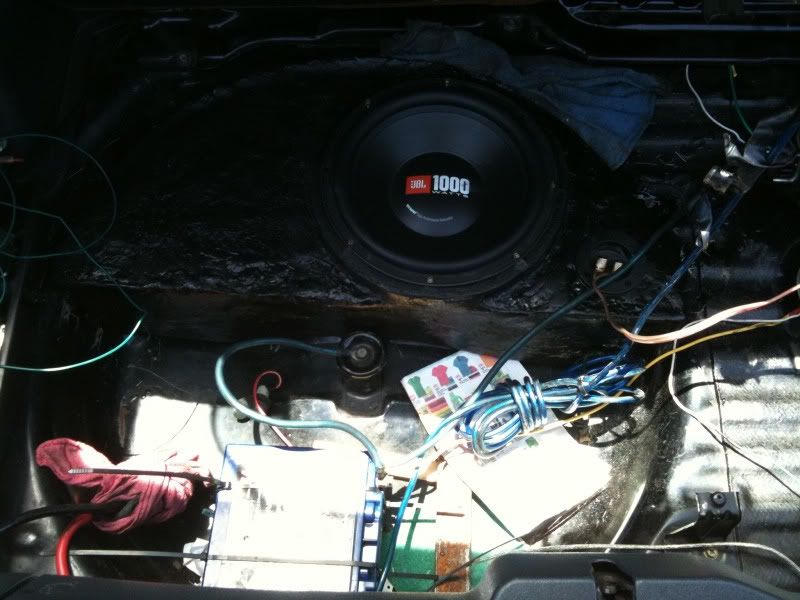

Unfourtunately no, The sub has a 8''X12''X12'' box that is screwed on and sits in the wheel well as you can imagine, and the amp is under there as well. I know the box is small but it give just enough bass, plus the sub is a walmart special haha, that thing was pretty complicated as you have to make it in two parts then try to square up the line in the middle that is cut. Almost gave up but some tricky trimming got it right. It sits 5 inches above the flat part in the hatch.

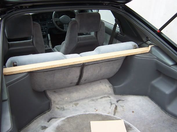

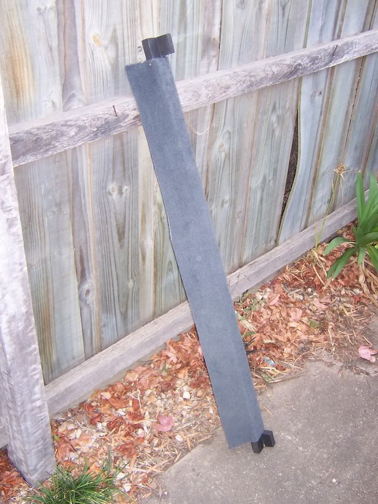

this is the 'strut' that fits where the stock blind would mount and will provide the hinging point for the actual shelf

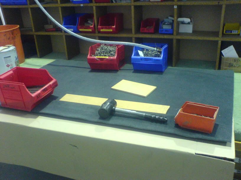

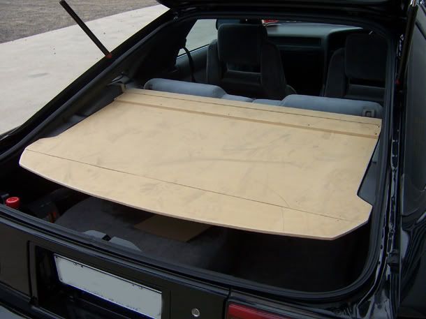

the parcel shelf its self, note i constructed it of 2 pieces so a small amount of flex would be available for where the hatch hits the very end of the shelf.
Got some medium grey carpet from bunnings to cover the shelf with, i decided grey would better suit the interior than black, make it look a bit more like it was meant to be there... glued the carpet on with the same adhesive they use to glue fake turf down.. so it should hold!
strut:

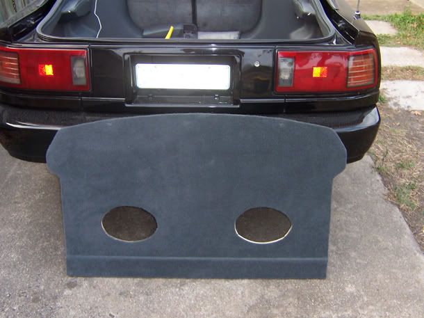

Shelf:

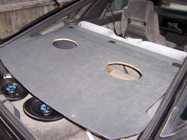

carpeted and trimmed strut and shelf.. automotive carpet can be trimmed and wont fray on the edges, i decided to cut it to shape as trying to fold it under would have been too bulky to work with, and when the hatch is closed you cant see the edges anyway

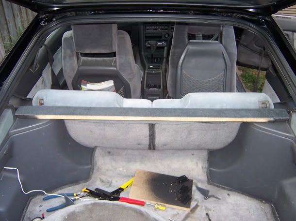

Strut installed:
As mentioned earlier it utilises the stock blind mounting point once the clips were removed and simply bolts to the vertical side of the stock rear speaker/strut cover (unscrewing the bolts allows easy removal)

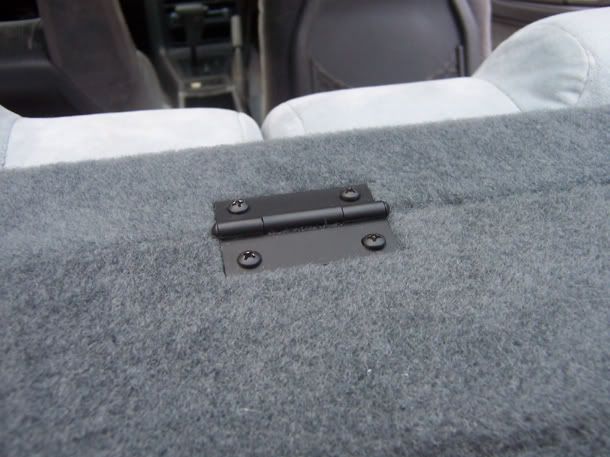

There is 3 hinges along the join, stainless steel hinges cleaned and painted black to blend in a bit better, i also coated the mounting screws:

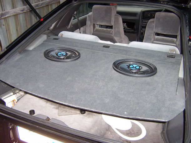

speakers in:
i extended the existing speaker wires and routed them through a hole under the speaker and into the hatch area, these can be threaded back up into the trim for when the shelf isnt in use.

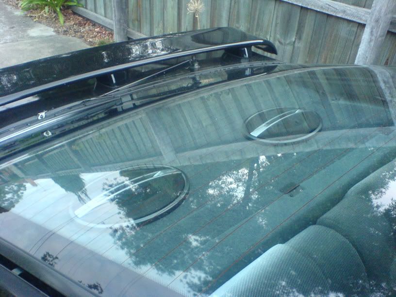

view through the back window:
with the hatch closed you cant see the edges of the shelf and it gives it a nice OEM look, the mounting at the strut end, and the pressure of the hatch at the back keep it locked down and avoid any rattles or bouncing whilst in transit:

The sound compared to what i did have is extremely good.. a bit too bassy as i havent played with my settings yet..

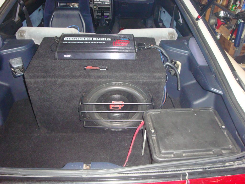

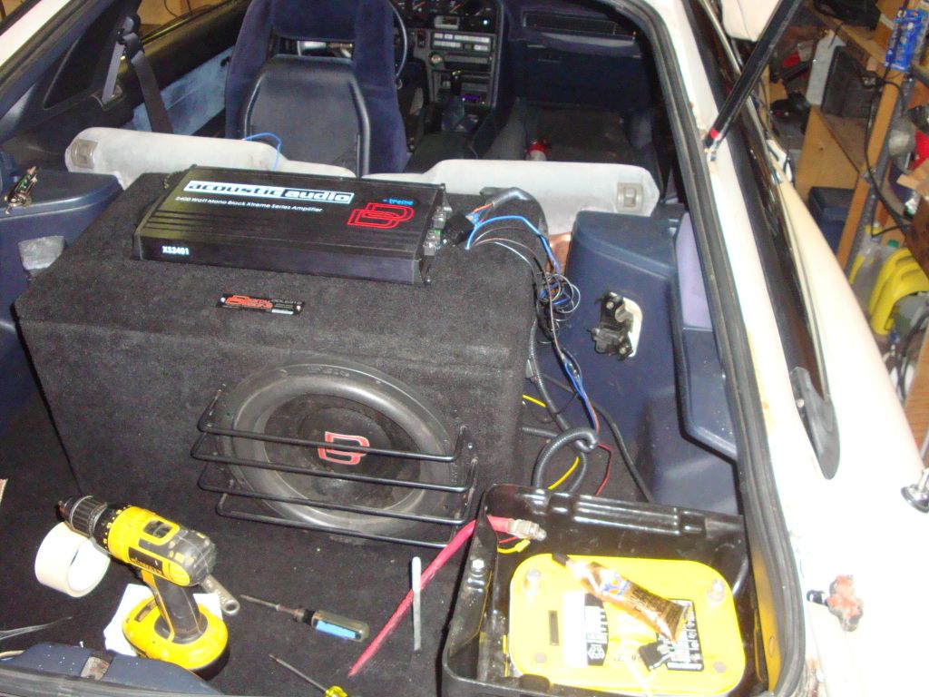

Here's my setup
Nothing too crazy but functional. Im running 2 Jensen amps, a 4 channel 720 for the highs and mids, a mono 650 for the subs, and a capacitor to eliminate the dimming of the lights when the bass hits. The targa fits with the box and i kept my spare. I built the box so it can be taken out to access the spare or to shed some weight before race day. Enjoy

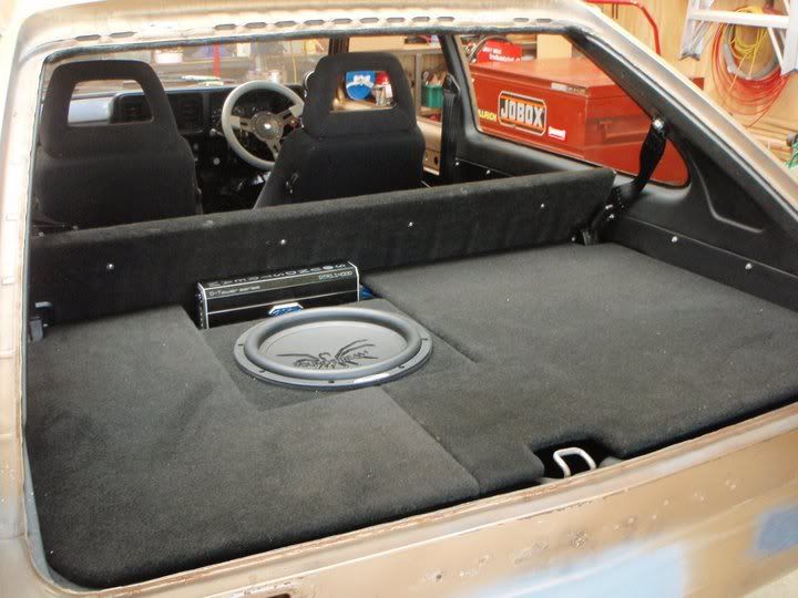

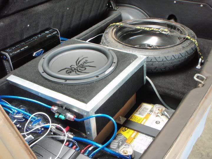

Not sure If I want to be adding more weight into my supra but here is my setup in my 1980 vauxhall chevette, sorry for going off topic but may give a few ideas.
Soundstream 1400 watt amp running 900 watt sub
Pioneer 280 watt amp running 2x Soundstream 6x9s in rear door cards
All running off a large battery in the boot from a truck
Car fully dynamat

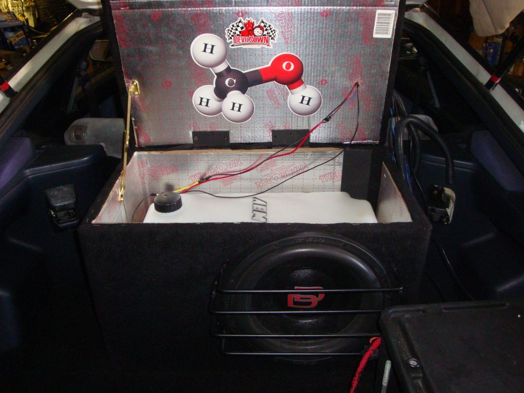

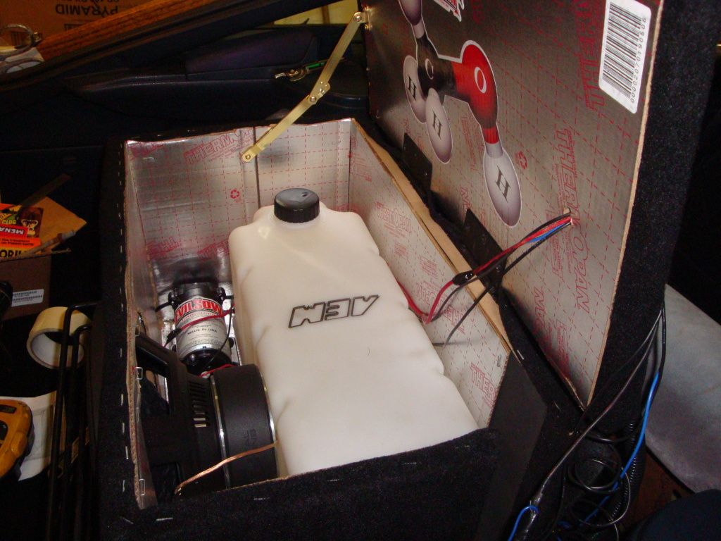

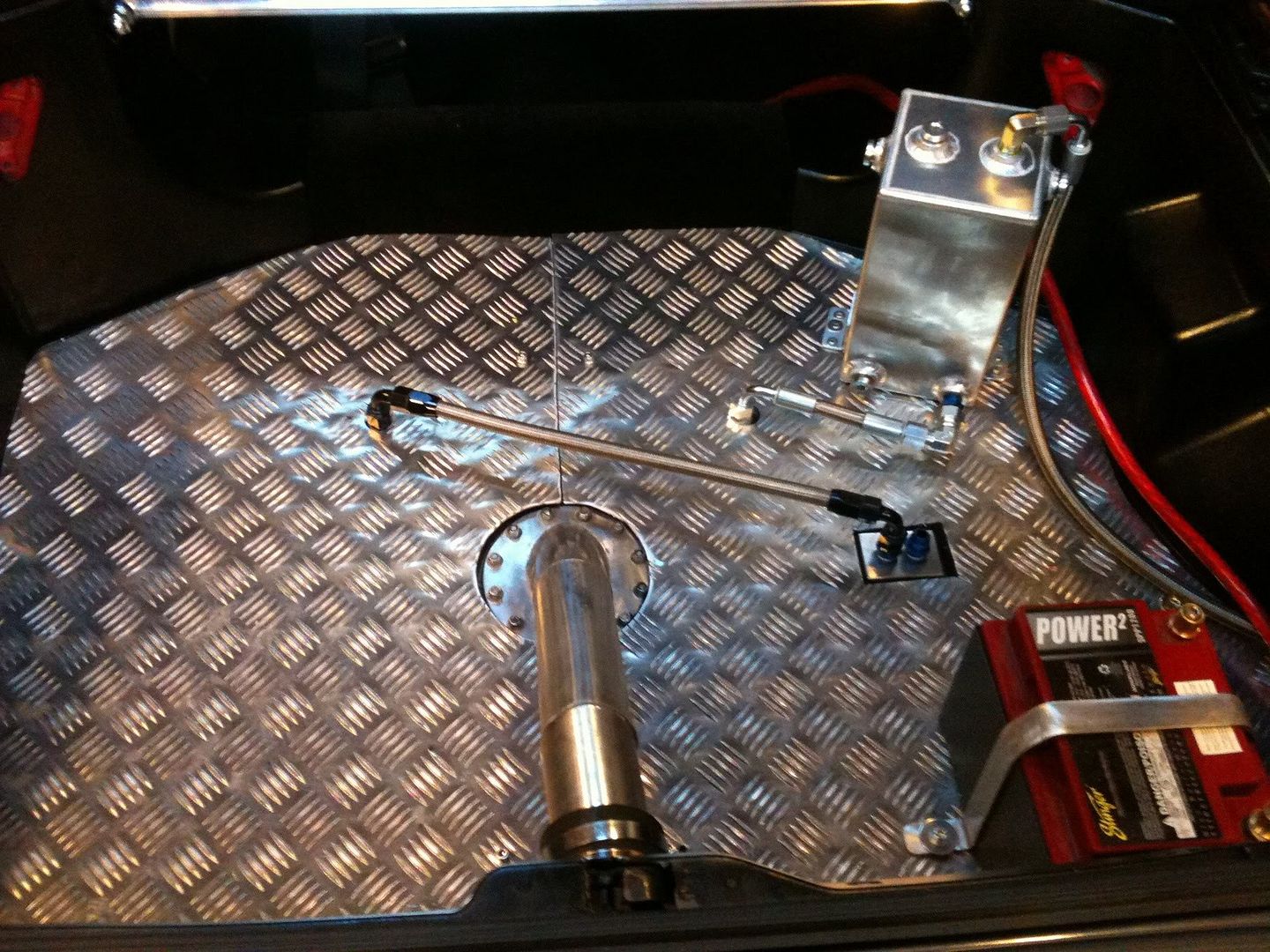

You have no idea how much that means, it was a lot of work/wiring/thinking to start from scratch, I know it doesn't look hard at all, but somehow it was! The meth is root beer scented, and it now has a T76 and 100 psi more on the meth pump! After Anti-Lag is wired, I'll post a vid in the, well, vid section. Thanks again.
