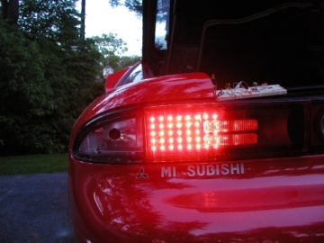

So I've basically just finished my design on this (puttin that degree to some use!!...and I'm bored as hell) and I think I'm going to try and go ahead and actually make a set. But I want to see what it looks like ON a Supra first. Does anyone happen to have any pics?

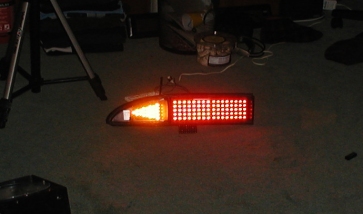

Thanks for the link! All the info I need is there. I'm now considering using the popular new Superflux LED's spaced further apart. I'm beginning to think it looks a bit more modern, what do you guys think? (Example pics below)
I've got a spare cracked tail that I will try to separate using the oven method (250 degrees for 5 minutes) Anyone else done this successfully? I might even investigate putting the LED's into the center lens for an NSX-style full width tail light bar!
