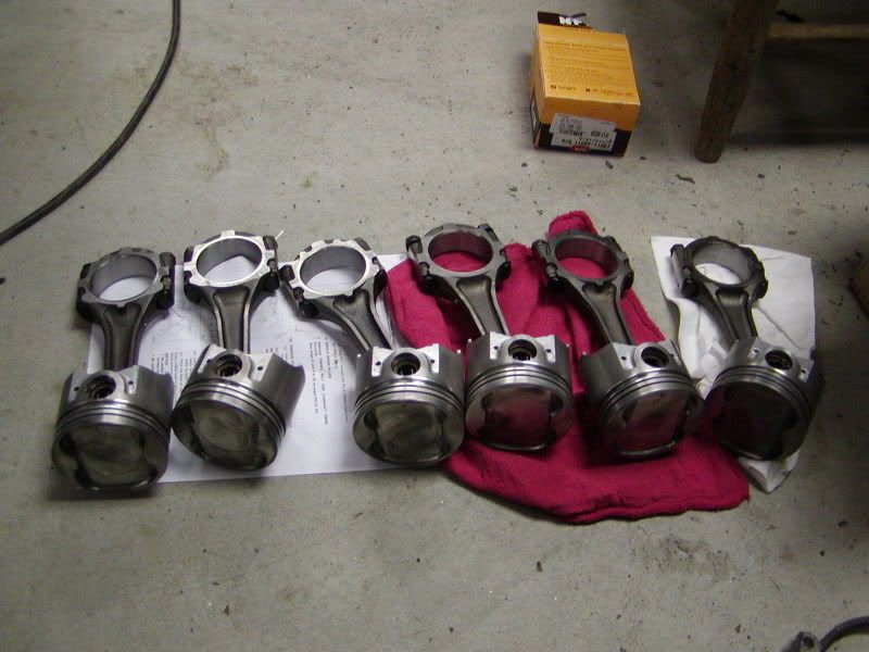

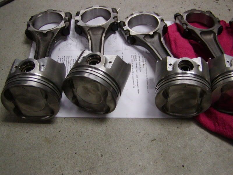

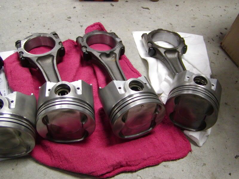

First off i got my rods resurfaced and look pretty good...
OH and those FORGED PISTONS...hahah i wish...just look all shiny and stuff...lol...

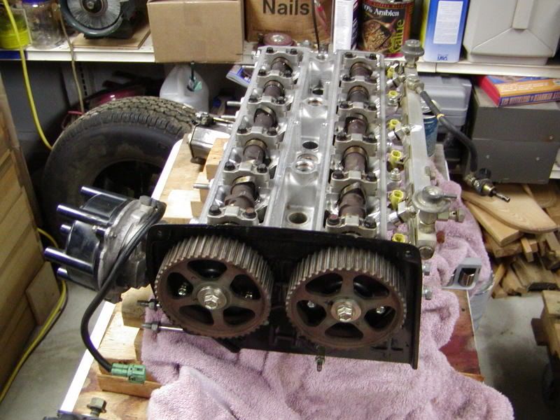

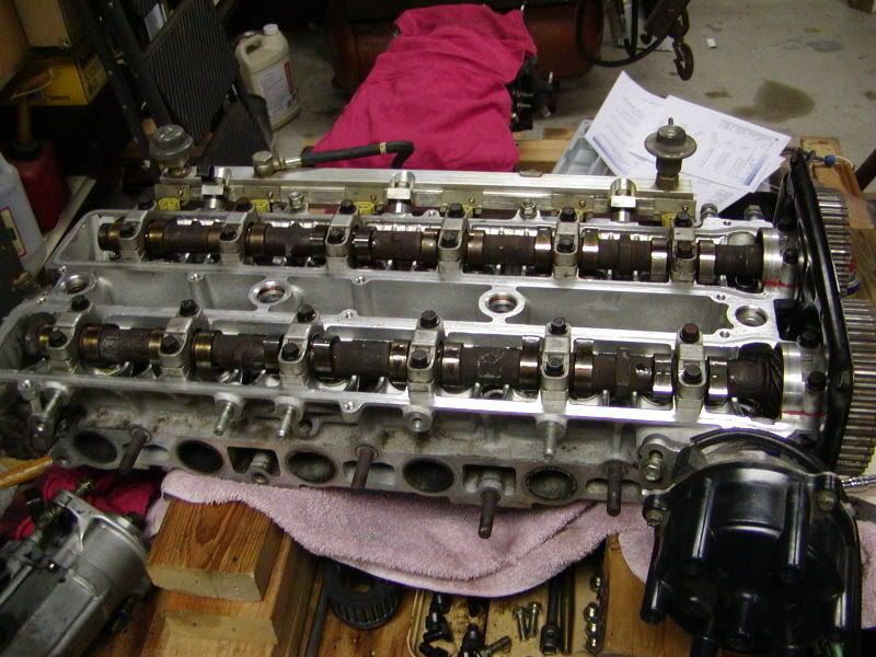

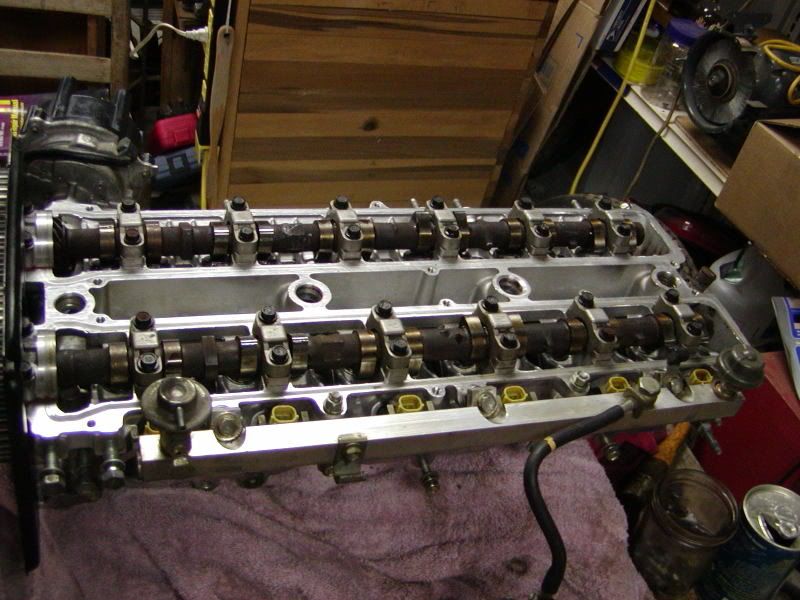

Also Put the head mostly back together...

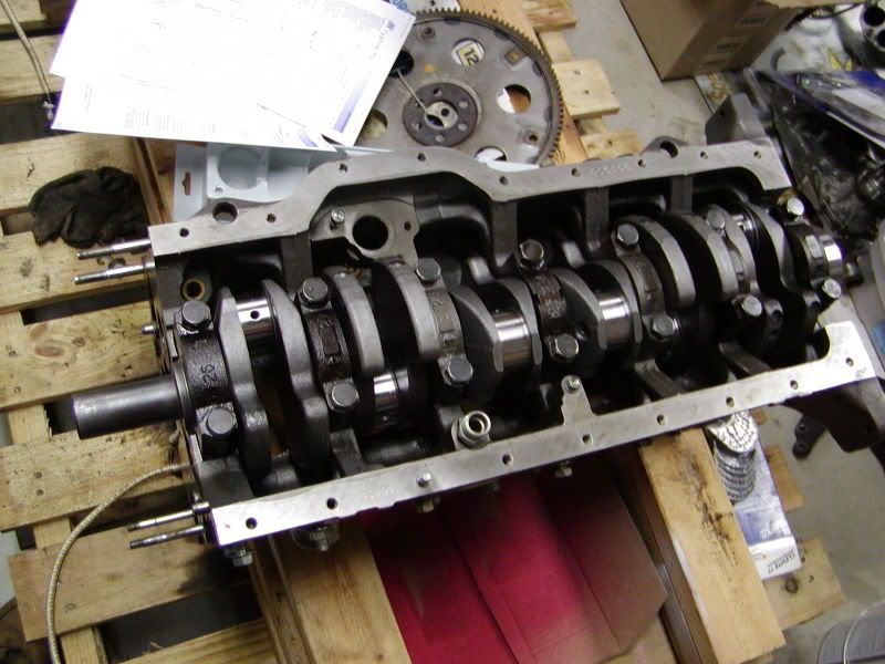

OH and got that 7m crank in...One of the counterweights just BARELY touched the oil drive gear slot thing....haha...my lingo is SO technical...but i just rubbed a file on it just once not hard and took care of that...:]

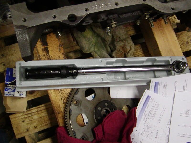

Tools and stuff...
Torque wrench

Are you using bolts or studs??
If you look inside your head you'll see circular inlets where the bolts go through. Make sure you put the head on the block using only the guiding pins. Then drop the washers in, then the bolts or studs. You will probably have to rotat your cams on a few of them. My #10 always wanted to grab and keep my socket.

I'm using head bolts and whenever i had the block resurfaced i guess they had to take of the guiding pins.....so i don't have them anymore.....so what we are going to do it take the old head bolts and cut the top hex part off(basically just a straight bolt with threads on it....) and screw 2 or 3 in...BASICALLY the same thing as guiding pins.......i used to do it on Chevy blocks all the time...:]...

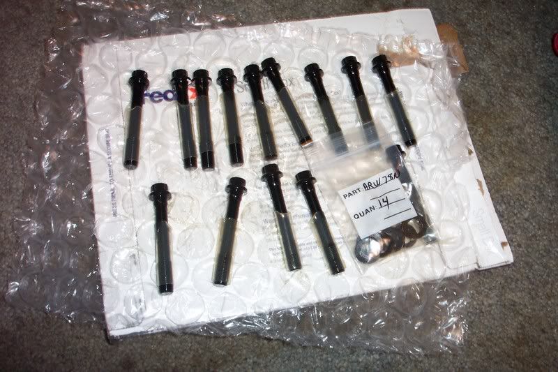

Sorry bout the lack of pics and updating...my mom took my camera on her trip and now she's back...PLUS I'VE BEEN WORKING MY ASS OFF!!!!!.....But hey thats money for the car...haha......But anyways I got my head gasket in...Pic soon...and I JUST got my arp head bolts!...Now I'm bout to run to dealership to see if they got my dowel pins...then I'm set...!...whoot..
Head bolts and washers
