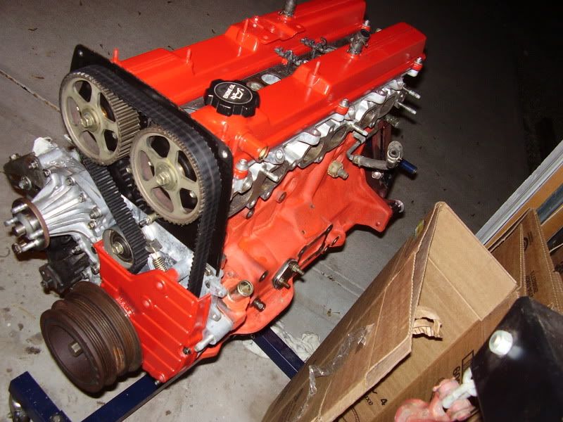

87nasupra;1552490 said:Only reason I asked about your pistons is, you never mentioned boring or honing when you got the block machined....Only assumed. I wish I could have used my old pistons on my stock rebuild, lol. Looking good, keep it up

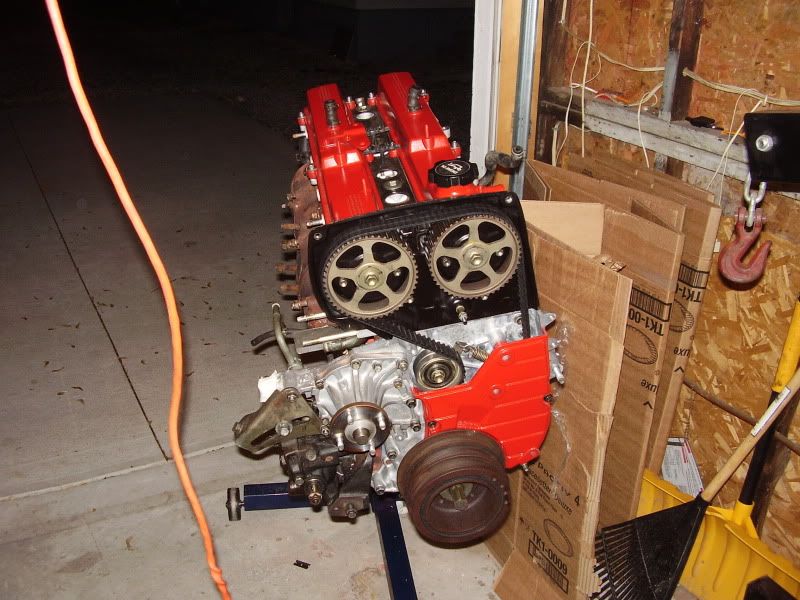

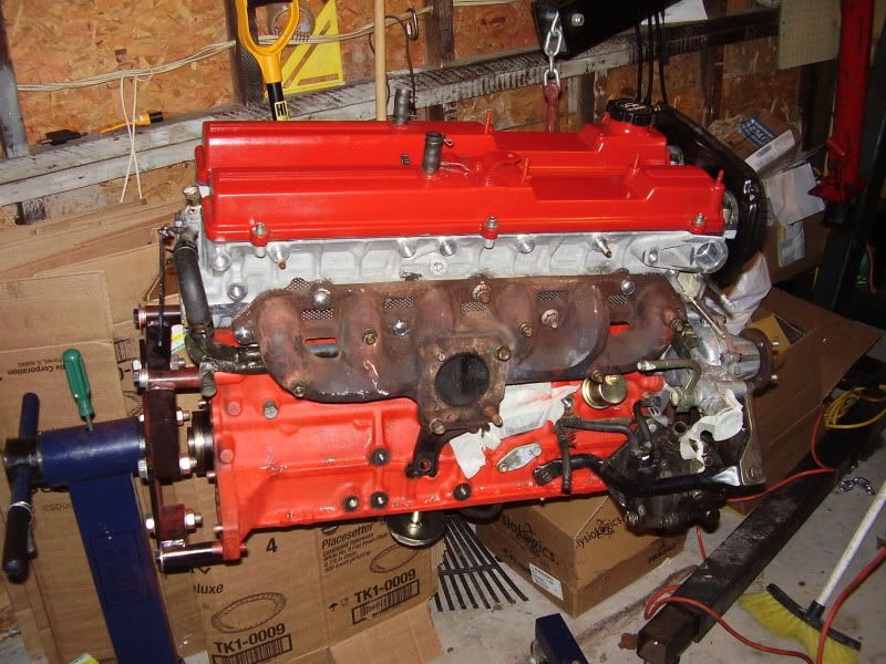

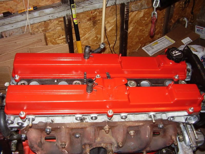

Kevin;1554401 said:ok so i went out and bought a 3/8 drive 14mm deep socket and it worked!! except with ONE bolt, it was really tight sqeeze to get it in there and i had to use pliers to pull the socket out.. soo ya head is now torqued down to 85ft-lbs. everything should noe be smooth sailing from here
i plan on finishing this and dropping her in withing a couple weeks. next week are my exams so i wouldnt have time..
TweeT91109;1565156 said:Im having a problem like this....the arp's that are on my motor, I cant get them off...none of my sockets will fit. So i'm thinking about going out and trying to find on of the sockets u used here....hoping for the best![]()
IJ.;1565083 said:Looking spiffy I hope you're putting a timing cover back on![]()
Kevin;1565167 said:u got studs or bolts? dont forget they are different size haha.
The bolts that are on the studs lol.....in between the valves...I cant get a socket down in there
