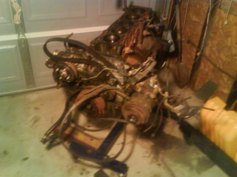

heres pics of the engine
I'll have it on the stand tomorrow when i get bolts (u probably saw my other thread about the bolts lol)

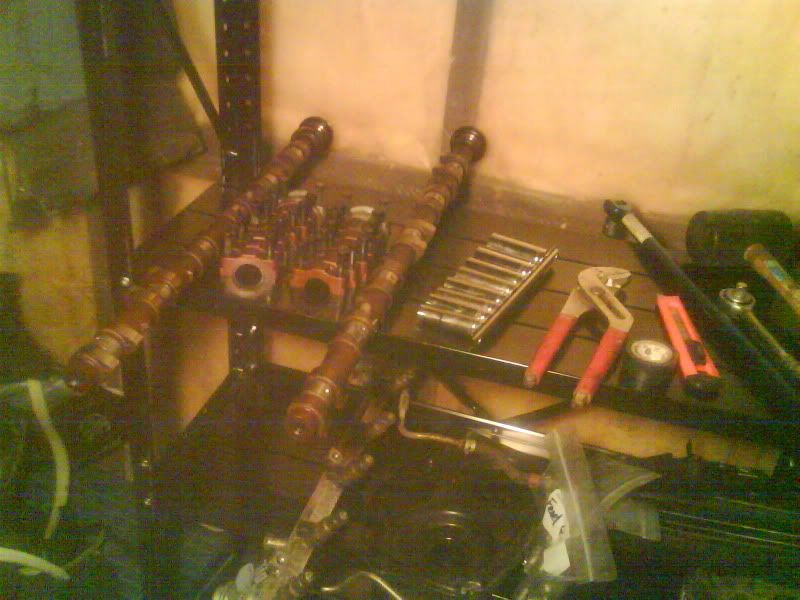

I got the head off today and a few other mics items :) i'm pretty amazed at how easy it is to work on an engine outside of the car. this is my first.

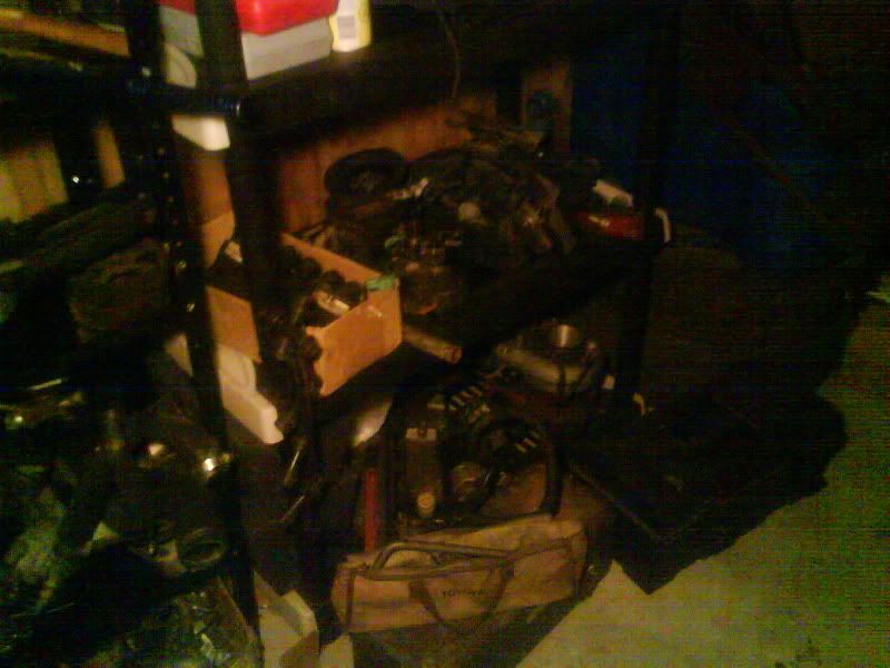

i also made sure i had plenty of ziplock bags and marked each one for bolts and random stuff this time. (last time i didnt.. lol it was a nightmare)

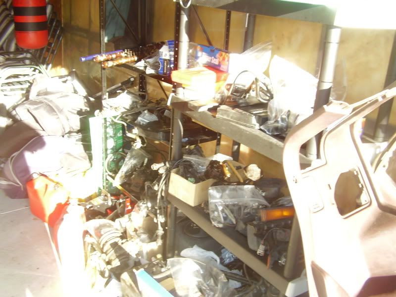

i am suprised at how fast i got everything done, being prepared.. unlike my last hg which.. i was totally un prepared.. unfamiliar..and took forever.. and i fucked up alot lol... i even bought another shelf unit so i can put more parts in an organized mannar... i think it took me longer to put the shelf together than to strip the head and remove it lol here are some random pics
it feels good to be organized for once.. ( i am not an organized person at all... i'll take a pic of my tool box tomorrow to show u guys lol)

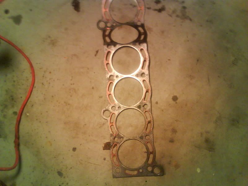

the head gasket actually doesnt look soo bad.. compared to my last hg.. (i'll try to dig up a pic)
ohwell.. gonna go mhg anyway.

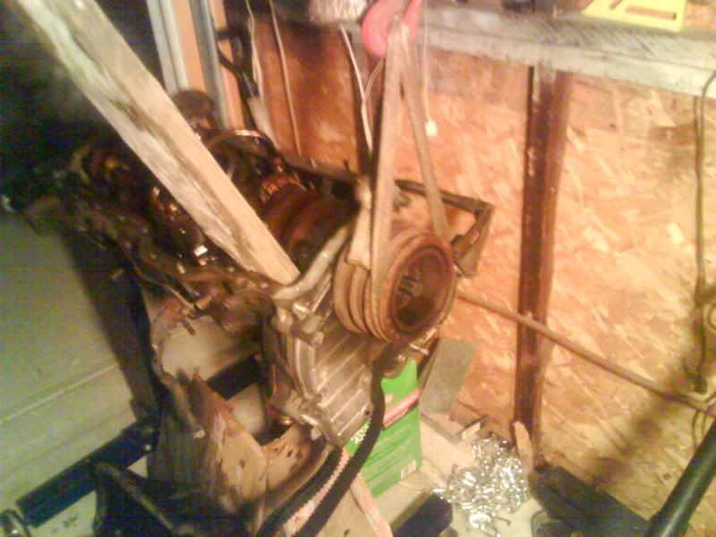

hmmm.. now i need to get the crank bolt off somehow..\anyone have any suggestions on how to do this.. when the engine is on the stand.. ?
Moy
It's broken...
Aug 6, 2008
2,432
Beach Park, IL
buy a tool, it's like 60 bucks if you get it on Amazon: Schley 64300
I used that along with two breaker bars to break the bolt free. Works great :D

Kevin;1508135 said:
how did you use two breaker bars at once? lol
just pull the oilpan off and jam a 2x4 between the crank counter balance and the inside block wall....then use a pipe over a wrench to break the bolt loose...real easy stuff.

update. oilpan off. powersteering, waterpump, a/c and a few other misc things off.
now i have to tackle the crank bolt ... :(
gonna save it for this sometime week. sprayed some liquid wrench on and around the bolt last night and tonight. gonna repeat so to make sure it soaks in lol
Kevin
7mgte -> 7mgte swap done.
Apr 20, 2009
865
Windsor Ontario Canada

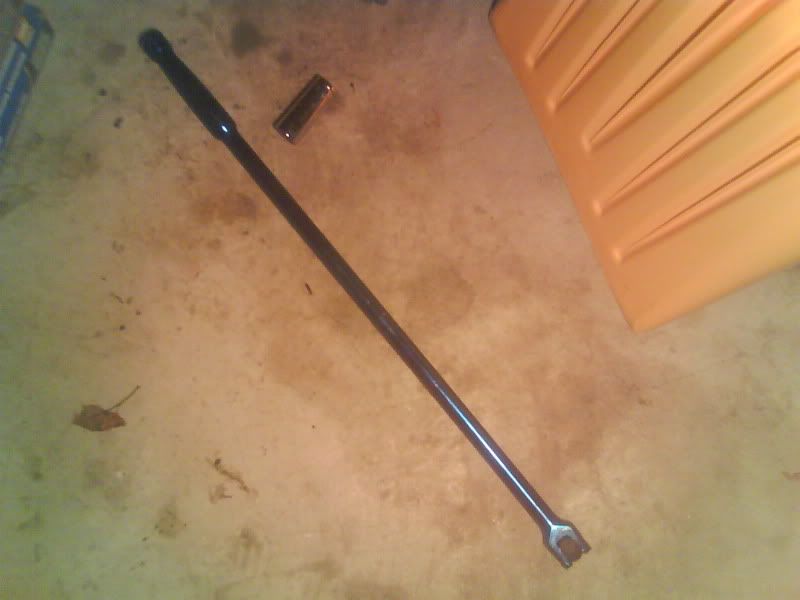

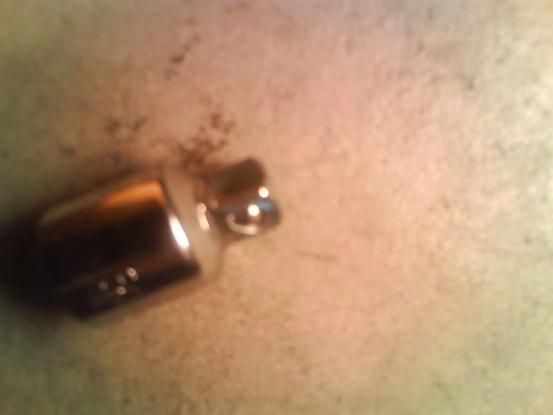

tried the 2x4 and breaker bar method.. and failed lol.
i couldn't find my 1/2" drive 19mm soo i had to use a 1/2" ro 3/8" adapter with my 3/8" 19mm deep socket.. im an idiot lol
anyway. i ended up twisting the adapter
yay!
anyway.. after a little bit of swearing. i called up a friend and borrowed his impact gun and 19mm socket. took a little bit but finally got the bolt off!!

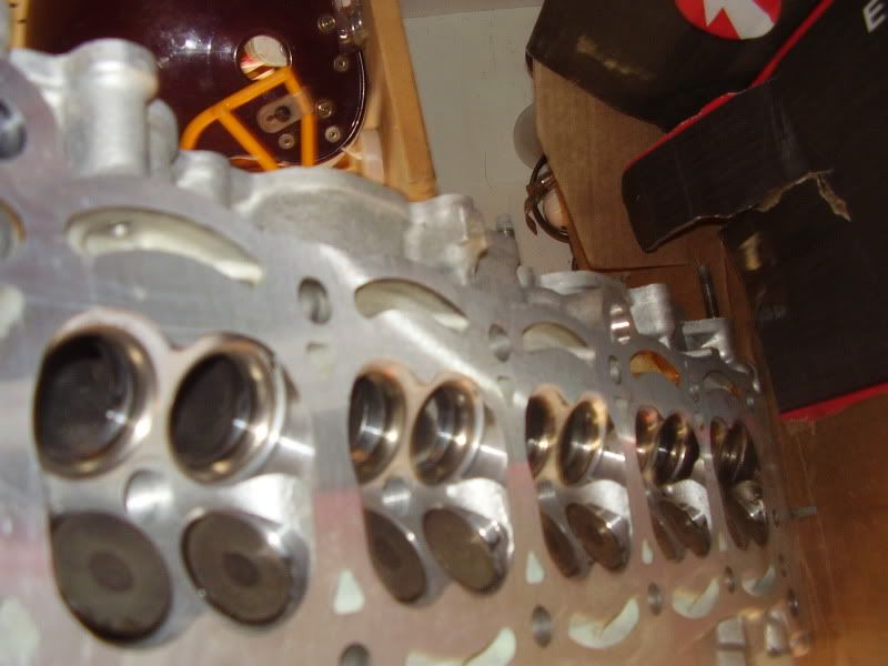

update: so.. just trying to tie up loose ends.. started putting the valves back in the head.. WTF!!!! took me 45 mins for 2 VALVES!!!!!!!!! fucken keepers are nearly IMPOSSIBLE!!!!!!!!!!!
is there some kind of secret way to get them in????

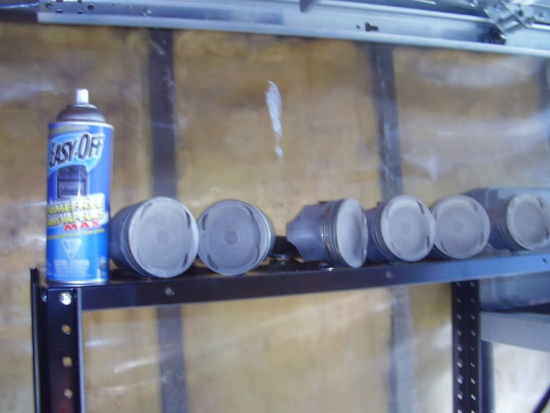

on a side note.. got the pistons cleaned.. oven cleaner works sooo well for removing carbon.... i'll get pics up as soon as i get my hands on a camera

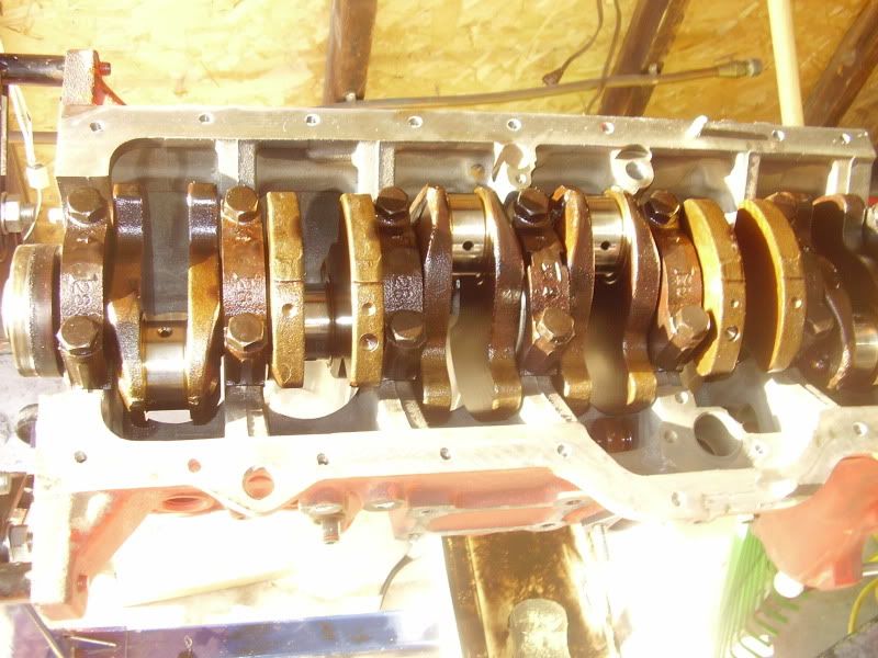

update with some pics!! (finally got a camera lol)
so far i have the crank in with new acl bearings
made sure to use PLENTY of assembly lube.. mmmmm royal purple

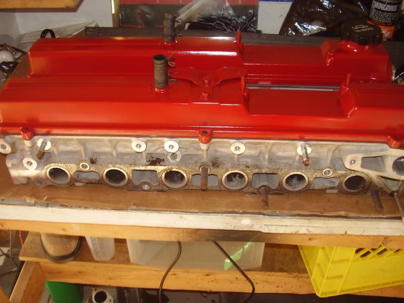

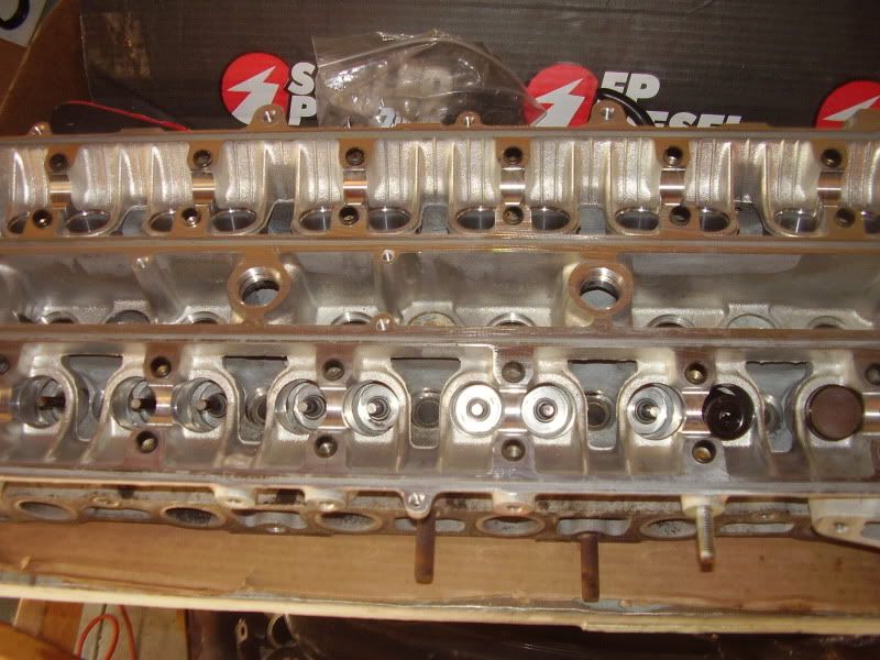

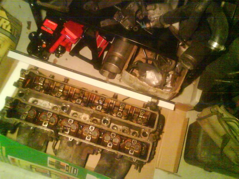

here is how the head looks after machining
as you can see.. i have two valves, cuckets, shims etc.. in
i started on the next... but got too pissed off.. really.. how the hell do you guys do this?!!??

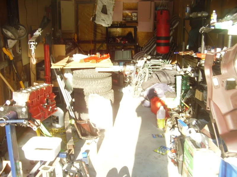

heres the block after machining
i cleaned the pistons :) oven cleaner works the best!

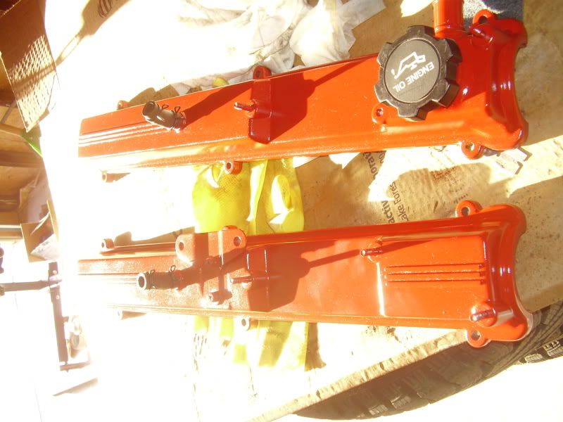

painted valve covers :)
orgaization ftw
how my car sits now.. (such a nice day out. 17 degrees C!!)

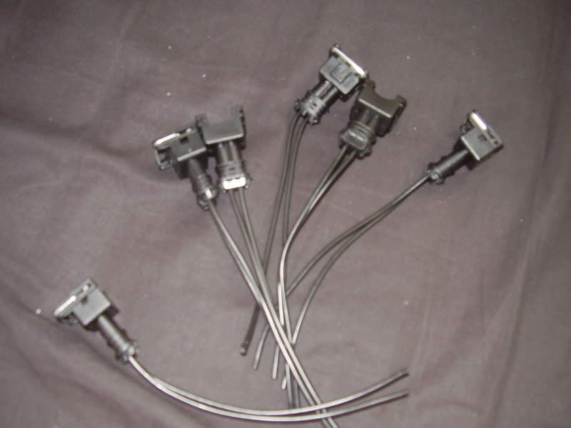

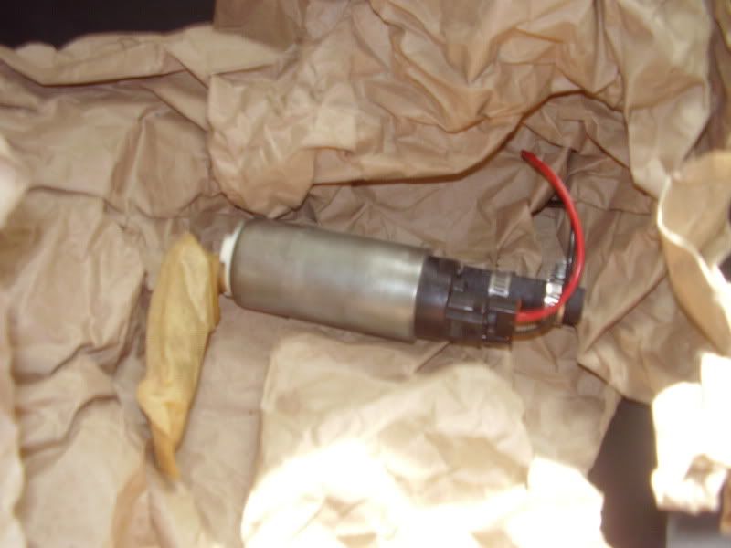

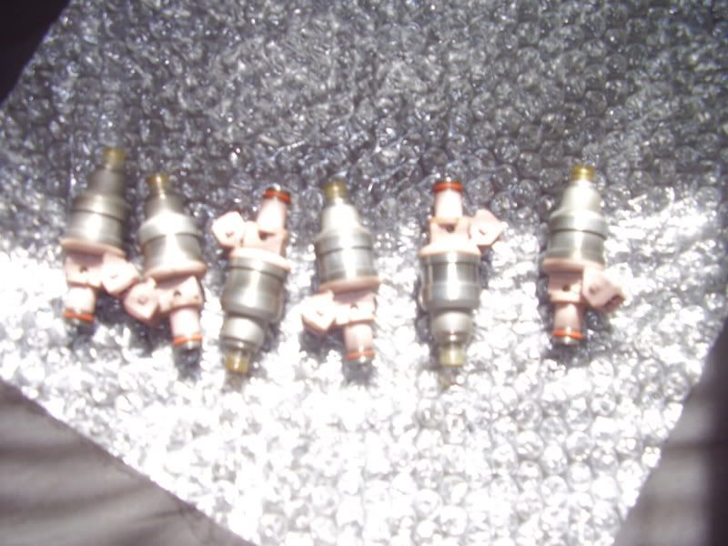

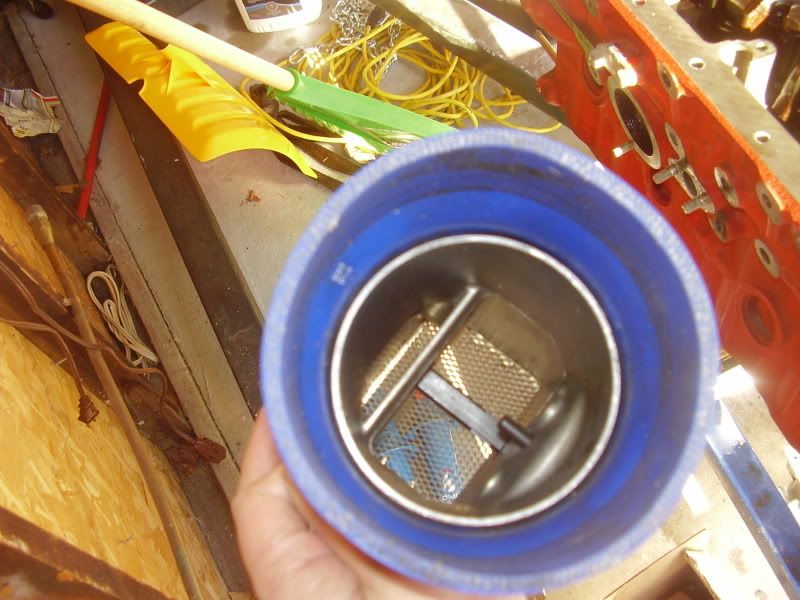

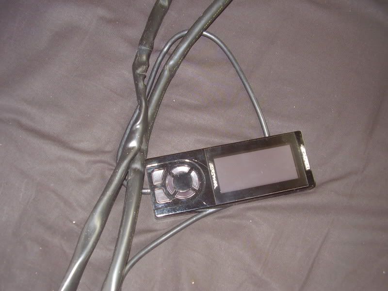

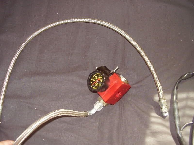

some more stuff going into the car soon
255 walbro
apfr
apexi afc neo

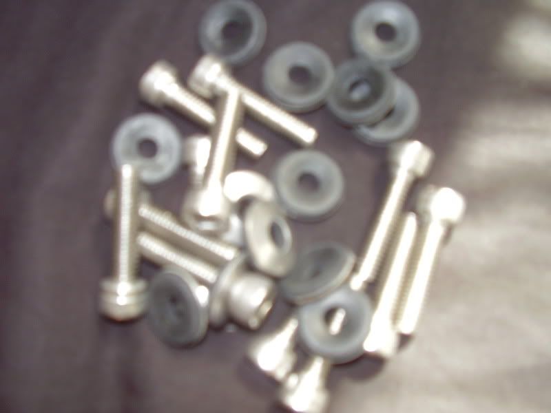

valve cover bolts
boost controller and turbo timer
560cc injectors
new injector clips
lexus afm
more to come :)
