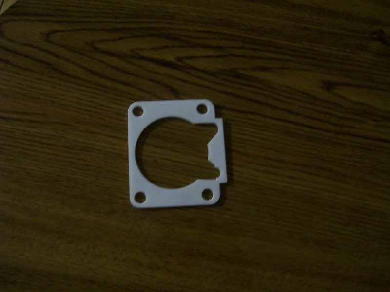

and btw can we say laser cut teflon tb gasket?
