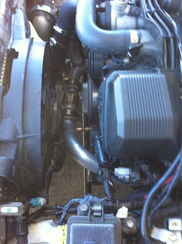

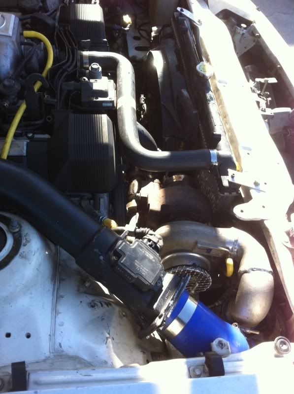

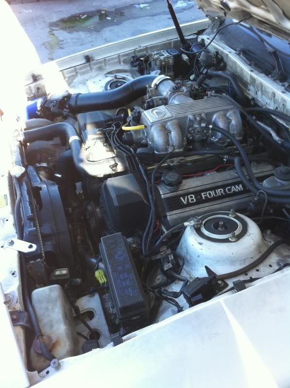

I have a few pics I sent to redphoenix so he could see my setup, if Brandon doesn't mind I could post it up to his thread. Just remember, I was doing this for as cheap as possible, and wasn't aiming for a lot of power.

Dang let me know about those! I'll post pics up tomorrow morning. Lol just don't laugh

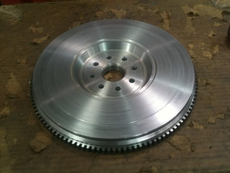

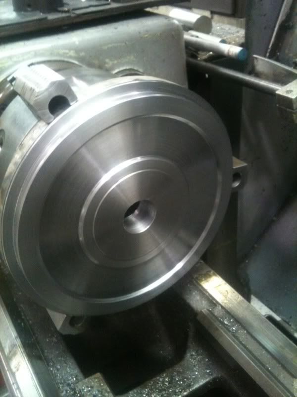

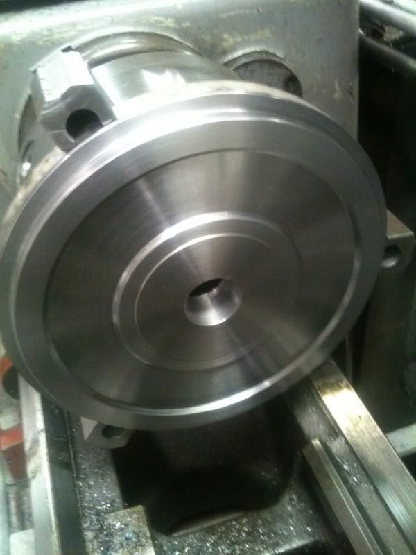

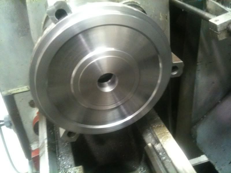

I had some time this weekend soooooooo.
I present to you my billet steel flywheel.
and yes, it's not quite finished, but I think you get the idea
click the pic. it's a video
clic the pic. it's a video.
BTW, the car is finished, and will be attending toyotafest this year! Wohoo. I'll post an update later this month. With pics and vids of the 1uz car in action.
