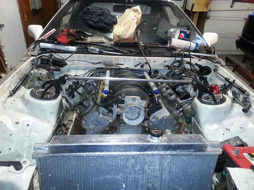

Got a lot done today:

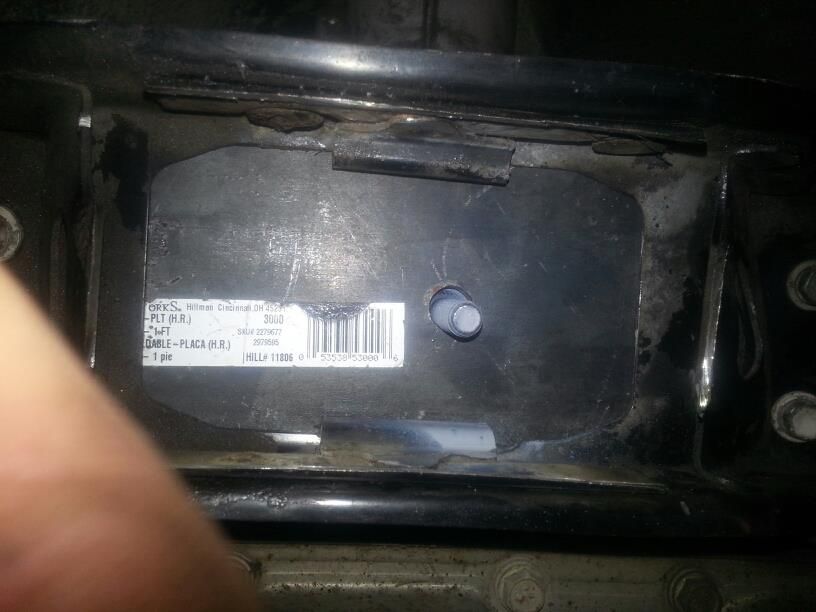

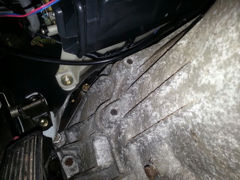

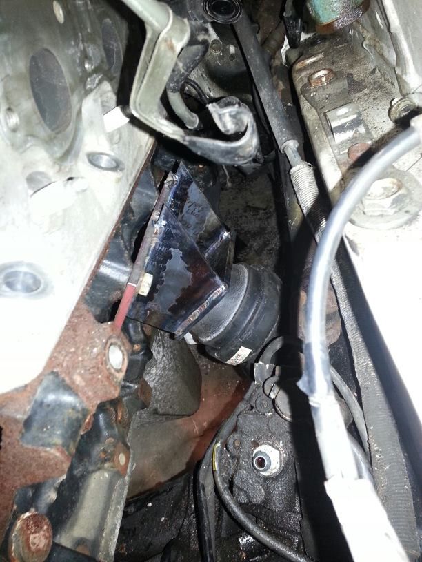

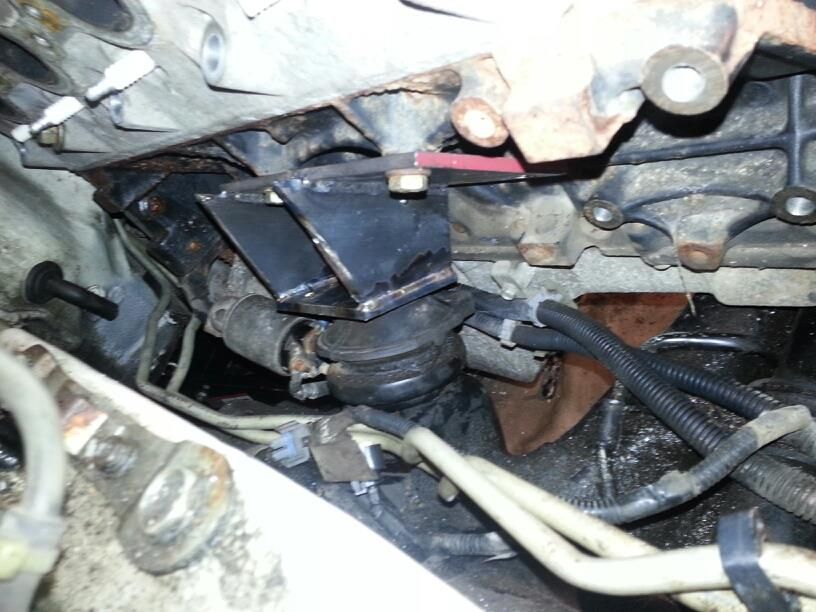

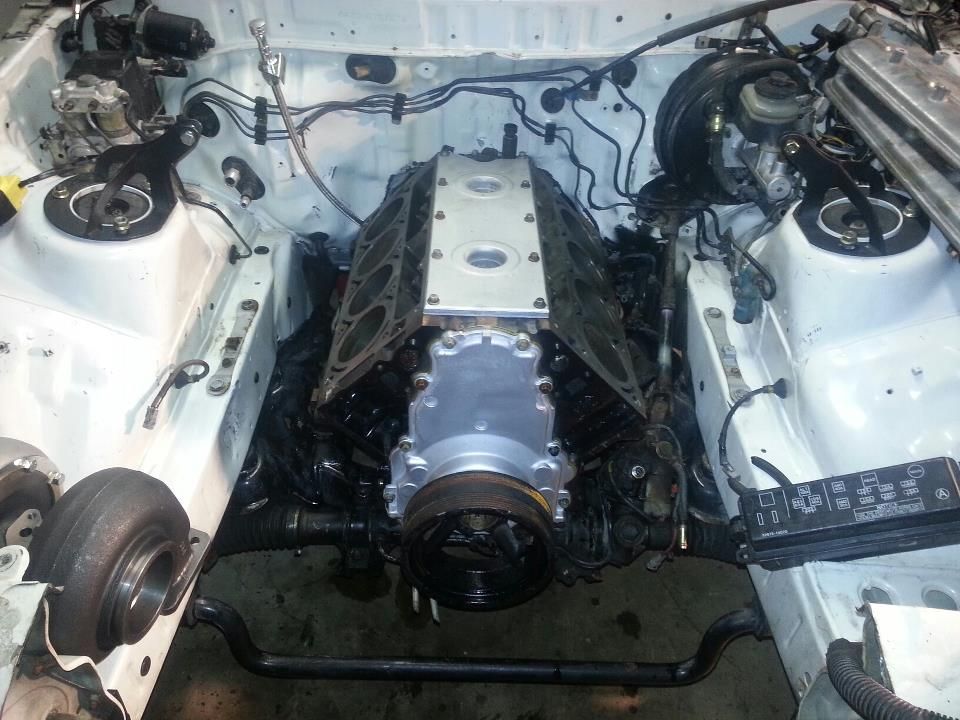

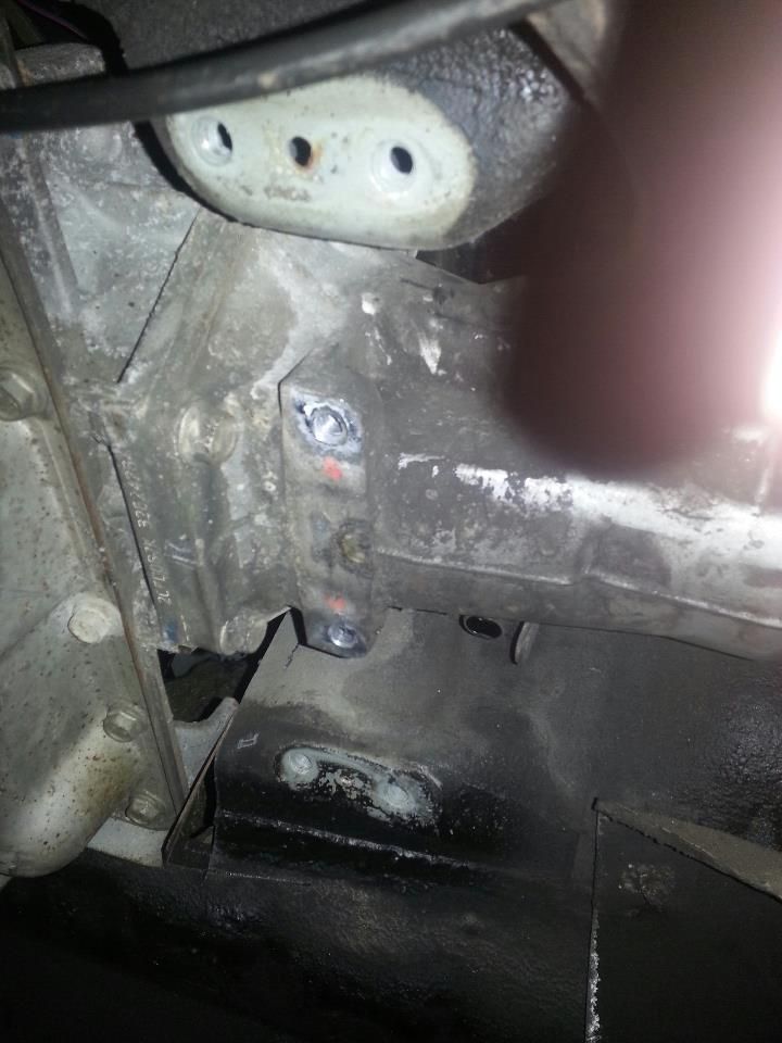

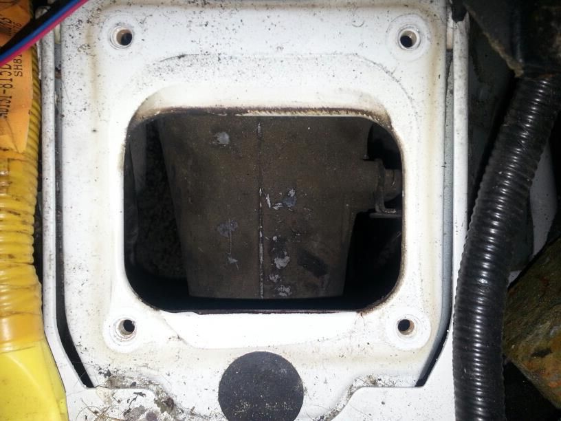

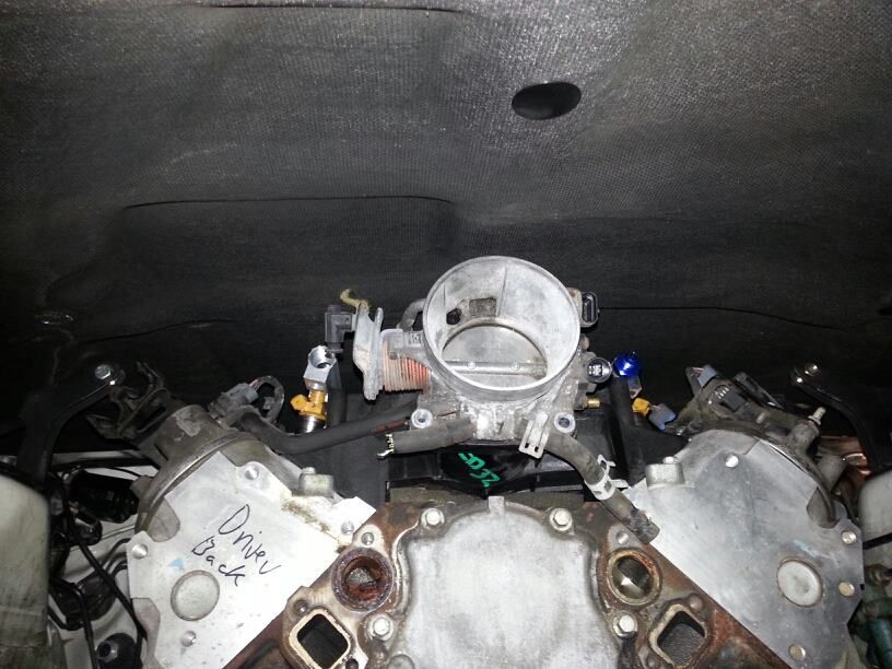

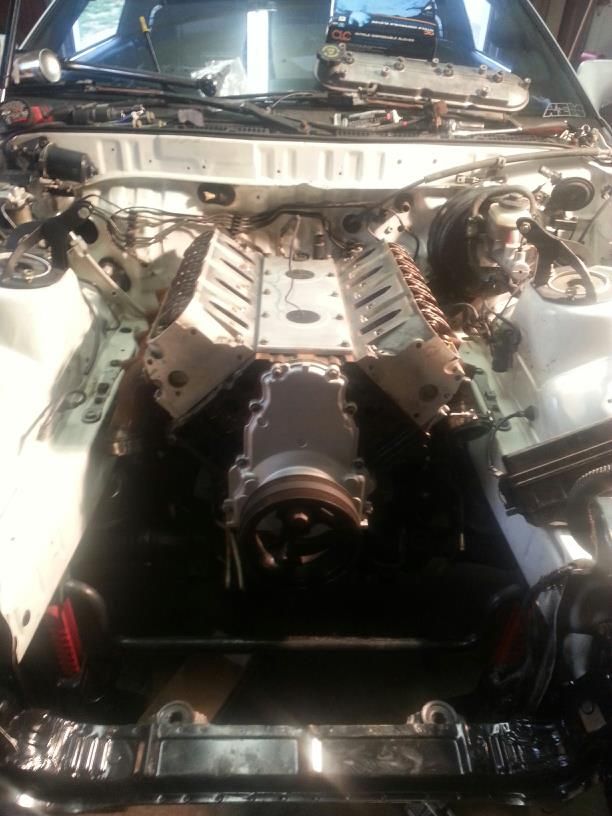

Got the motor mounted with trans

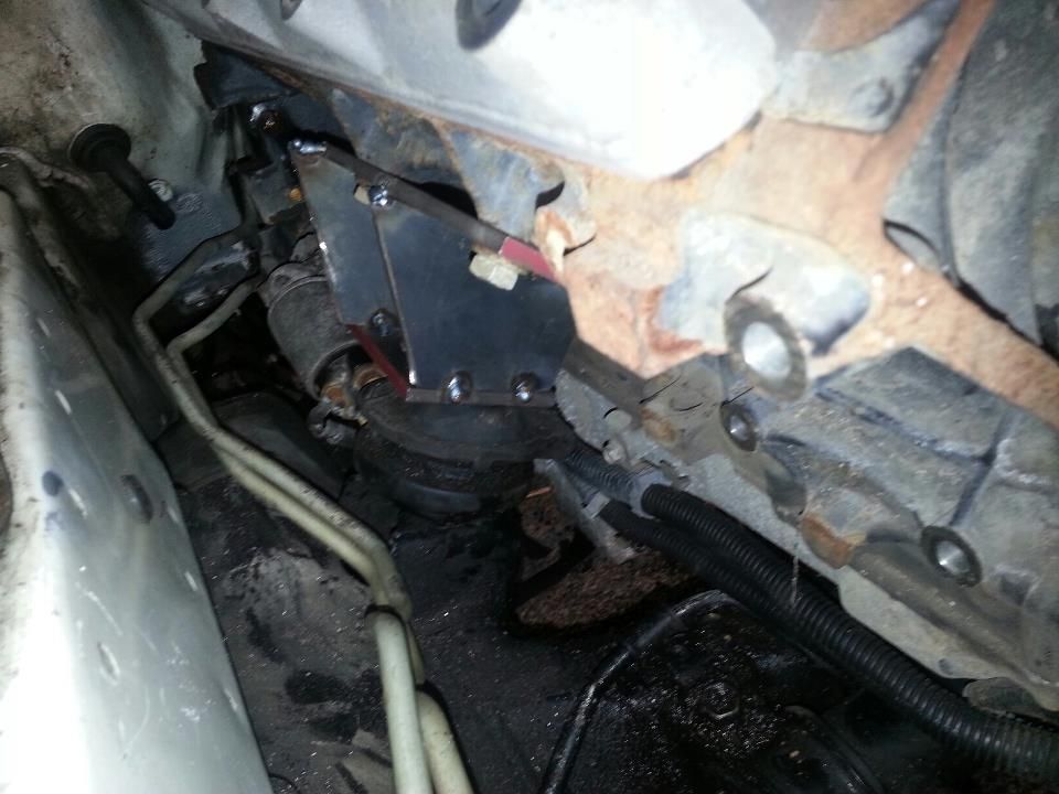

Built motor mounts

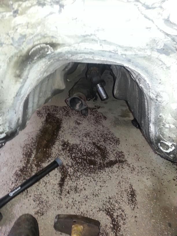

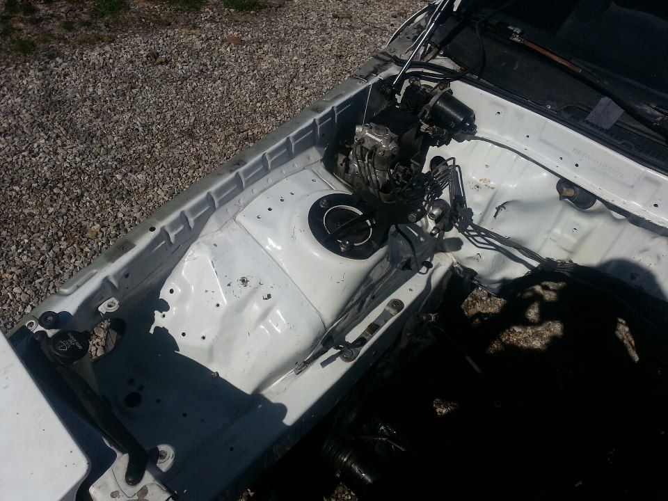

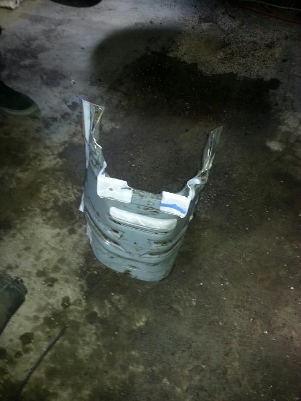

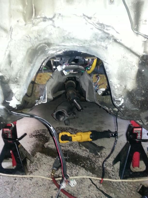

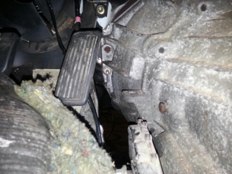

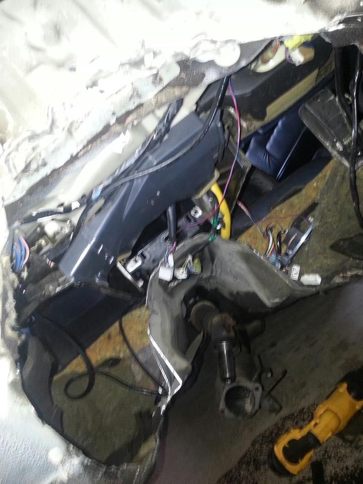

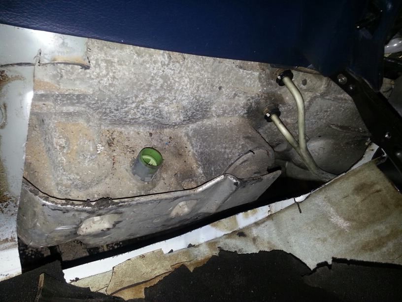

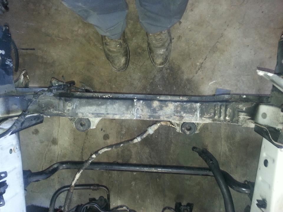

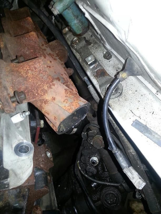

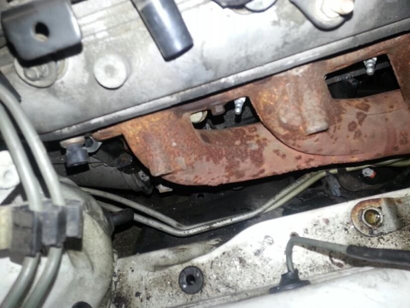

At first I tried pounding the trans tunnel in. But there is physically no way the 4l60 was going to fit. So i was forced to cut trans tunnel out from the firewall right infront of the trans mount. After doing this i was able to place the motor back far enough to make me happy.

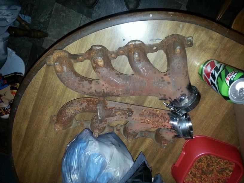

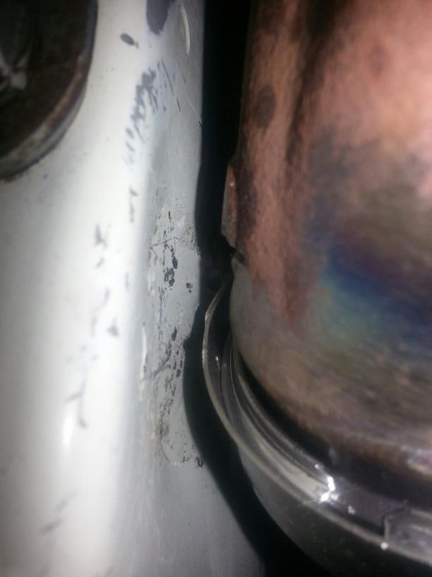

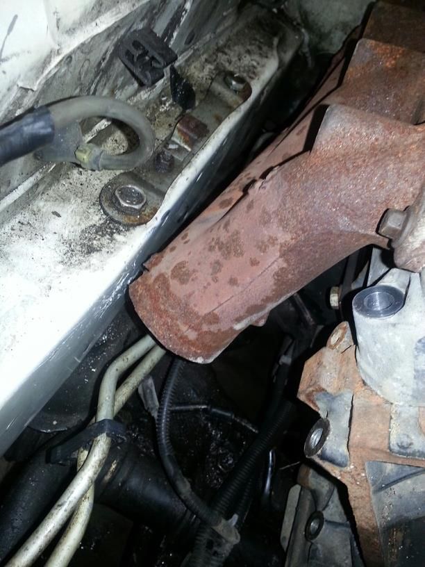

Unfortunately my idea of flipping the exhaust manifolds forward arent going to work. Theyre hitting the frame rails. So i just ordered some 2.5" vbands. Going to angle them
Now for pics. Enjoy.
Next saturday i will have manifolds done, mounts finished completely
I was able to move engine/trans back far enough to where i can use factory a340 trans crossmember with little modification

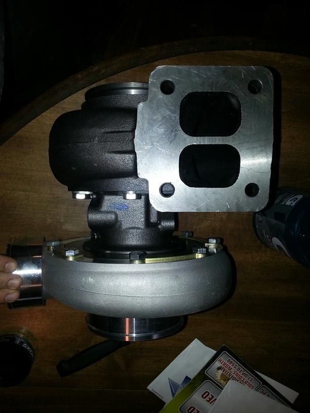

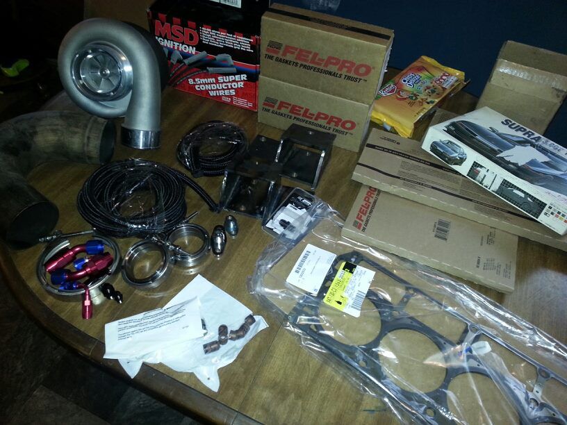

Got some parts in today:

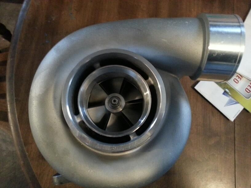

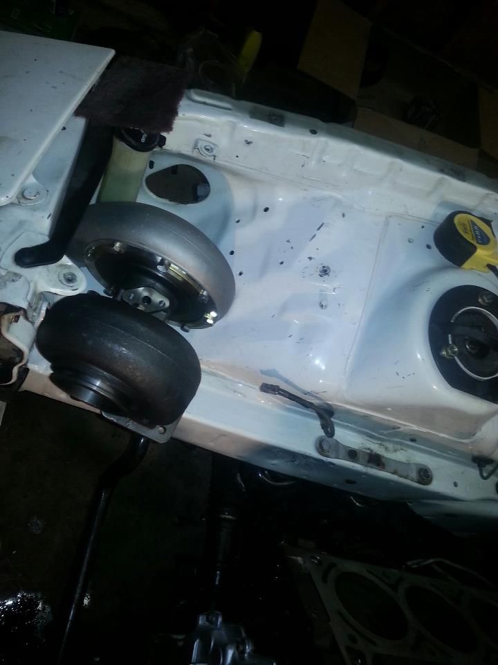

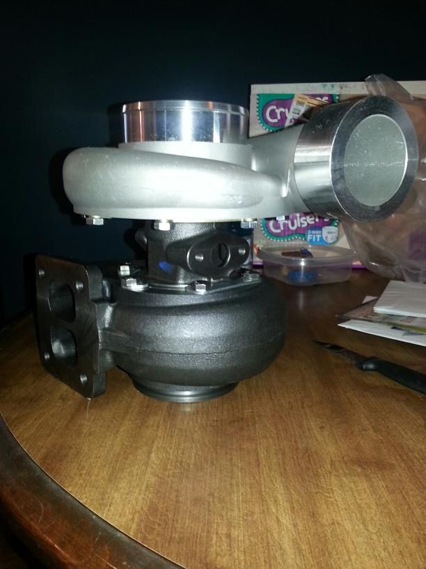

ebay gt45
walbro 400
aeromotive a1000
gm 3 bar map
mk3 supra turbo A model car from japan :)
some misc fittings
For being a ebay turbo its actually not to bad. Have heard good stories about these. A lot of people have 0 problems with them

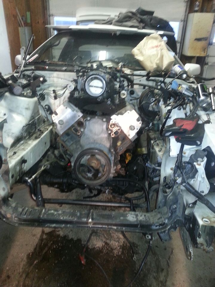

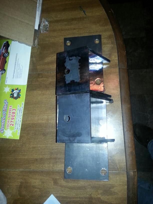

Got a bunch of things done and recieved in the mail:

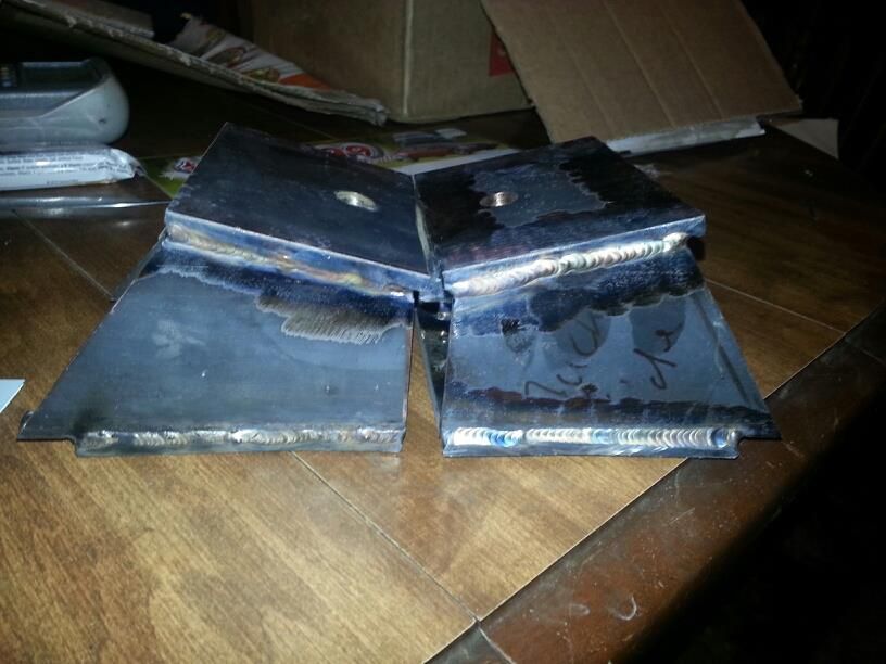

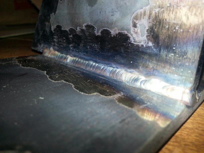

welded up both motor mounts
cut factory drive shaft to be welded to s10 shaft
ordered z06 cam and springs

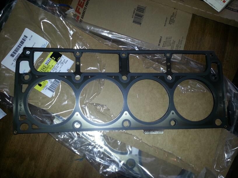

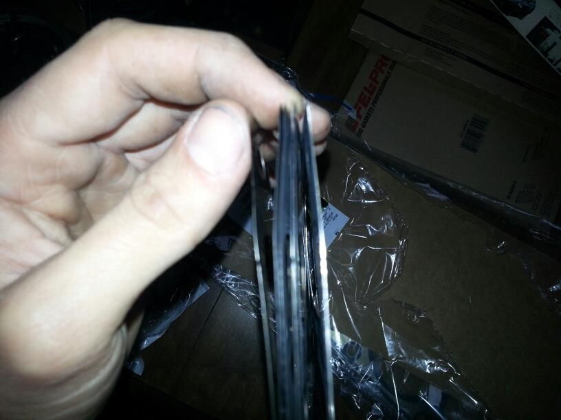

got my 2010 zr1 7 layer headgaskets
all my gaskets needed

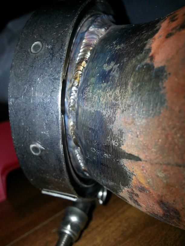

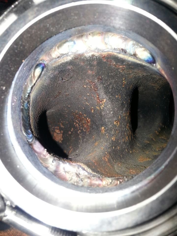

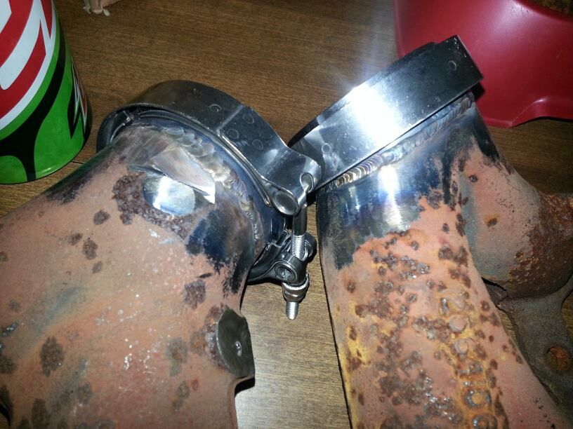

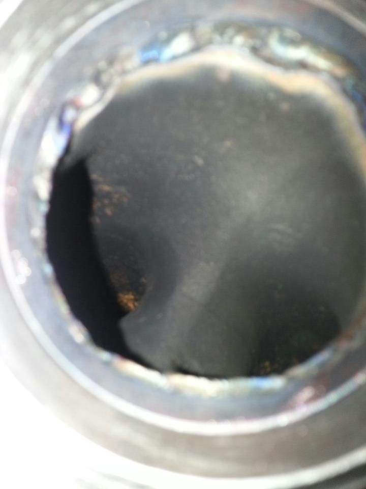

cut exhaust manifolds for v bands

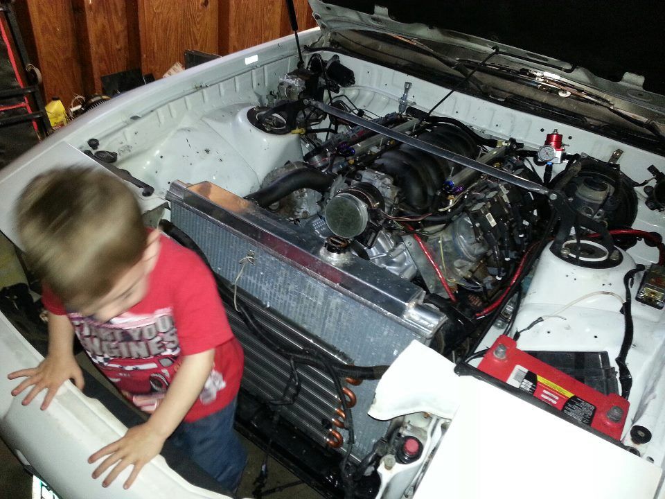

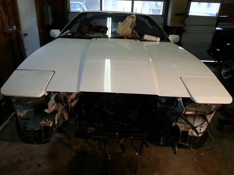

test fit hood....ENGINE CLEARS!!!!!!!!

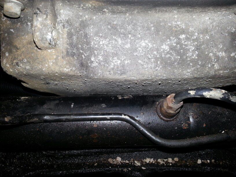

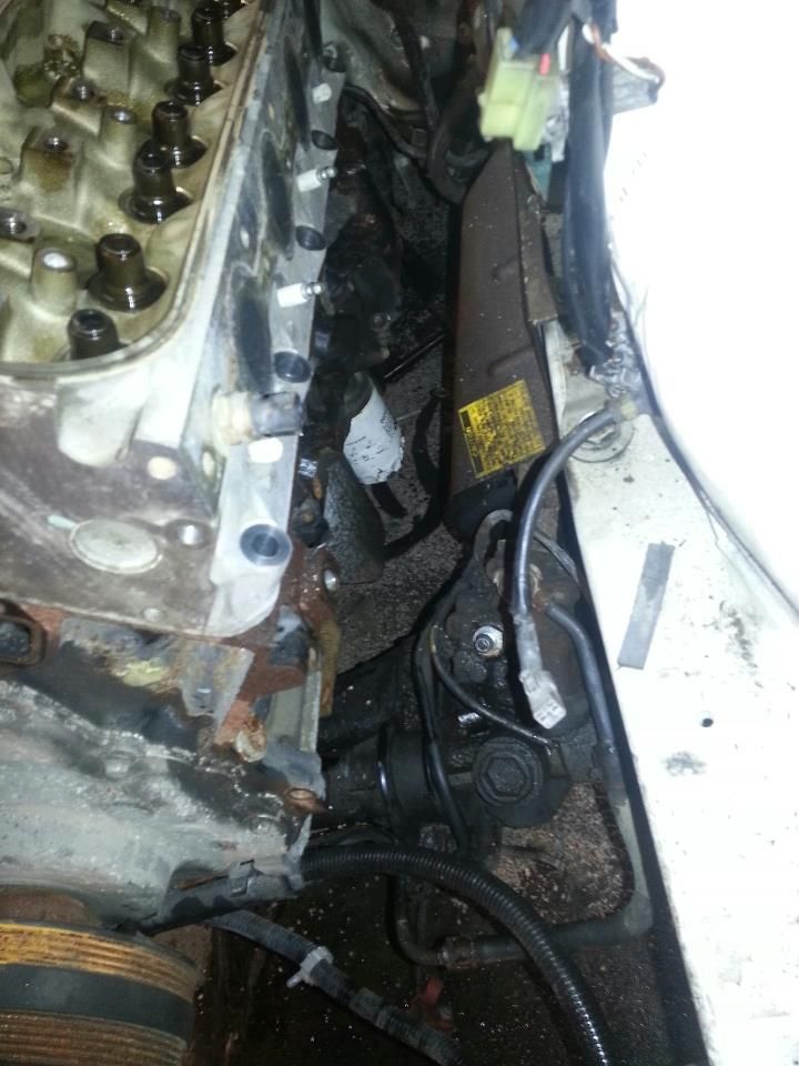

have about 1/2" of clearance between oil pan and rack-n-pinion
Time for pictures...now motor has been removed for the cam and piston ring gapping
Should have more pics on sunday of my engine tear down...hopefully cam and springs show up soon

Your welder does some pretty nice work! Is that gouge supposed to be in the one on the left in the second manifold pic?
jonahs_supra
May 17, 2011
1,015
Lancaster, Ohio, United States

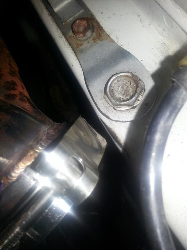

Suppose to be there...No lol
There was a 1/2'' tall nub sticking off that i had to remove due to frame rail clearance's

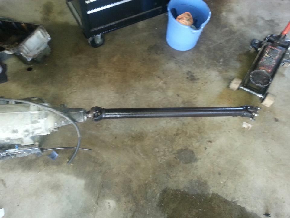

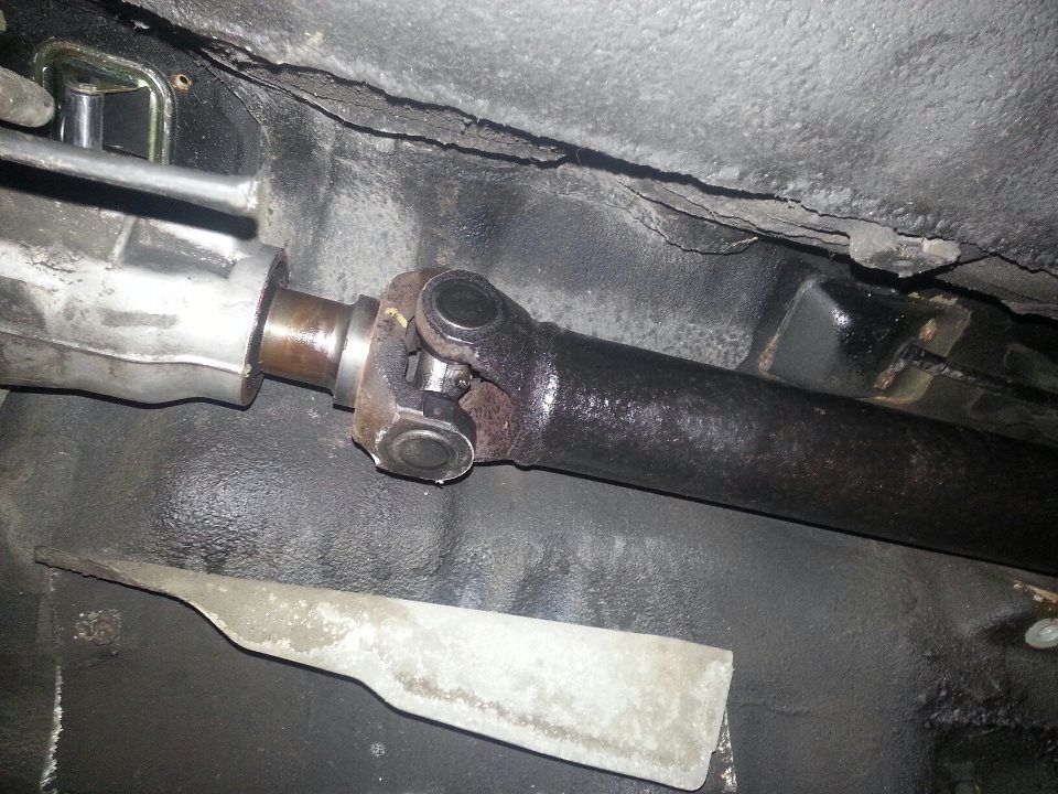

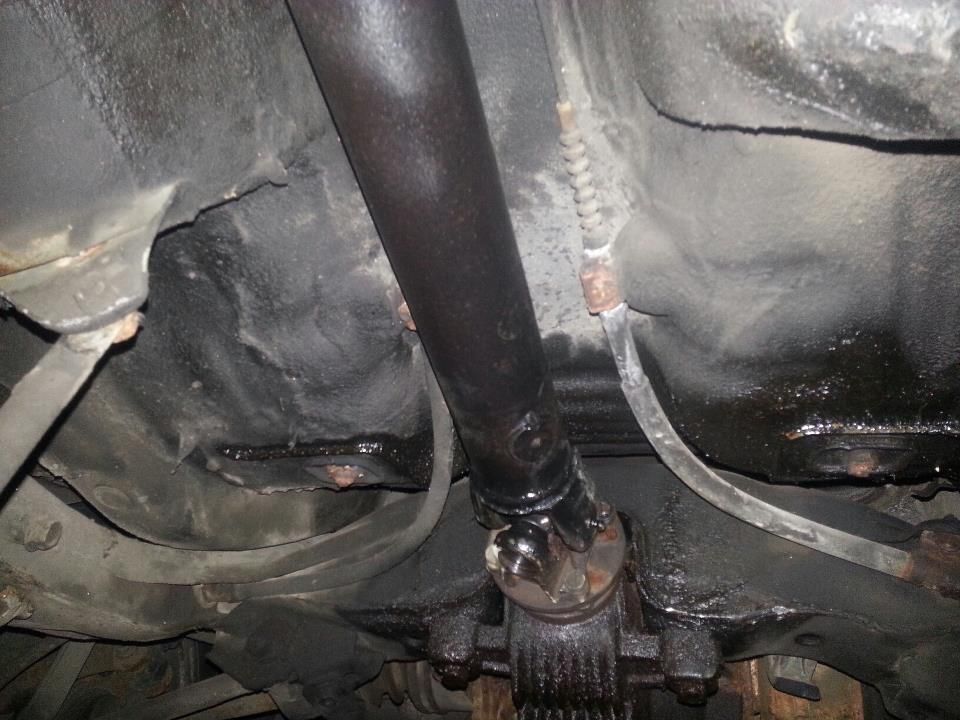

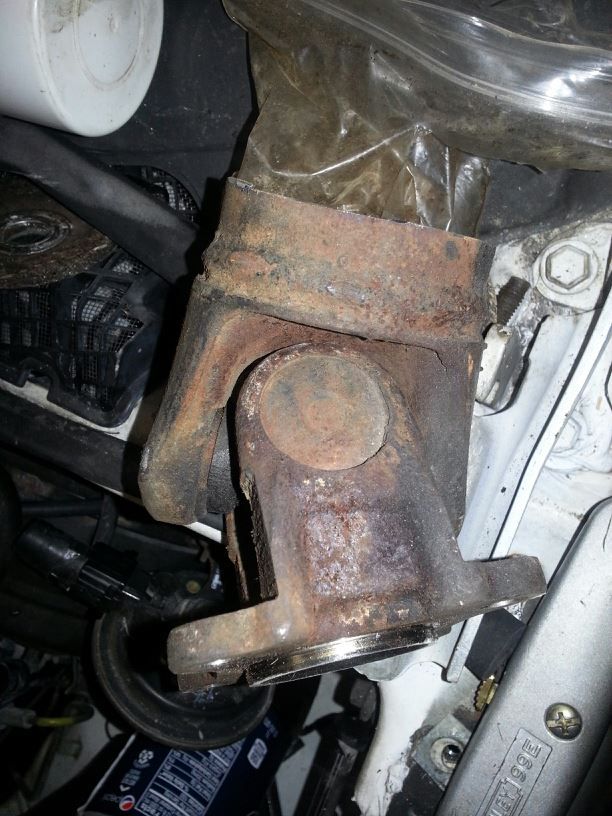

Got my driveshaft today from a 95 firebird
I actually think its the correct length...wouldnt that be so awesome lol

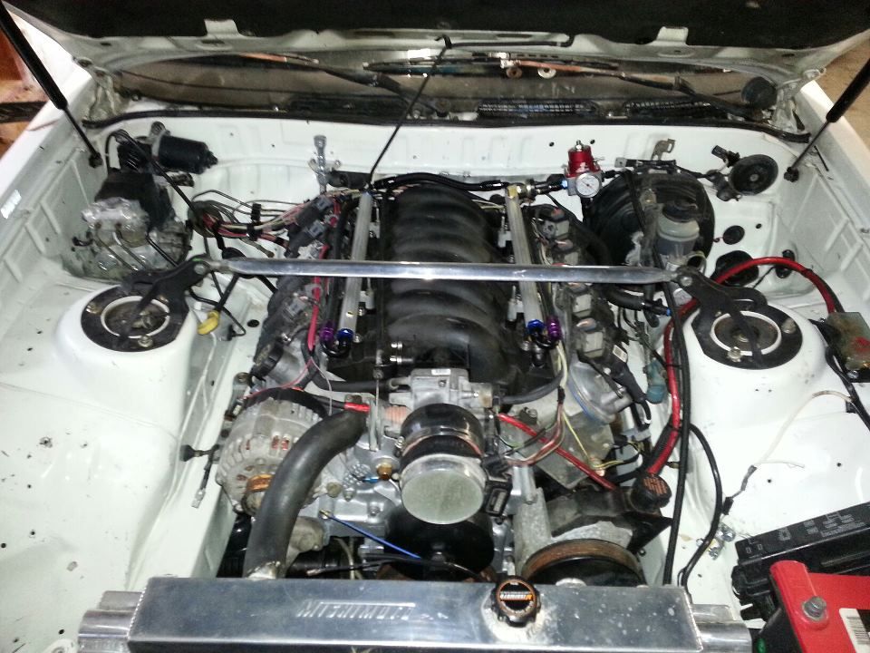

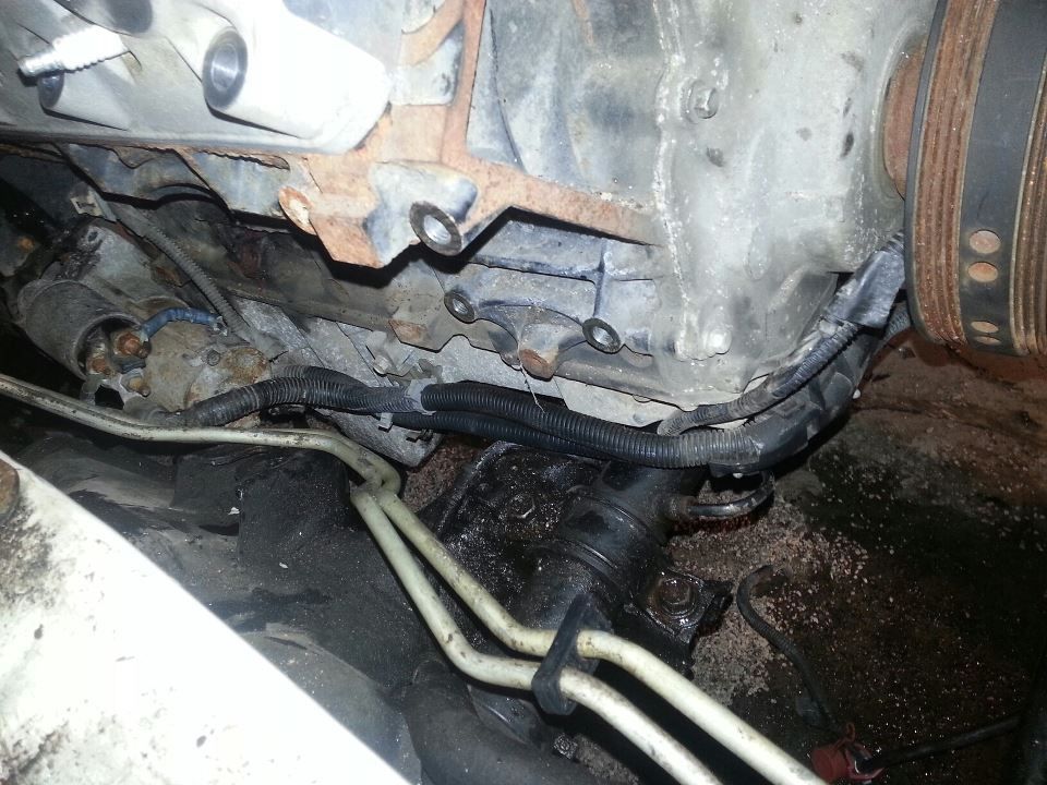

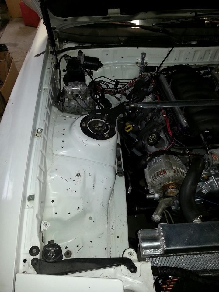

Got some more work done today finally:

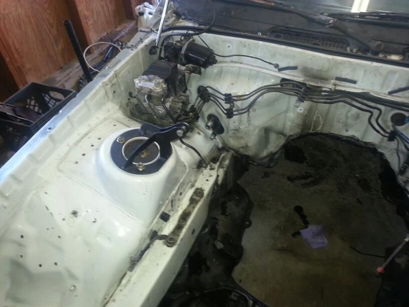

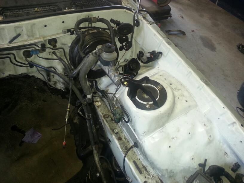

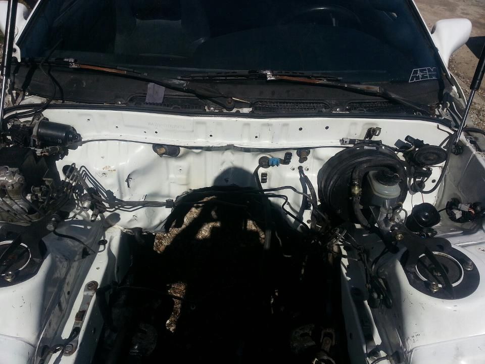

Engine bay cleaned
Piston rings gapped
Motor cleaned/ assembled and painted
Turbo oil drain installed in oil pan
Lokar trans dipstick install
Custom driveshaft installed
Motor installed hopefully for the last time lol

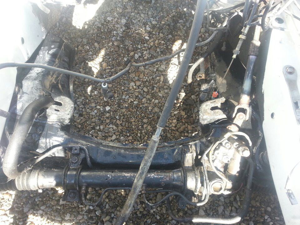

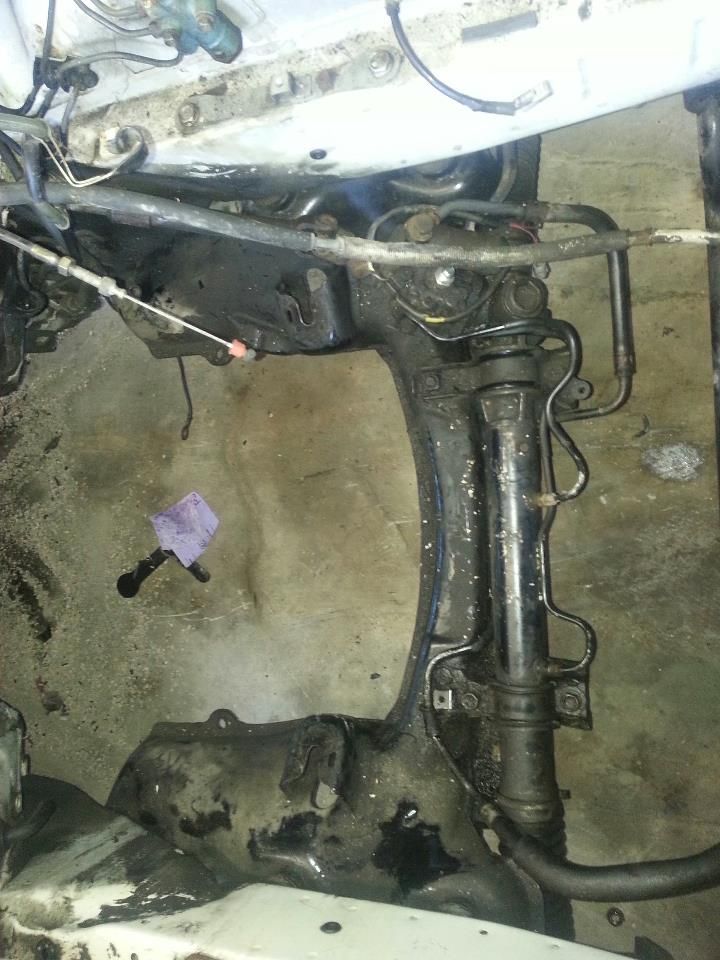

Before cleaning bay:
After cleaning engine bay:

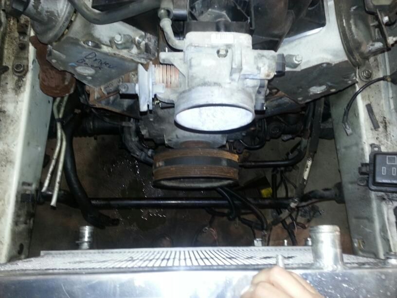

Motor/trans/driveshaft installed:

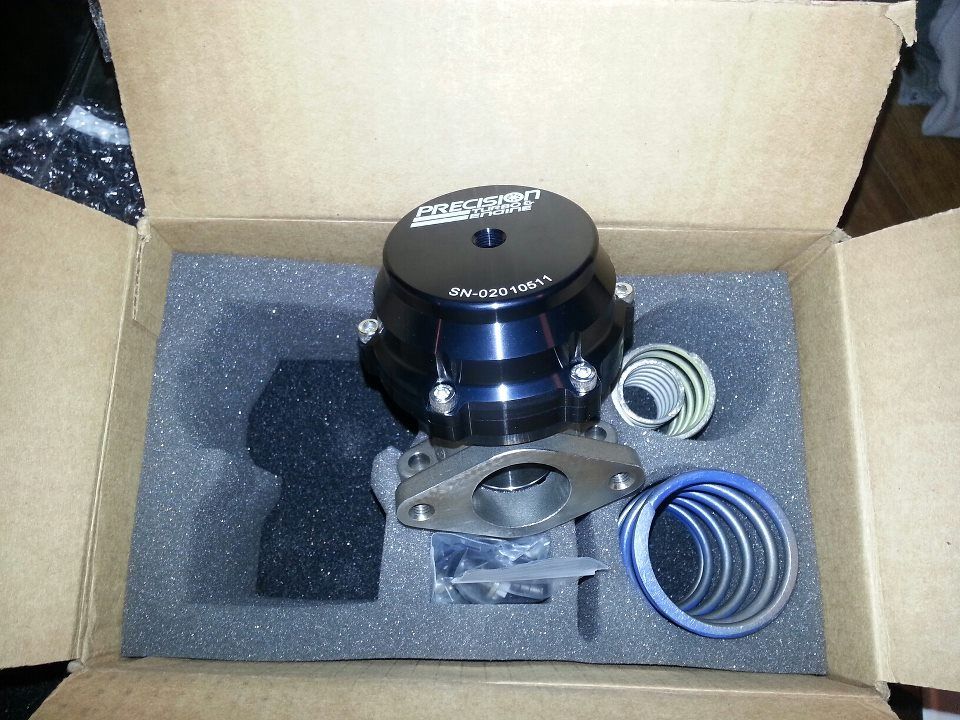

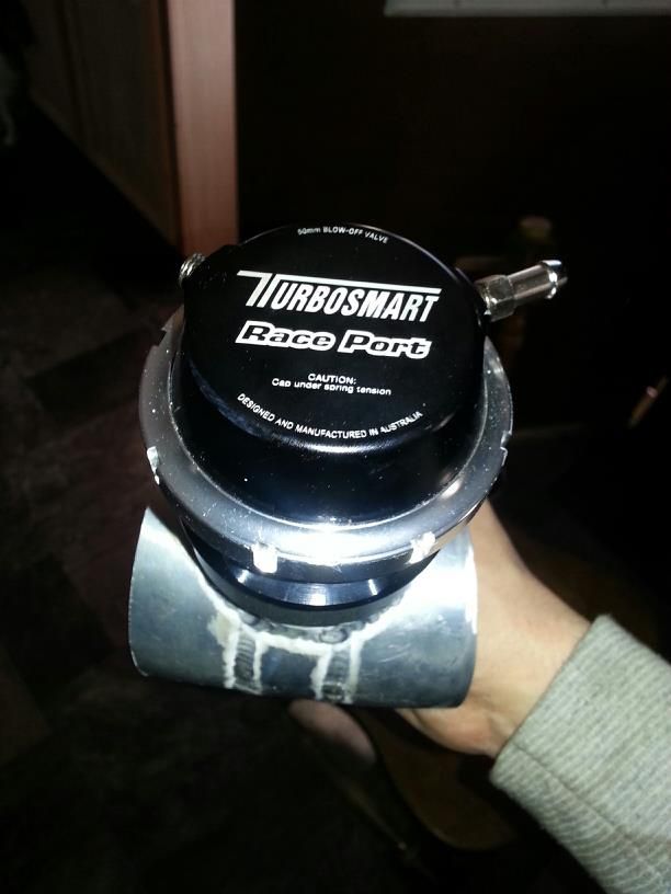

Got my Precision wastegate and Turbosmart race port BOV in the mail
Just waiting on valve springs to arrive then i can slap the heads on

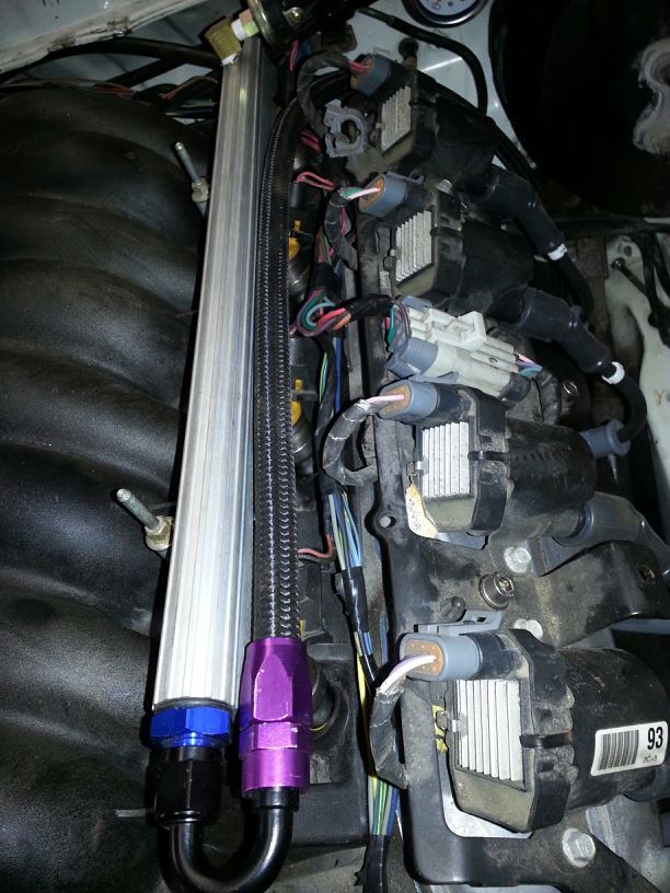

Another update with more pics :)

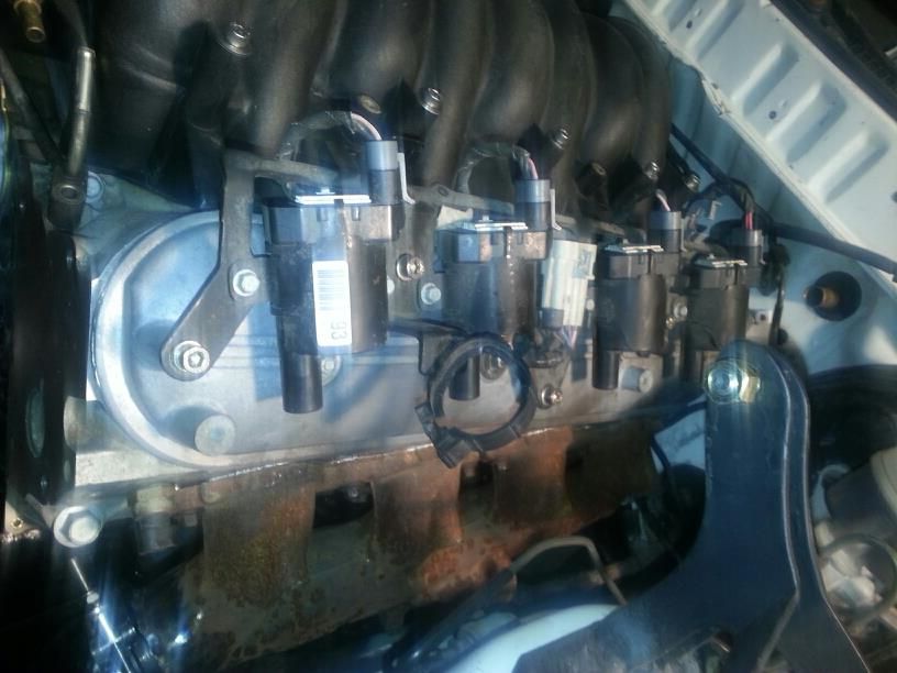

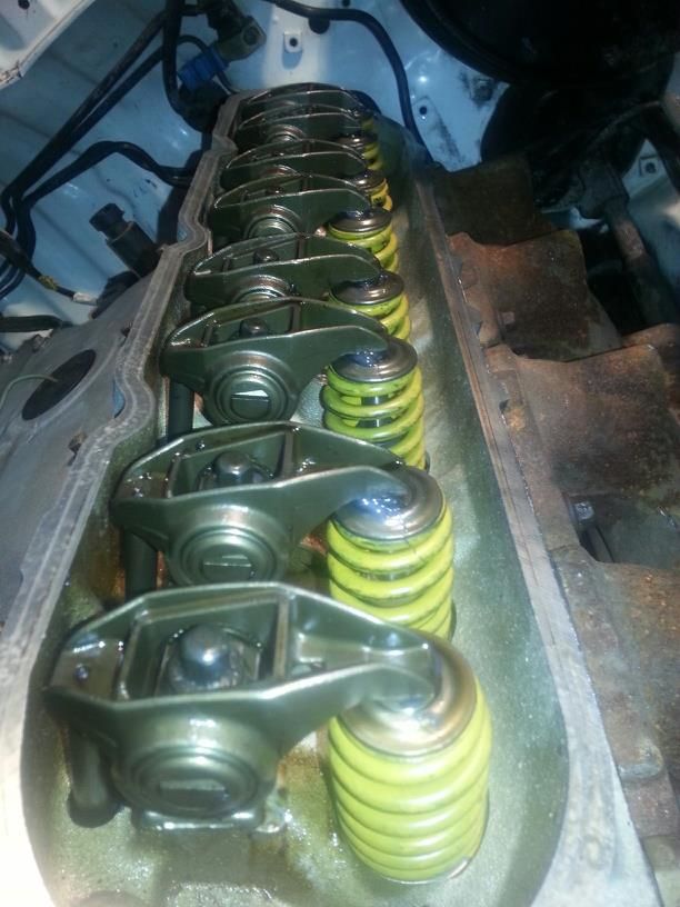

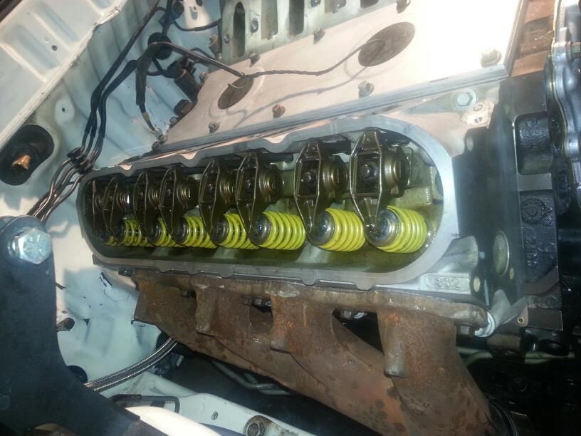

LS6 valve springs installed
Valves hand lapped
LS9 headgaskets and new headbolts installed

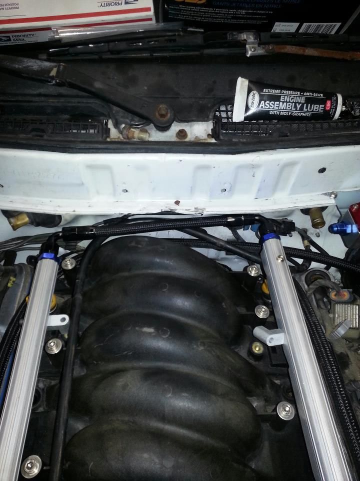

Exhaust manifolds installed(started some exhaust mock up...waiting to mount turbo over the weekend)
Spark plugs, MSD wires installed
Driveshaft made and installed
Turbo drain done

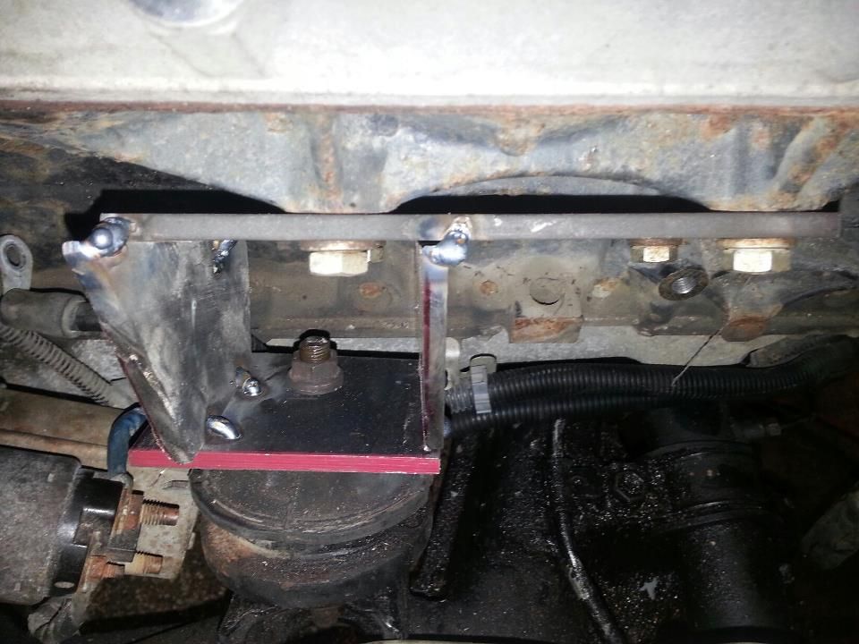

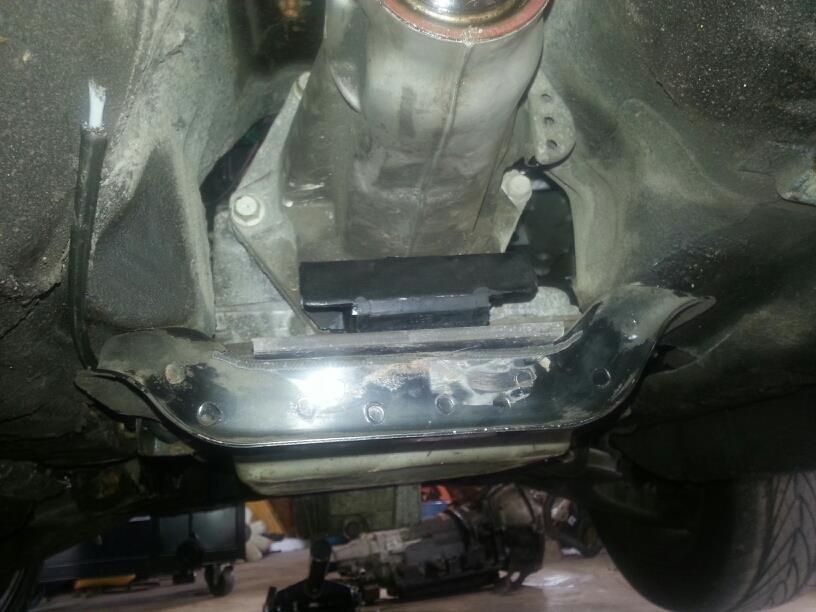

Trans mount made(needs welded still)

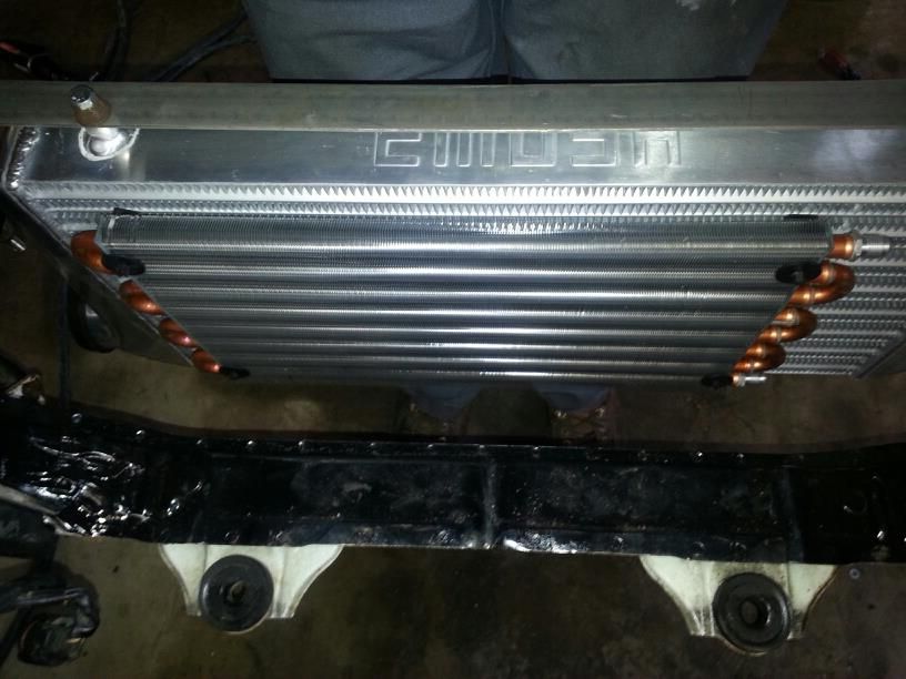

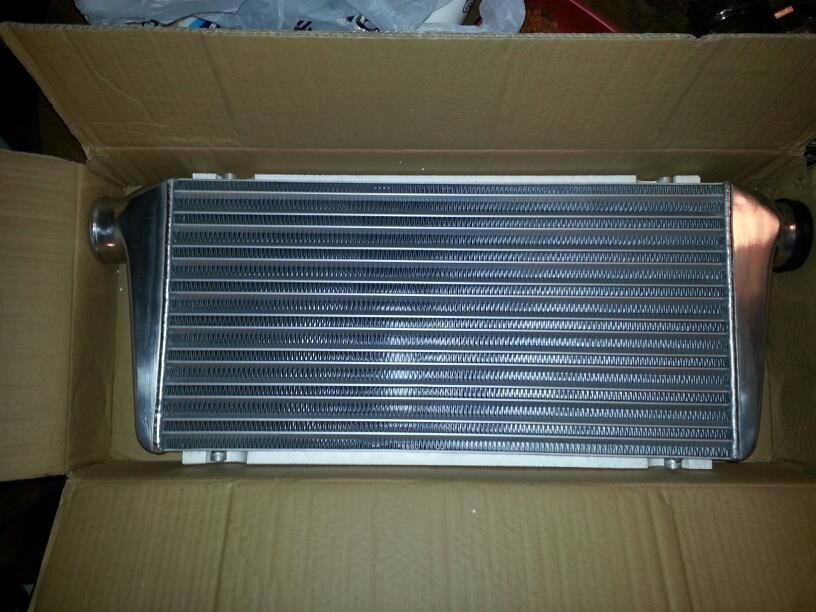

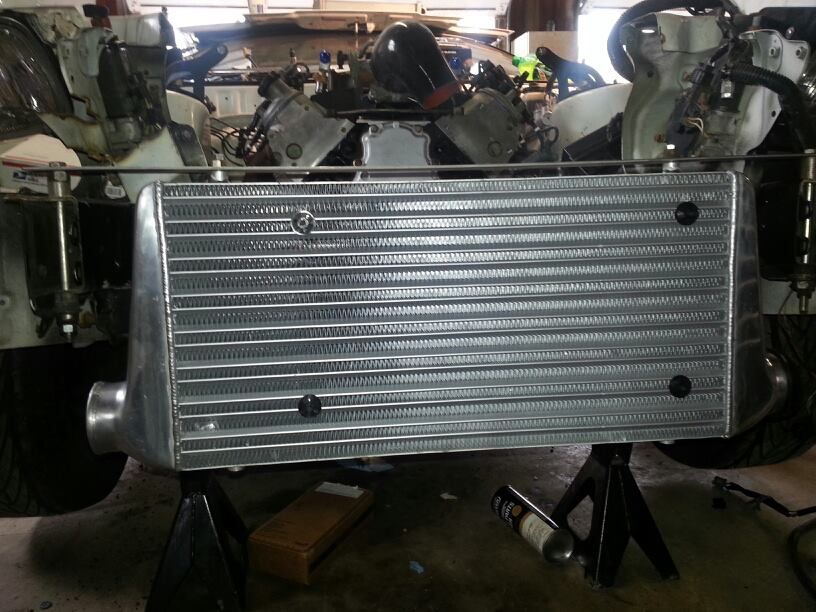

Intercooler and trans cooler mounted/installed

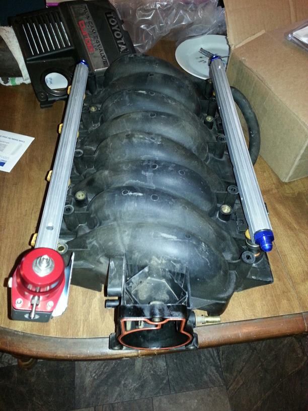

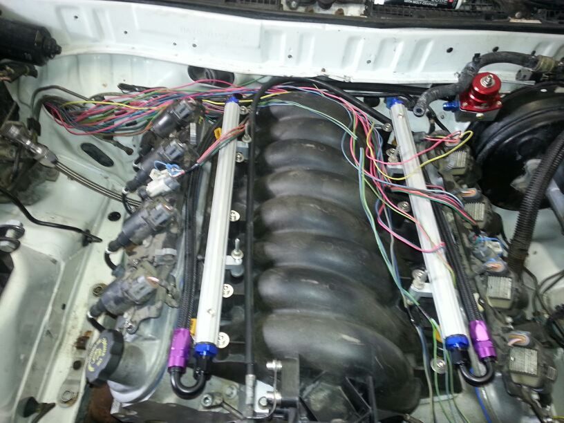

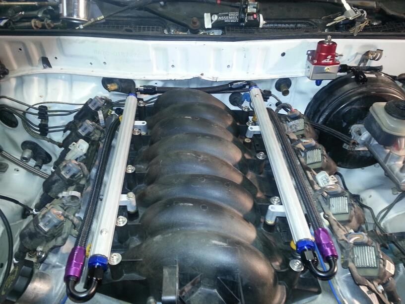

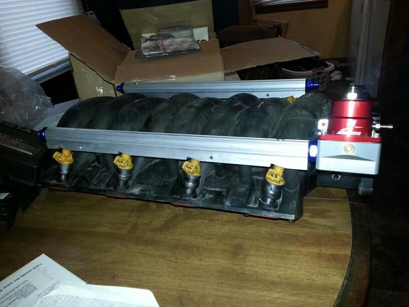

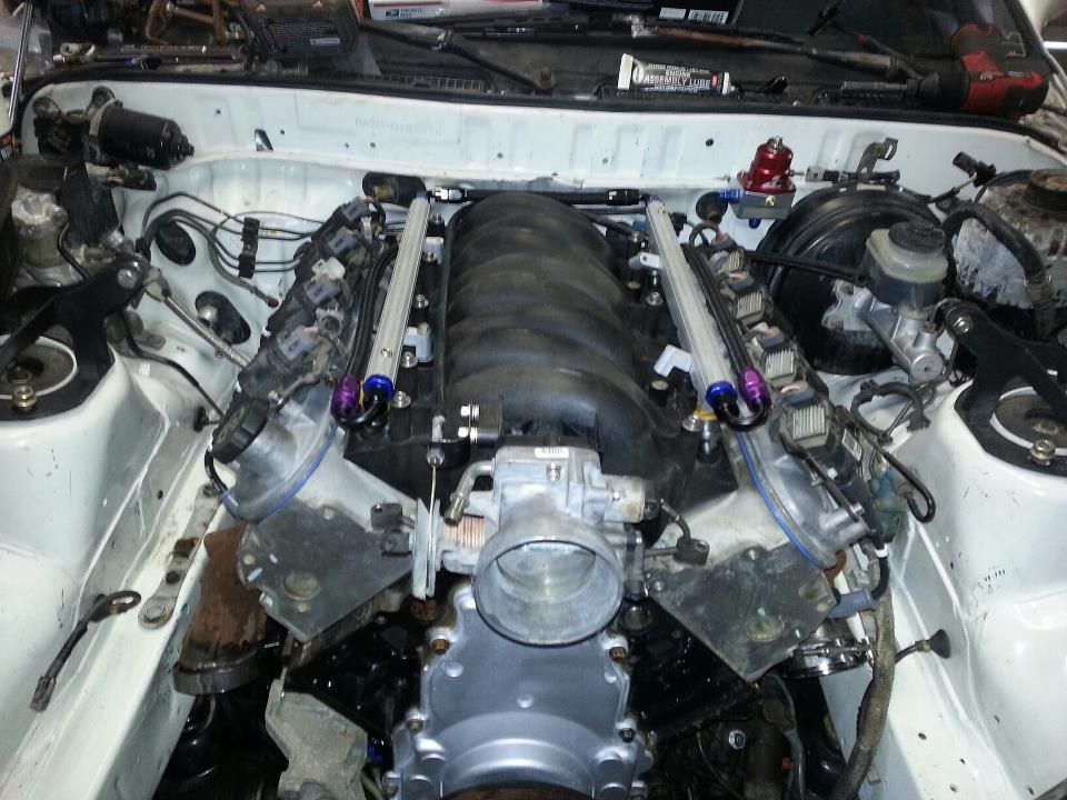

Fuel system plumbed
Now for pics:
Trans mount and driveshaft:
Motor stuff:

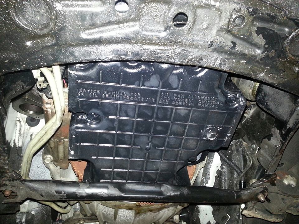

Got some clearance issue's with the pan

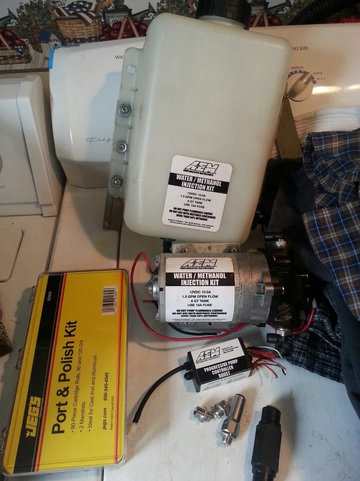

My AEM water/meth kit:

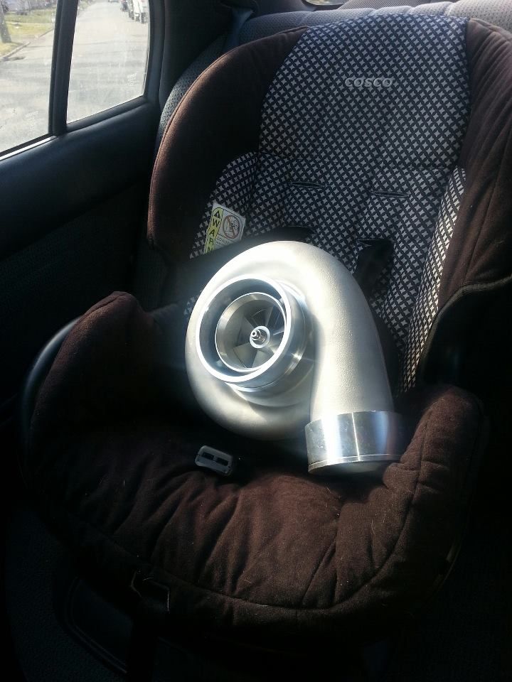

Safe turbo transportation lol:

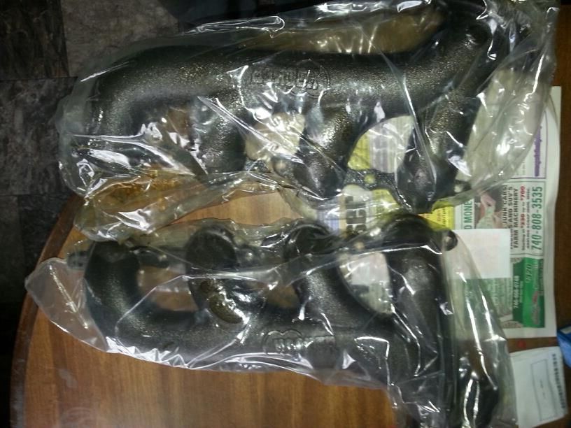

new cts-v hooker manifolds

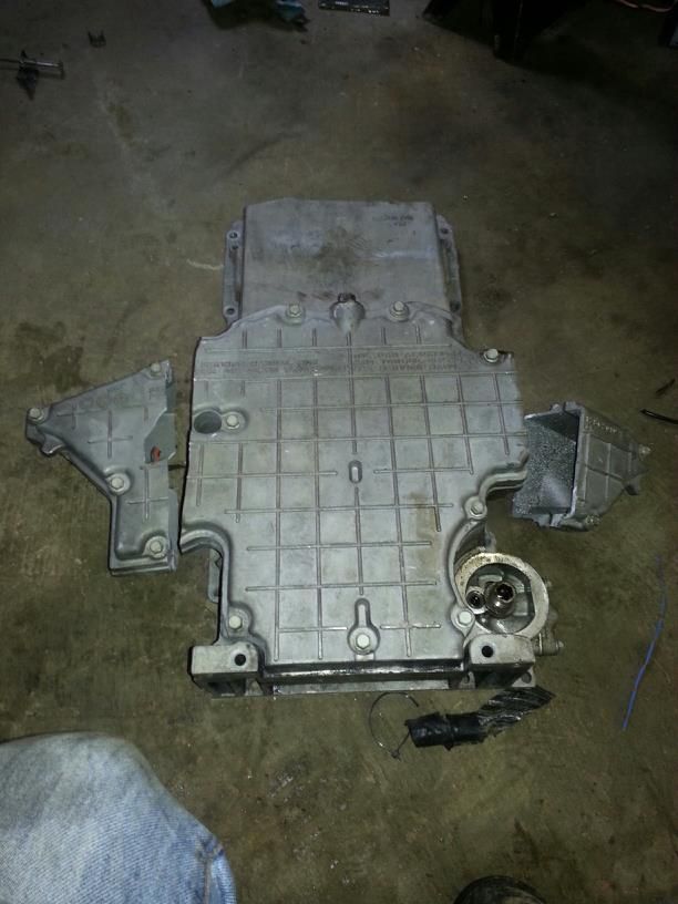

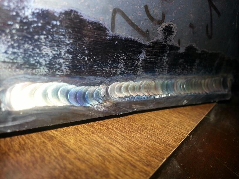

modified c5 vette oil pan

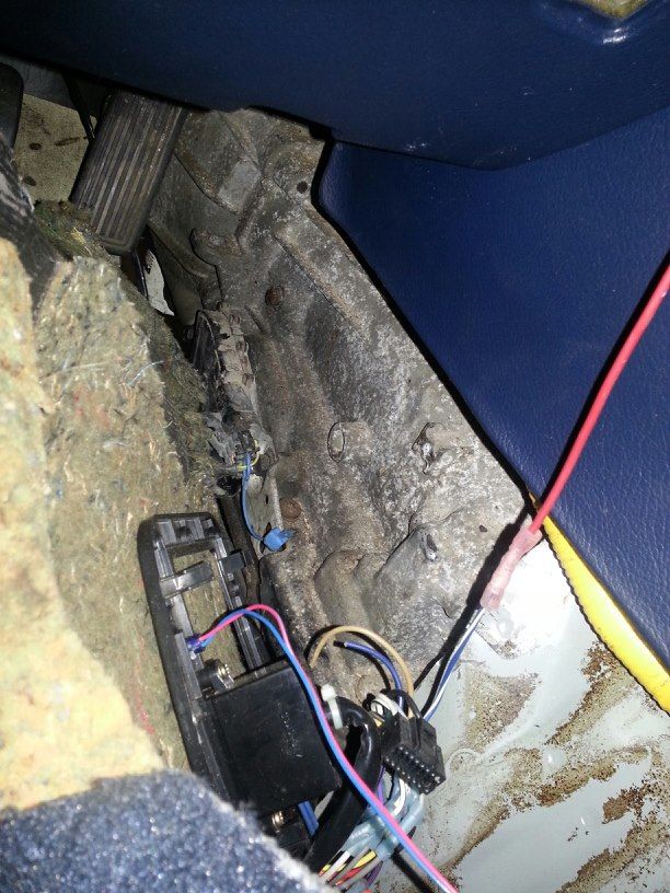

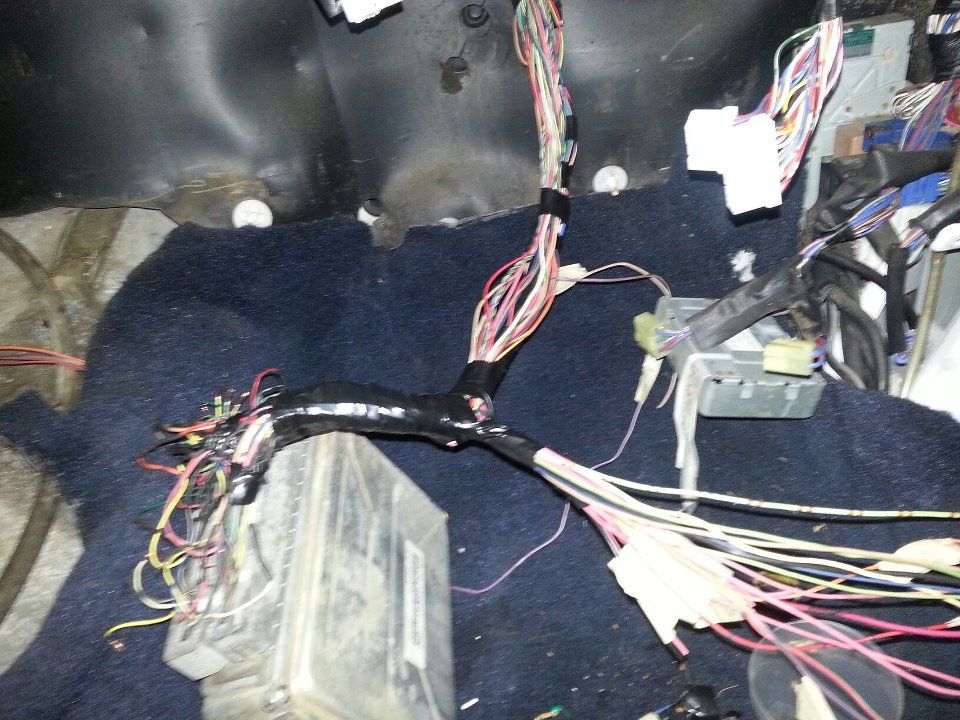

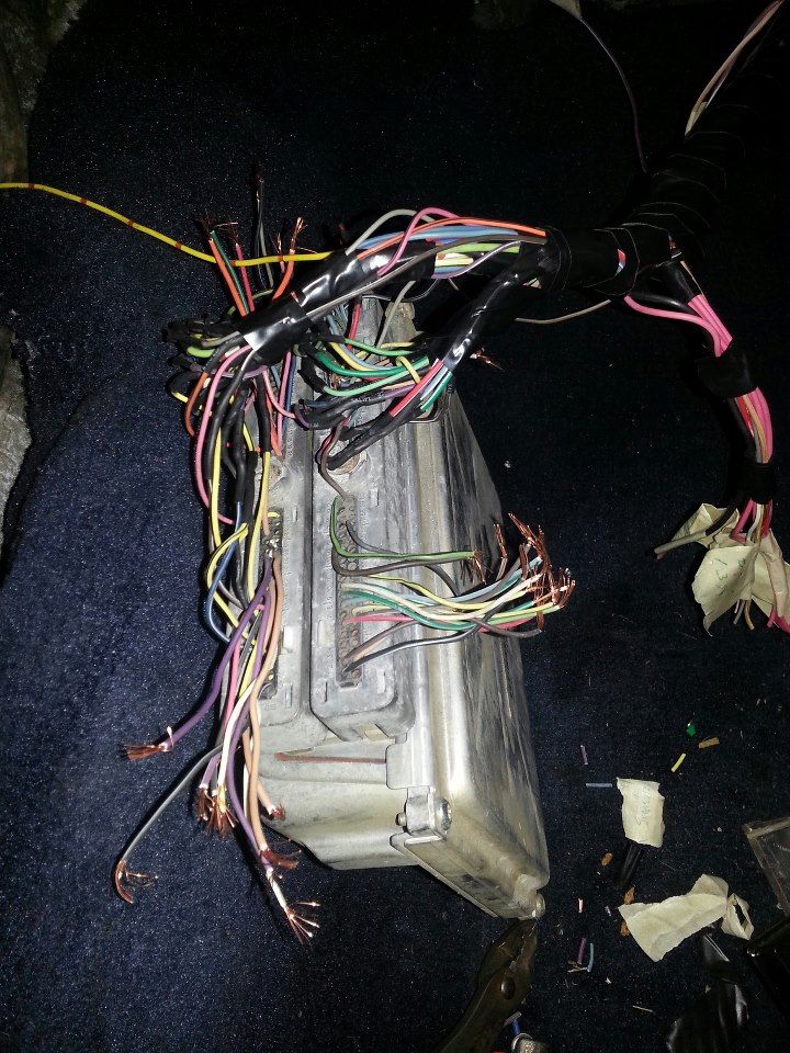

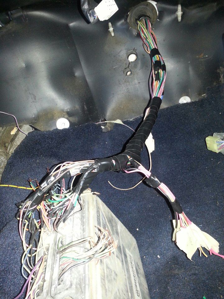

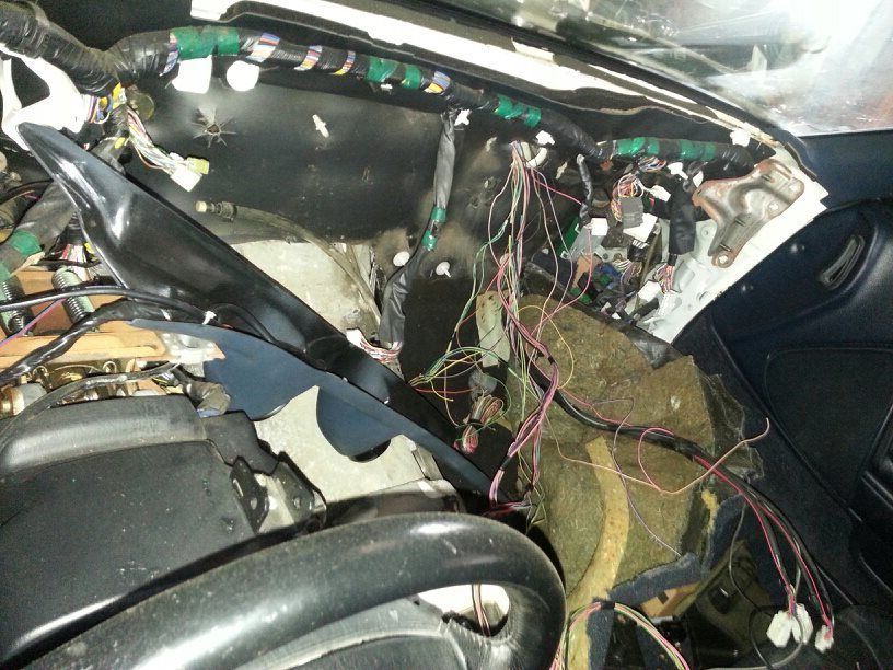

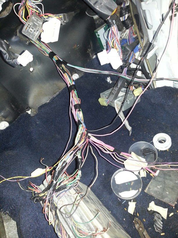

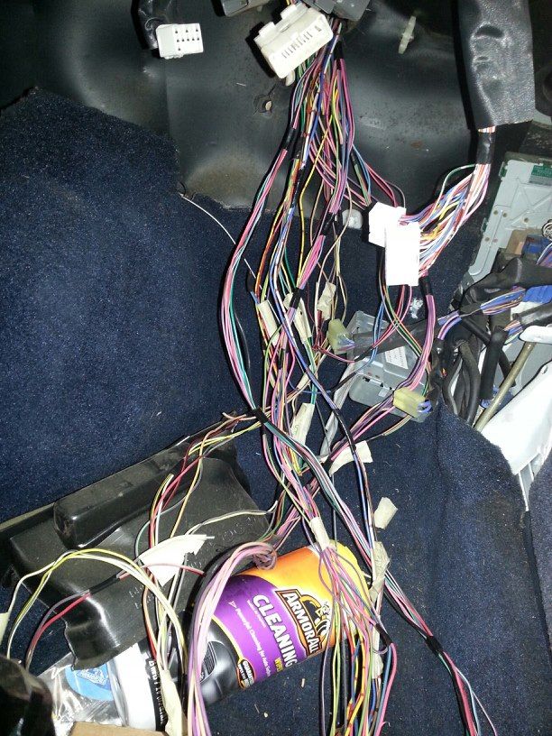

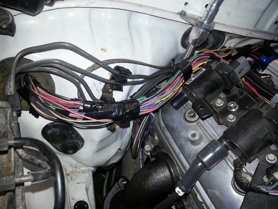

finished making my harness from scratch

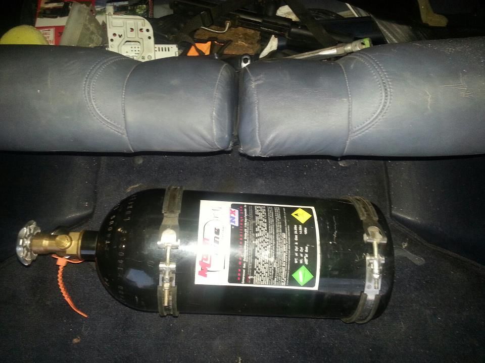

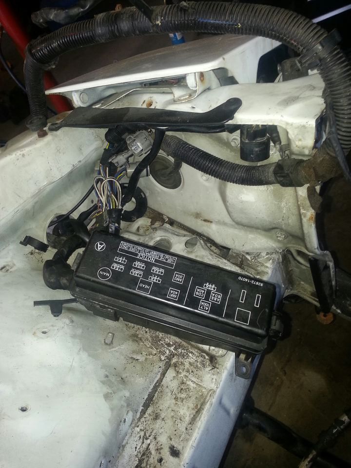

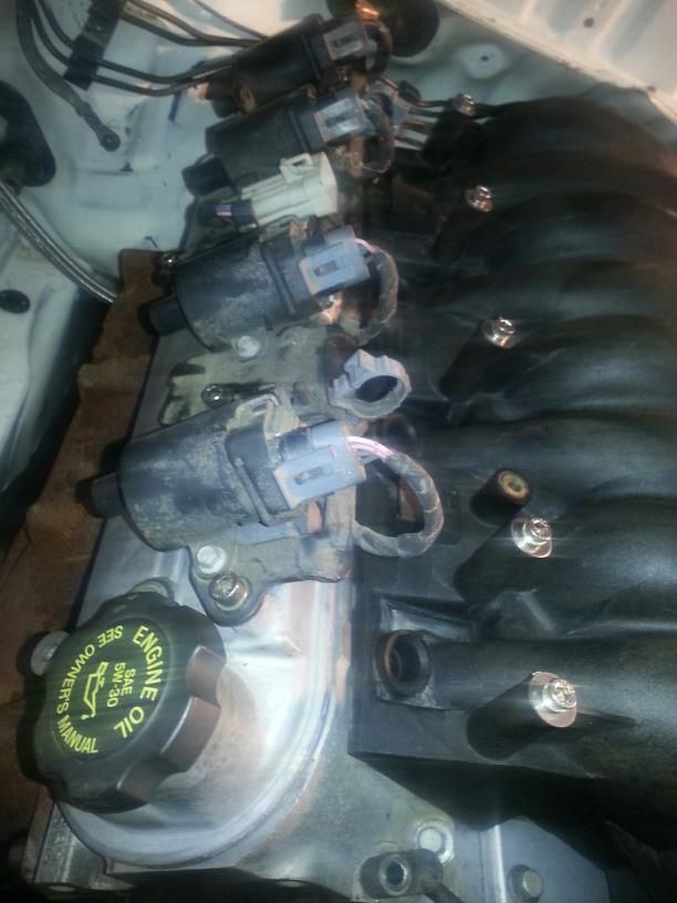

a little late on the pics i said i would upload...but here they are
car idles for 1 second due to VATS(vehicle anti theft system) going to have it reflashed this friday then will upload a video

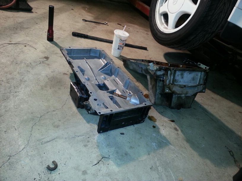

Modified C5 oil pan(its welded now lol)

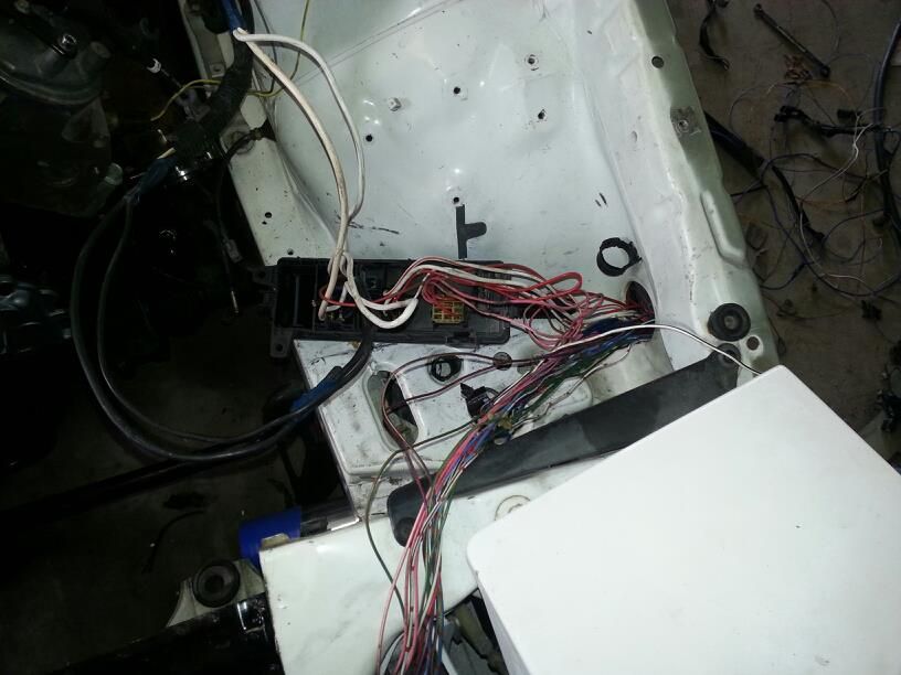

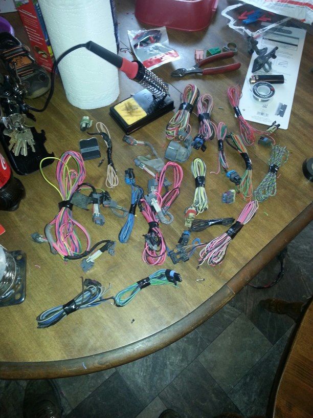

The wiring harness
Hooker manifolds

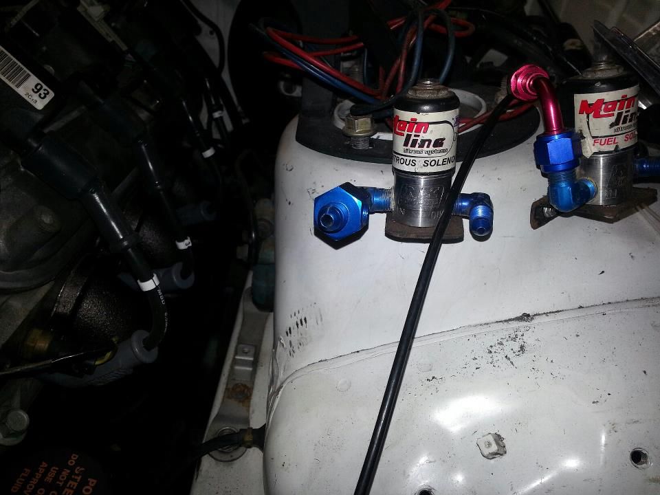

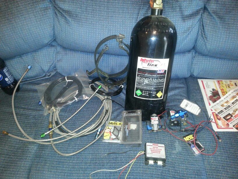

Nitrous stuff(need to remount the bottle) NOOB lol

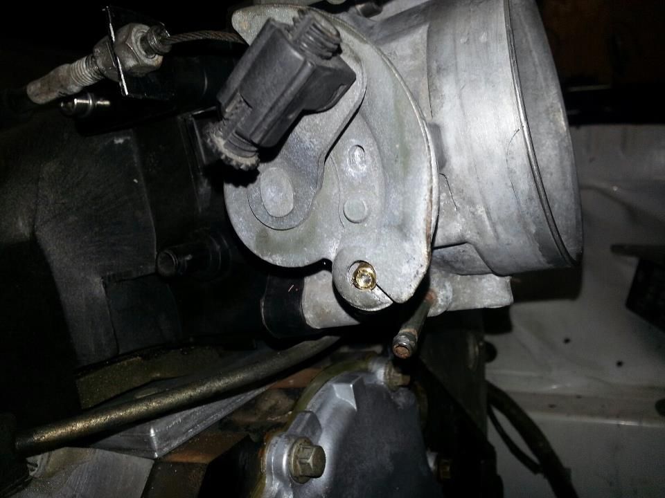

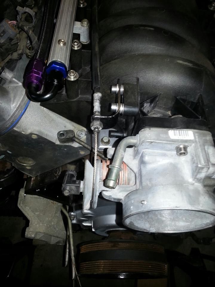

Custom throttle cable(from a 5th gen celica i cut and modified to use factory adjuster)
Misc pics and pics from today(my son loves my car lol)

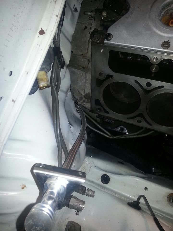

More progress has been made
Modified a custom trans shifter cable to work with stock shifter
Hooked up trans cooler

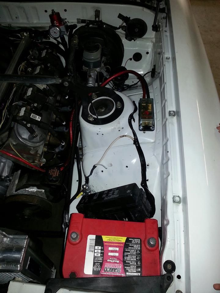

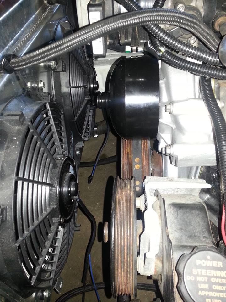

Added coolant and tried to bleed system to find that the truck style water pump will not let the system bleed due to the upper radiator hose having a highest spot in the cooling system. Installed a new 01 SS camaro water pump. Now I have to change over to 98-02 camaro alt, p/s brackets and tensioner
Made up exhaust(straight pipe dumped for right now)
Loomed a little bit of the harness
Bought a aftermarket crank pulley
Installed modified C5 oil pan
Put most of the interior back together
Got it to move under its own power(yet to drive due to water pump issue)
Will upload idling video later in the day
