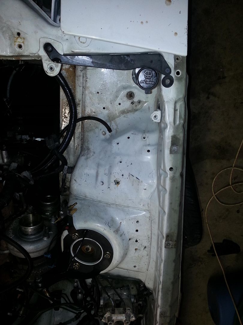

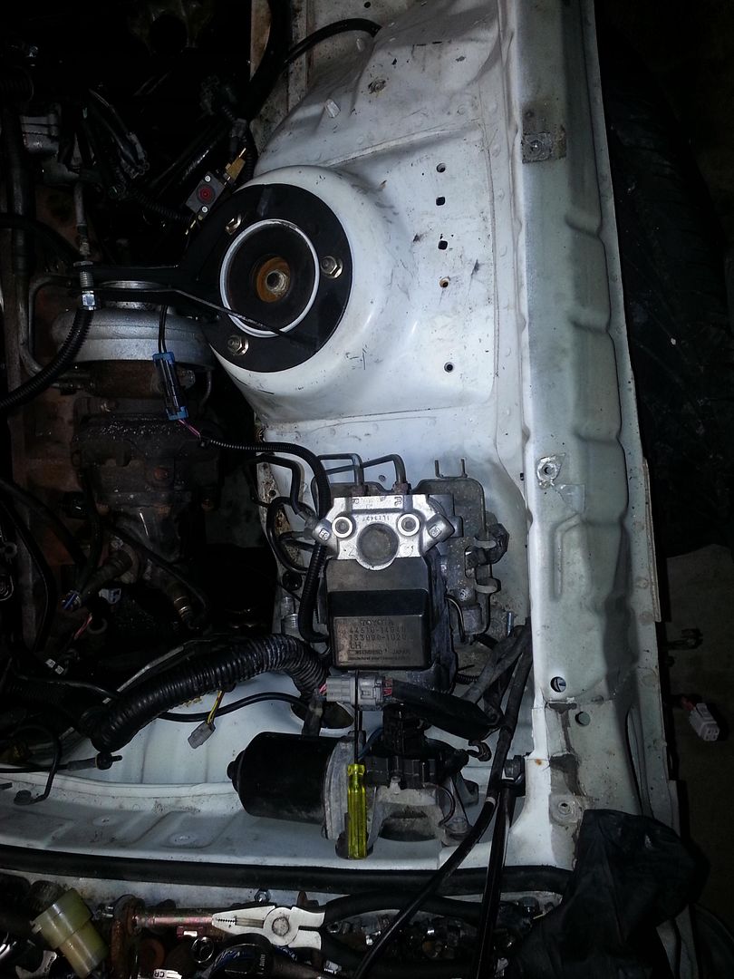

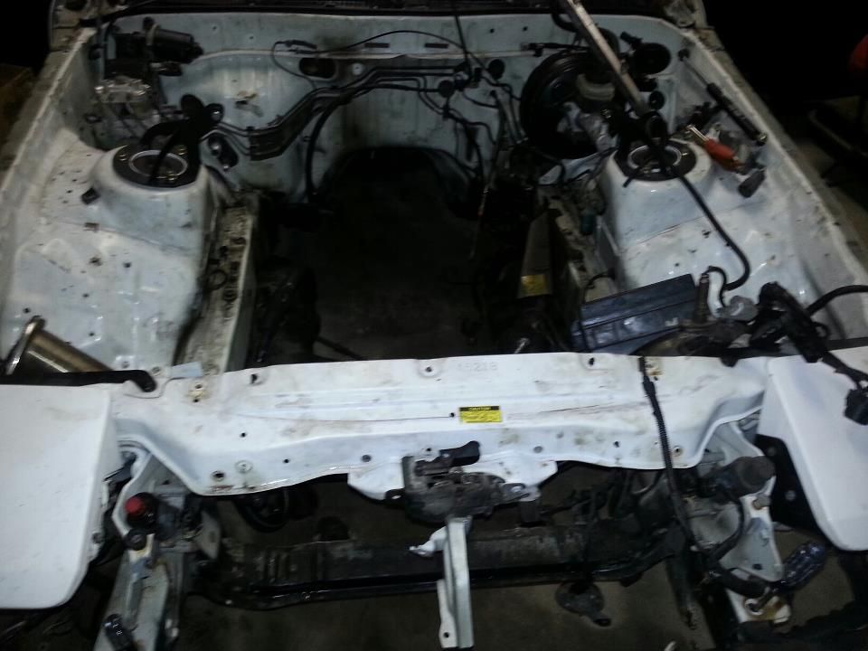

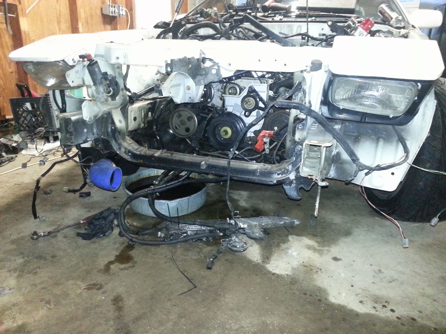

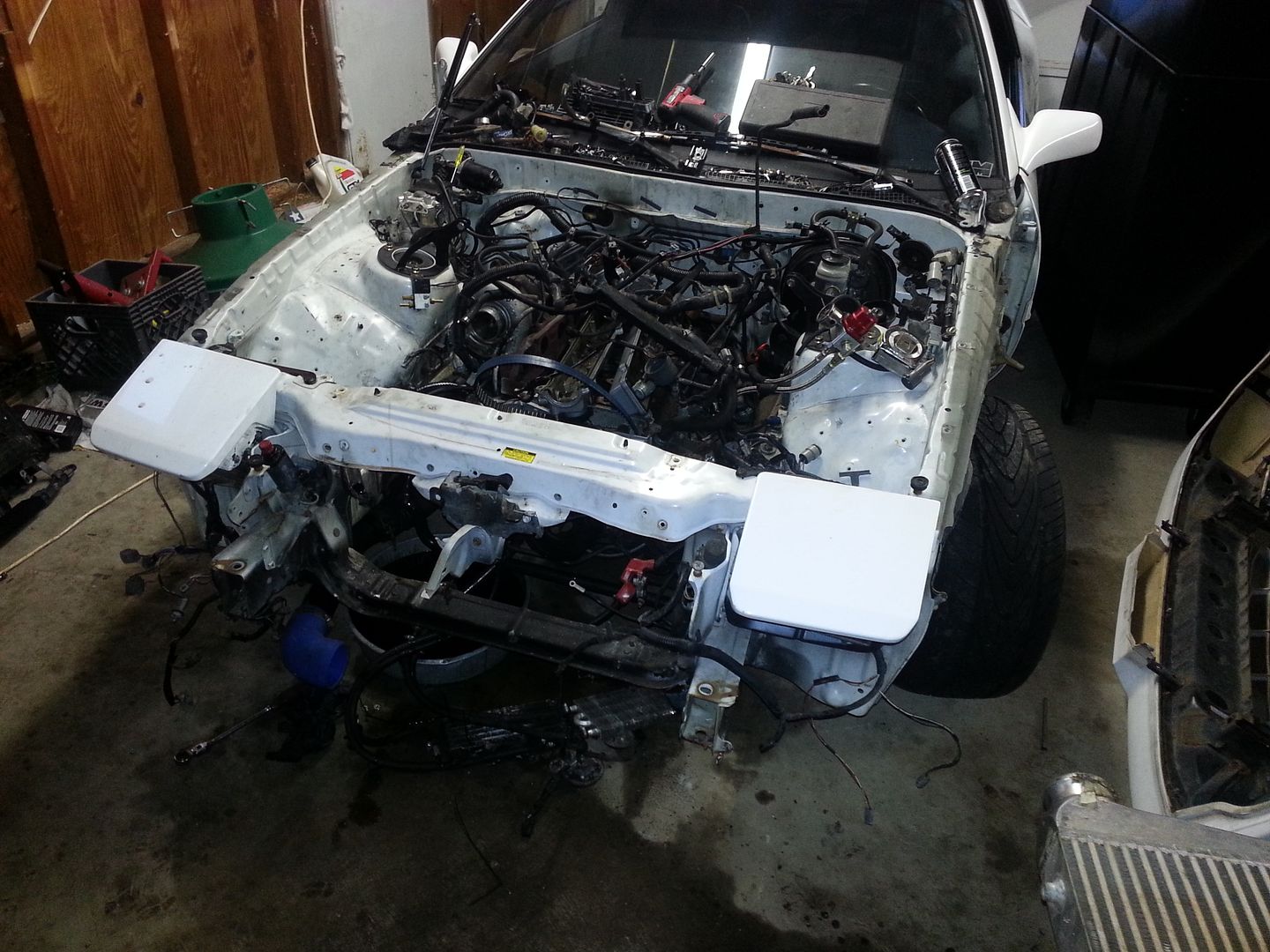

Well i removed the motor/trans last saturday
Disassembled motor to have it machined.
Came to my attention my motor will need bored over.
So i began searching for the next best option.
Found a 2jzgte with twins, harness and ecu for $1500 shipped. Had everything lined up to buy but backed out.
For the past 4 years i have this urge to do something different then swapping in another Toyota motor like everybody else.
Have decided to swap in a Chevy LS 4.8L with 4L60 trans
Going later today to pick up my motor/trans set
Ordered my GT45 turbo, 42lbs injectors, 3 bolt chevy flanges and T4 flange last night
Will upload pics later tonight for the fun to come :)

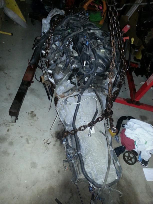

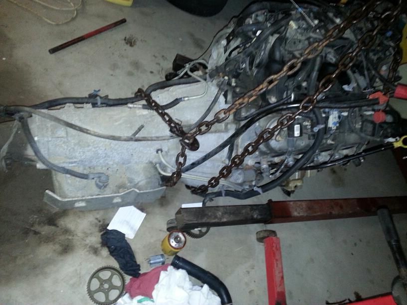

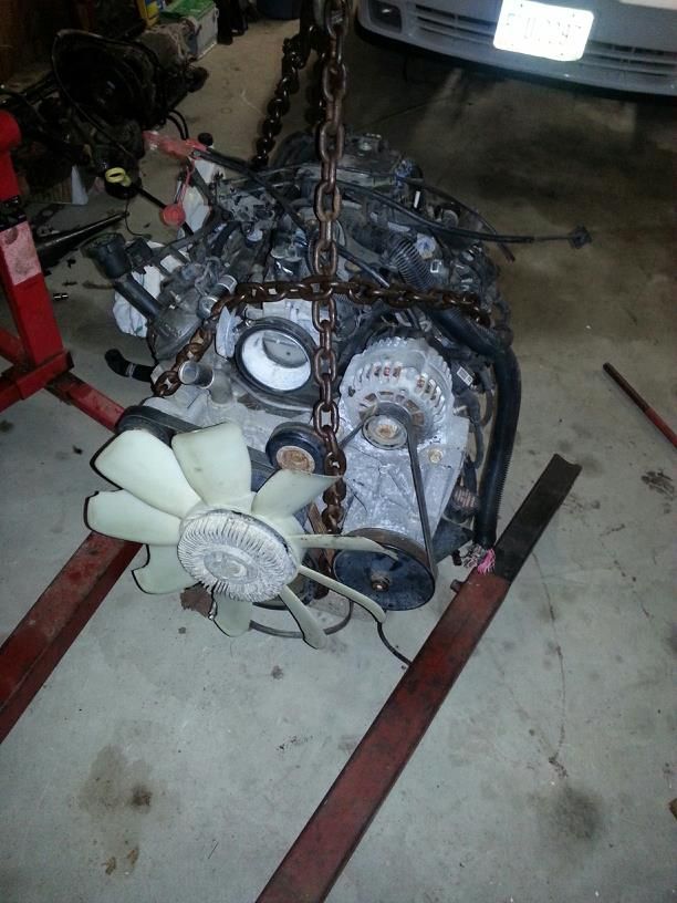

Picked up my 2000 4.8L and 4l60 trans for a great deal
Came from wrecked truck with 103xxx miles. (so i was told)
Has a cut harness and lines so i would atleast say it ran before being removed
Going to start mocking up this weekend

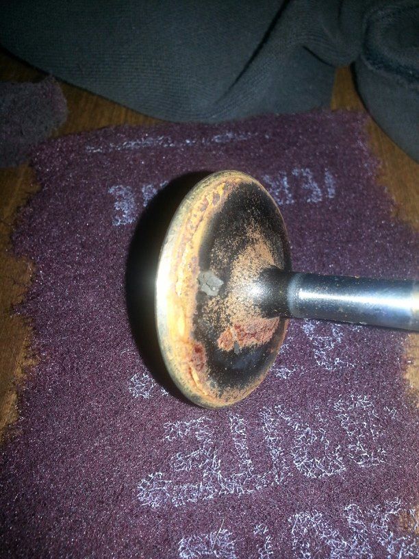

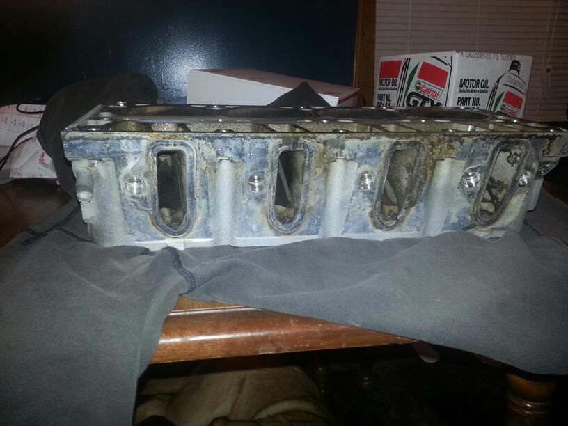

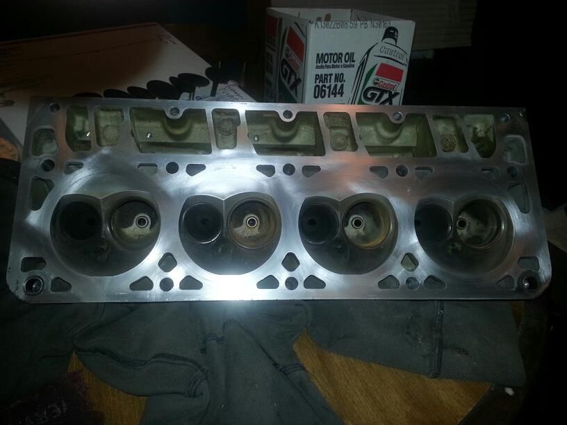

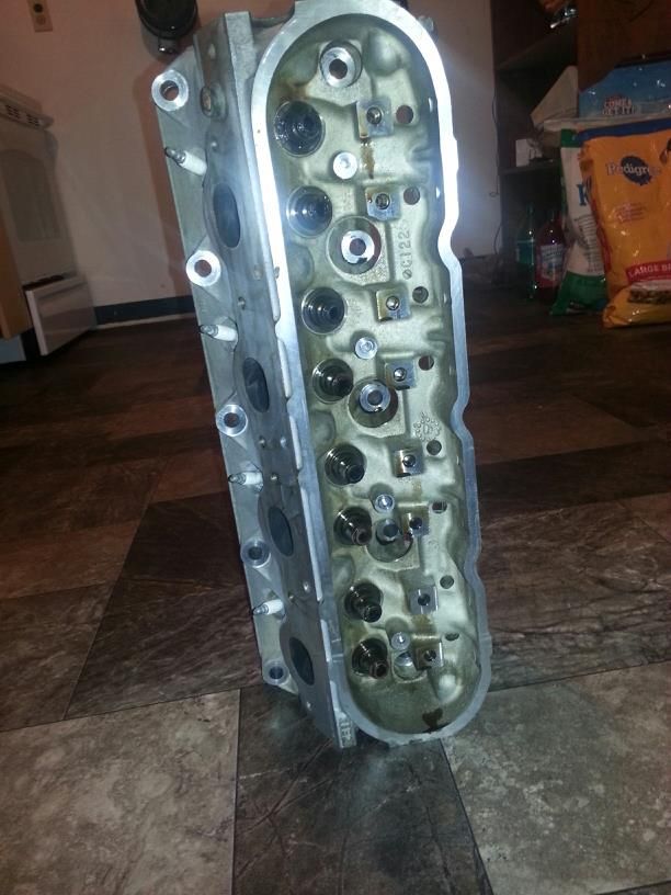

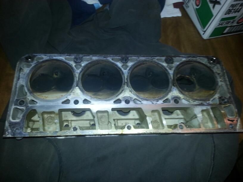

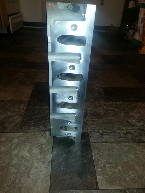

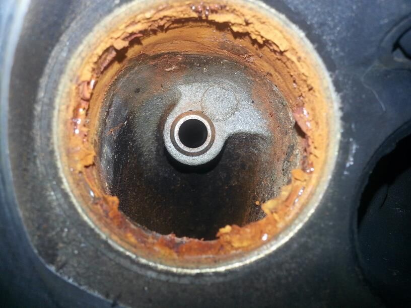

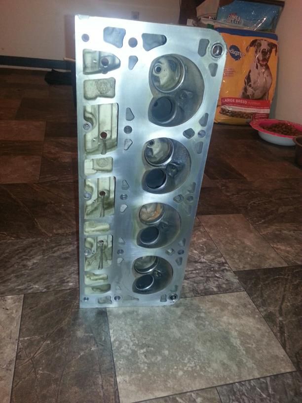

Did get a few things done today and ordered more parts lol
Removed the intake today and to my suprise found orange rust build up around intake valves
So i removed the heads and began tearing them apart
Everything cleaned up real nice and after lapping all valve faces are in great shape
Ordered some ls9 MHG's, ls6 yellow valve springs and going to check for warpage tomorrow
Simple brake clean and scotch bright pad im pretty pleased with how well head mounting surface cleaned up
Was suprised to find 0 ringridge. Nice and smooth
