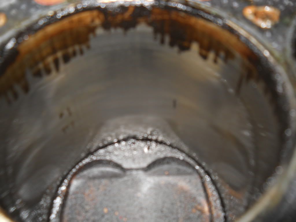

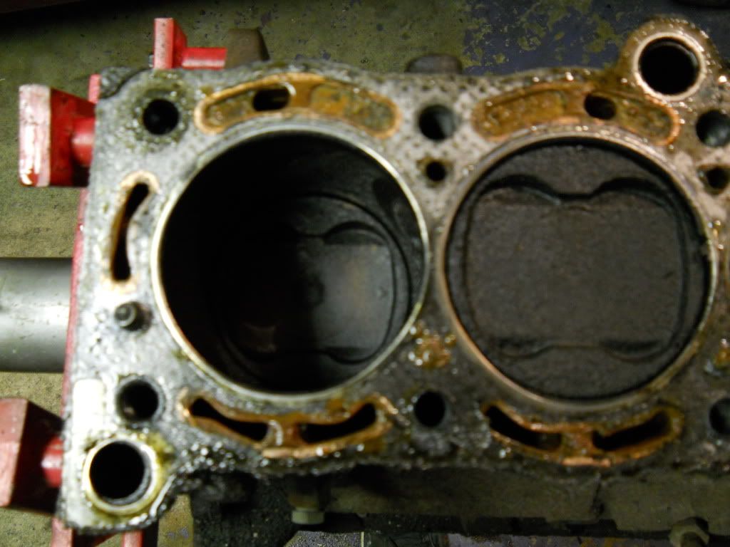

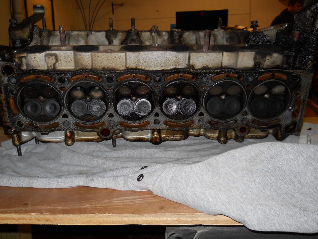

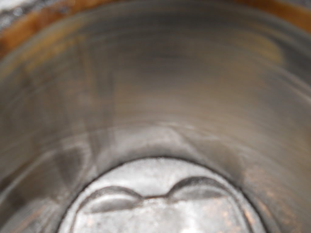

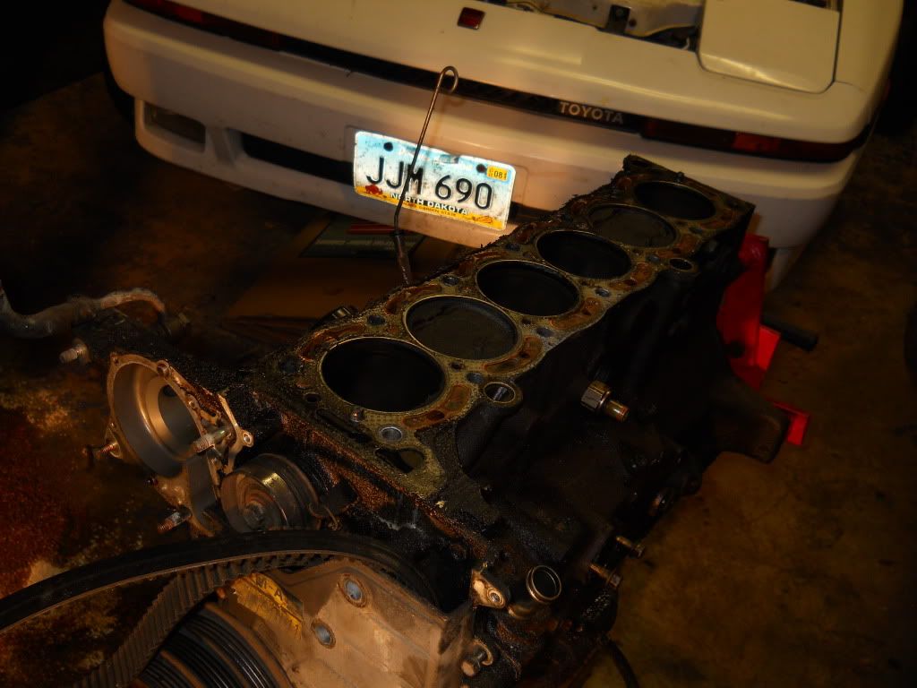

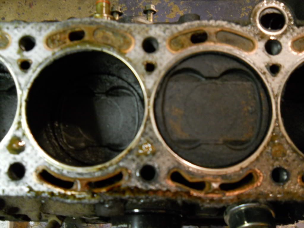

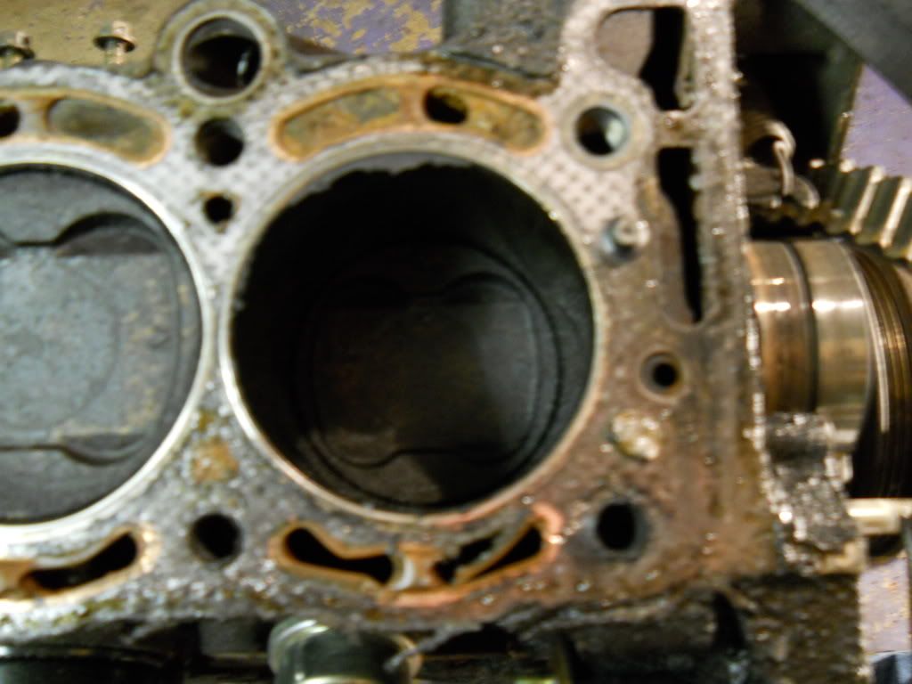

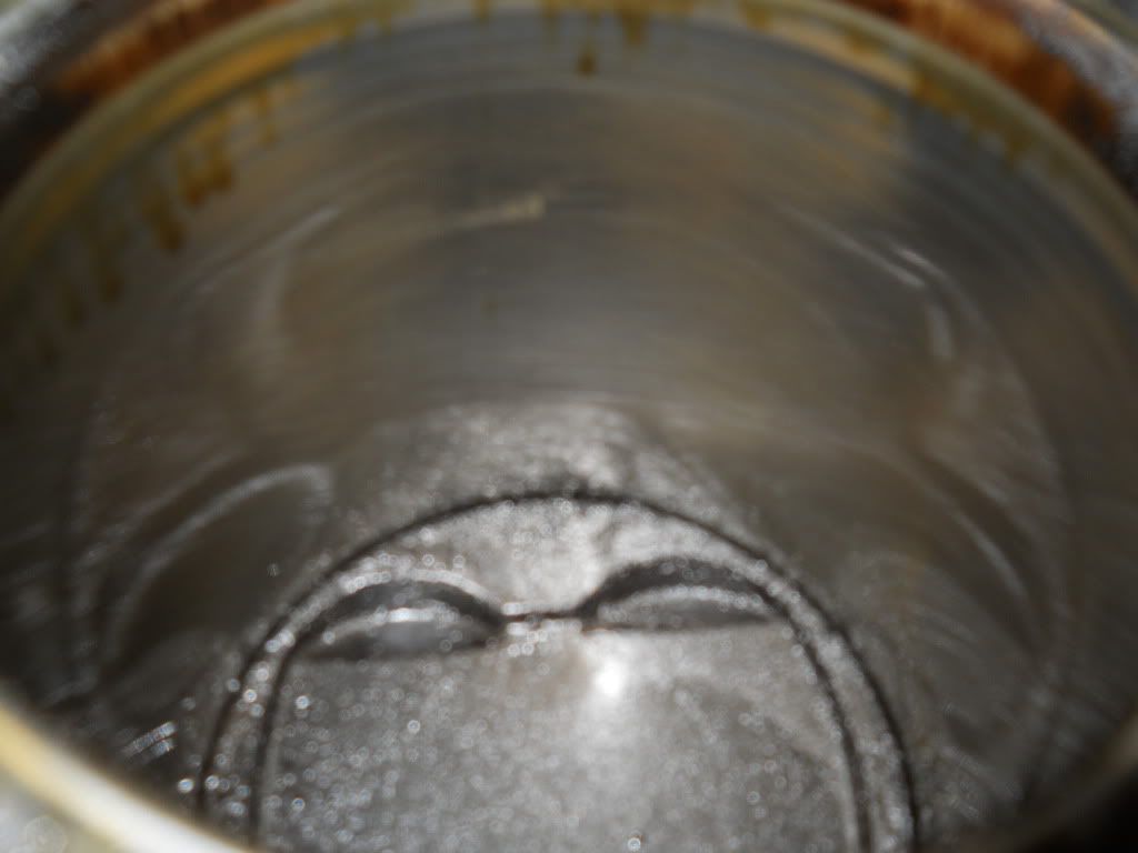

Got the head off tonight. The cylinder walls look like they have been honed, cross hatching is clearly visible, and look great. Definitely looks like a BHG though. The head needs to be cleaned and gone through. Ill let the pictures speak for themselves, and would greatly appreciate any criticism, comments, advice, etc.

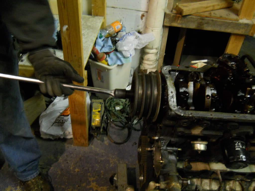

Damn Crank pulley bolt was a bitch! Just wanted to get it off for now.
Bottom end looks decent
Head off! Dirty
Head
#1
#2 and #3
#4 and #5
#5 and #6
Cylinder Walls
I apologize for the horrible pictures, I am definitely not a photographer
Also, the pistons each have a "2" on them. Meaning of this?

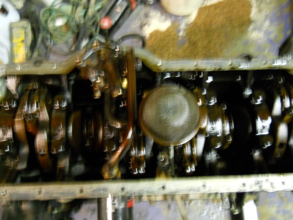

I finally got time and ambition to work on the supra a little bit yesterday. I got the engine down to bare block. Crank looks really good. As do the cylinder walls. Plan on doing a stock rebuild. Here's just a couple pictures. I have ALOT of cleaning to do while I wait for funds to get the engine to the machine shop.
The crank pulley came right off with my 20 dollar Harbor Freight puller.
Timing tensioner was frozen SOLID! That can't be good....
