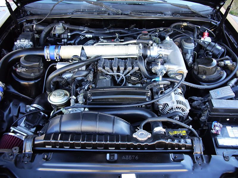

On another note, i just experienced what a boost leak feels like on this thing. OMG. I lost a clamp on the intake side of the intecooler and i almost thought i had just thrown a rod. I managed to limp it to a friends house, but it seriously scared me...On my Integra, all that would happen if i had a leak is i just had no boost...but this thing would barely idle...is that common?

I think Integras, and most Hondas, are MAP based systems like the 1JZ. AFM'd cars don't like boost leaks and will run horribly.
You could drive a 1J around without any of the IC pipes on.

That's what i figured as soon as i posted that. 5 min. fix.

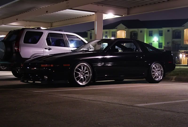

Small teaser shot...more to come. :)
Bigzavs
86.5 1JZ Single Turbo
Apr 21, 2005
2,267
Arlington, TX
wow dude, it looks great, i tried gettin those rims from matt a while back (he ran no bumper back then also)
man you have to bring that thing out to one of the local meets man, it is absolutely beautiful
