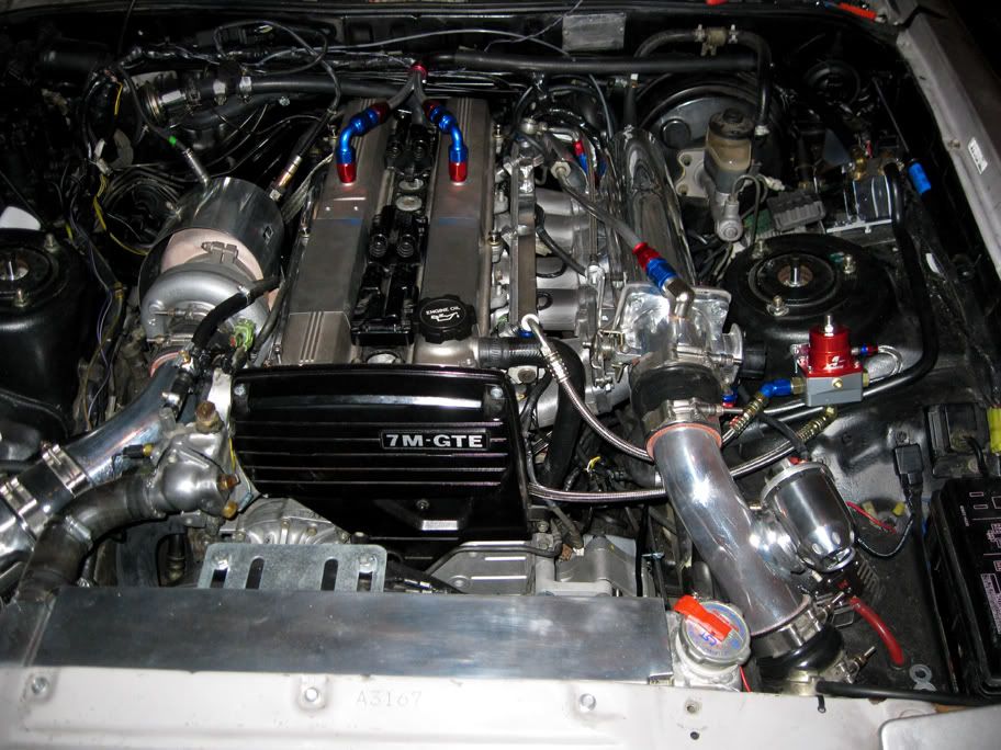

Ok so yay or nay on this one....
I'm waiting on parts, so that means free time to muck around. So I am thinking of relocating my coil packs to sit in the plug galley, and have made these covers to fit over the indention in the valve covers (the shine needs to be toned down on them a bit to match better), just one more way to clean things up. What do you think?
I want to get the valve covers from ARZ (Arizona Performance) as they are amazing, but I don't have a grand to drop on bling right now. I am still hoping to get the car painted soon (which means I have to get a hold of a CF hood also). So for now this may have to do.....
Before:
The mock up:

Personally I think it looks more cluttered than having them stacked together, unless your gonna get the Arizona center cover and then it would look awesome....I got a quote for the valve covers/center cover/coil pack relocation/CPS cover all together for 1100 I think a month ago...but yah just a little too much money for bling at the moment for me as well.

C-T, Yeah I'm really undecided on this one, The pics (because of the flash) look funny compared to how it looks in person. But yeah, I would love the AZP covers, I've never really liked the stockers, mainly because of that indention...

No problem. :) For what it's worth, the way you broke up the coils looks much better to me than the giant turd on the cam covers in stock form. :)

So I have 1-yay and 1-nay......What bugs me a little are the covers....still not sure if I like them or not. I do think it cleans it up better, but also has a cheap look to it :dunno:

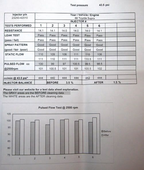

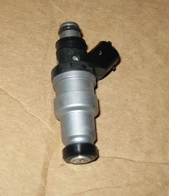

Alright, I got my injectors back today from WitchHunter Performance. They look brand new! Lets hope the work like new...
I am confused about one thing on the detailed printout they sent. It shows the injectors resistance @ 14.
I tested the resistance before shipping them out as they asked, and they tested for me @ 2.8. I saw the print out and was like WTF?? So I just tested them again and they again came up at 2.8. So that inspires confidence in their work...
But the rest of the data looks fine to me, the injectors actually look as though they were decent before cleaning. I will post this under the tech section also to see whats up with the resistance readings.

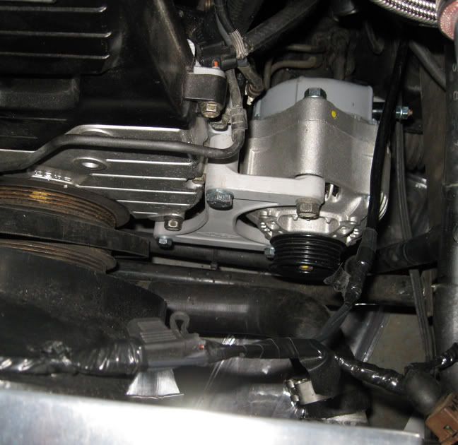

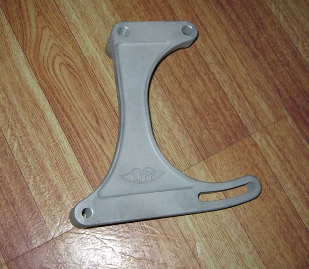

I got another part in that I "ordered".
First off I've been doing business with SUPRASPORT for some time now and have had nothing but good results.
This order...well..not terrible, but defiantly slacking.
Sunday I ordered the "Beech 7m Billet Alternator Relocation Bracket" and also added the extra $20 on for the belt.
So today (Saturday) I receive the order, great, but it is the "LIPP" bracket not the "Beech" one that I ordered, and on top of that...no belt, that I payed extra for....
I'm fine with the LIPP one as it does the job, (even though I paid an extra 5 spot for the Beech one) But what really gets me is the belt was not sent.
Edit: got a hold of Jack and he apologized for the mix up, and he put a belt in the mail today ;)
So here it is and I also finally installed my AFPR, and I'm putting in the Walbro.
BTW I ordered these and my MAFTpro and all extras from suprasport a while back, as seen earlier in this thread, I love all that SS does for us ;).
