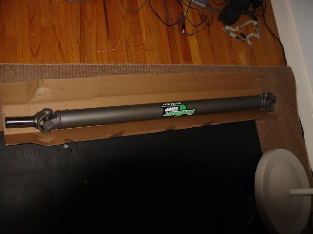

soon soon, sorry i had a problem with my center support bearing going out on my drive shaft leaving the car un-driveable. I suspect that the increase in power has caused it to go to hell in a handbasket. So i ordered a 1 peice steal drive shaft from the Drive Shaft Shop, i should have it by the end of the week if everything goes to plans which it should!

Update: just installed my new driveshaft now the grinding noises are gone :naughty: Im thinking about making a video tomorrow afternoon just to show how well the new turbo behaves.

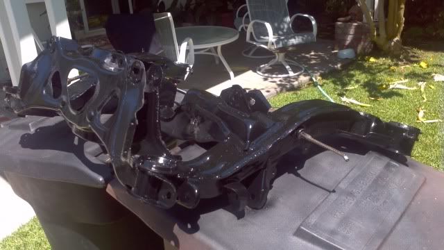

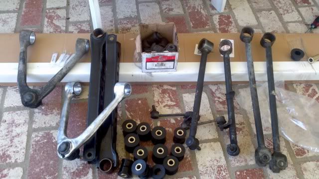

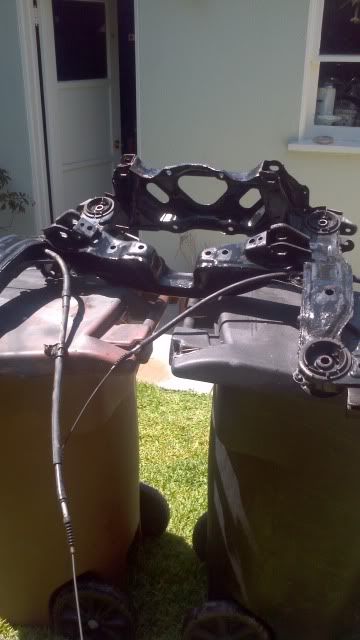

I have started my suspension renovation project in the rear. I got some beach performance subframe spacers, and im going to buy a tube of polyurethane window weld to fill the actual rubber bushings in the subframe. Plus i got polyurethane bushings for all the suspension arms in the rear, im hoping all this work will make a big difference in the ride.

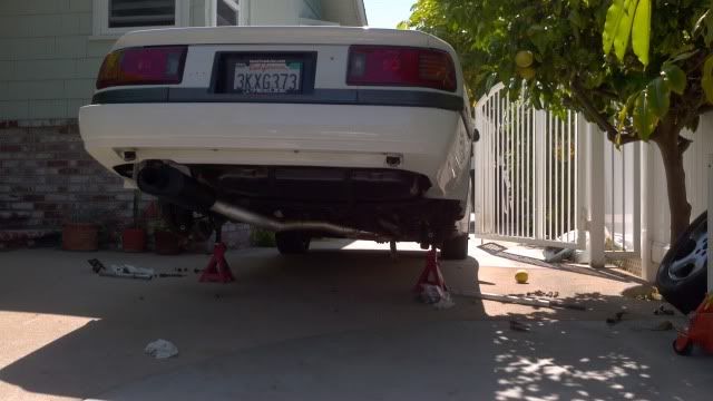

before:
After:

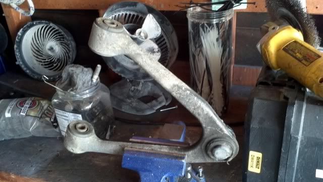

IMO the poly suspension bushings tighten up the suspension, but you will notice that bumps in the road are transmitted more directly to you (and the CD player). Nothing too horrible for me, but I could see where people would not like it.
For the upper control arm bushings, I used a c-clamp style ball joint installer to remove the old bushings- it worked like a dream.
For the rest I had to use a shop press and a variety of diff. sized steel discs to press the old bushings and sleeves out of the arms. Kinda a pita, even with a shop's equipment.

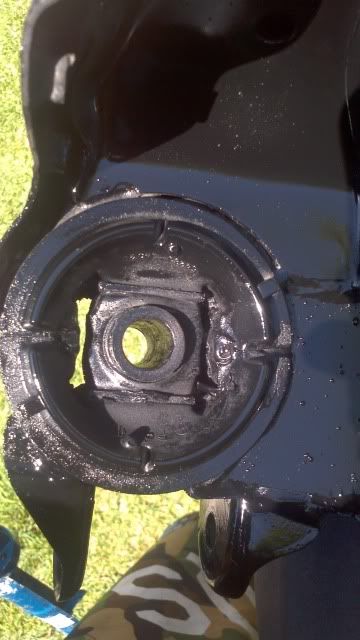

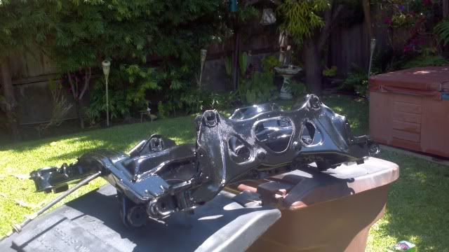

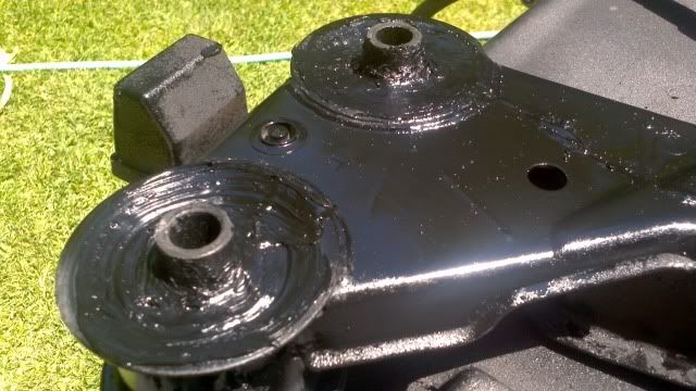

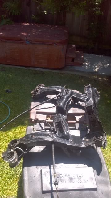

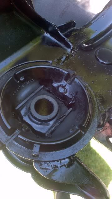

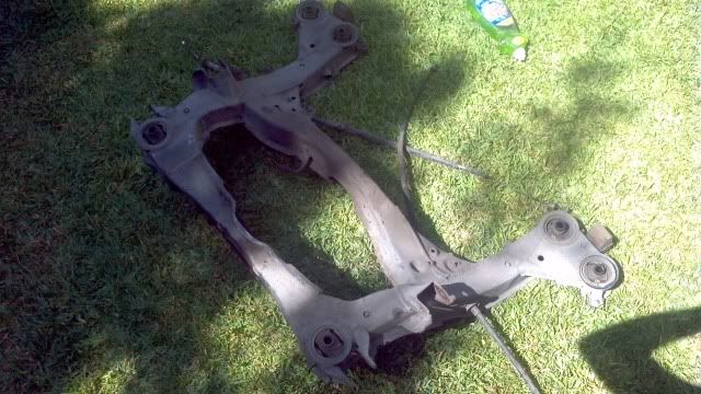

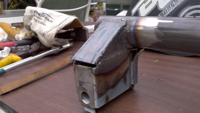

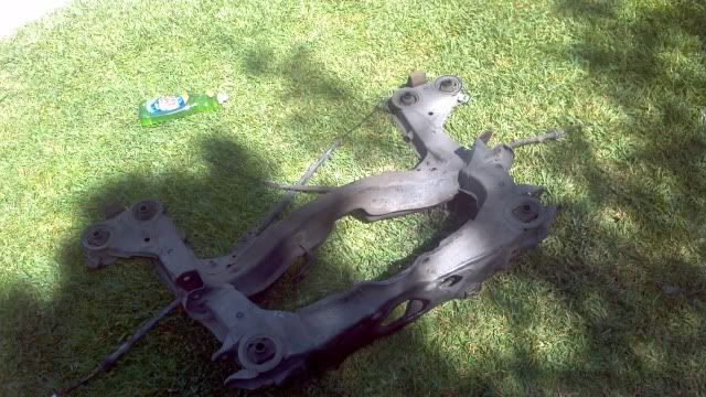

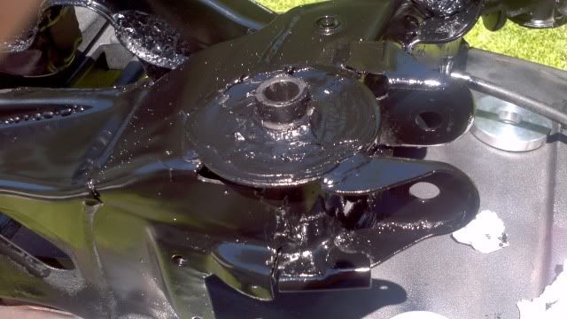

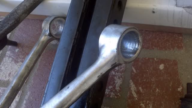

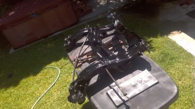

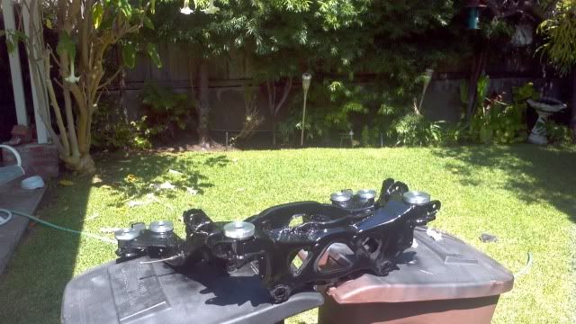

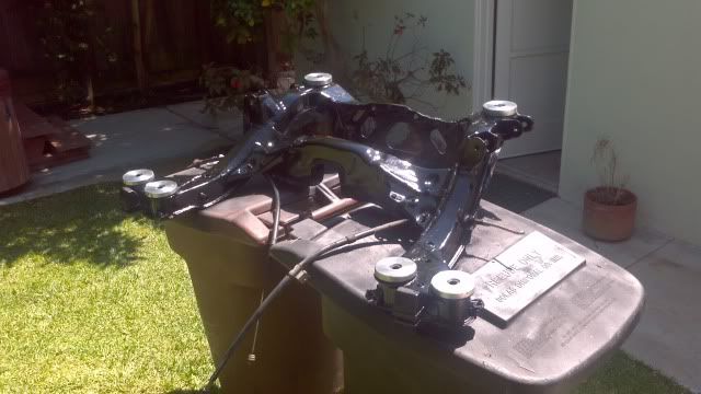

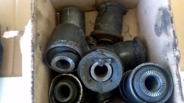

Soo finally got my project done by myself it was a PITA! I got the car aligned after every thing was finished and then went to the local canyon to test everything out. The back end it soo much more solid its amazing, like night and day. Before the back end would float around like a boat now its completely solid like a sports car. The difference should be comparable to going from your stock swaybar to a upgraded one, Its hard to believe that just doing that would make this big of a difference in the way the car handles; mind you i still have a stock swaybar and tired Bilstiens in the back. Ill be doing the bushings in the front very soon!
Another thing i noticed was the increase in drivetrain noise being transmitted through the frame like a megaphone. I knew my differential was partially blown but now its crazy apparent, lots of grinding and winning noises now :(
I would definatly recommend this to every one on here, it was worth every dollar!
After i cleaned the subframe up:
Painted:
stock bushings:
window weld polyurethane:
Modified bushings filled with polyurethane:
beech performance subframe locking bushings:

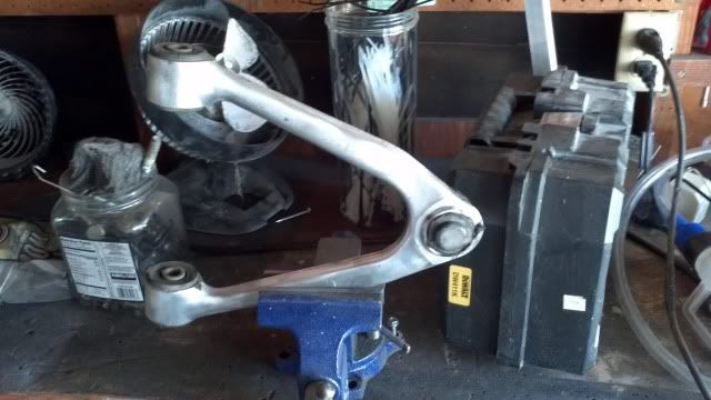

After the control arm bushings were pressed out:
the old wornout bushings:

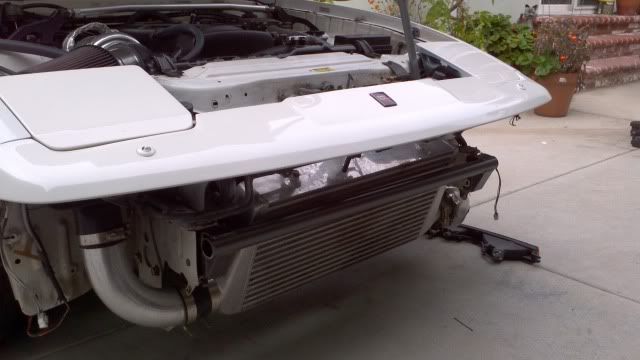

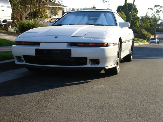

thanks man, recently ive been trying to improve on looks too. Shine s2 air guide, and Shine Turbo A duct installed:
monster2j
Aug 20, 2010
119
socal
Yeah ill have to find some better lighting somehow. Shine makes the Turbo A duct, its not on their site you have to email them to order it. The A duct was $100 and the air guide was $125, In person it looks soo much better it changes the front end of the car and makes it look soo much more aggressive; i love the way it looks now. All i need now for the front is a lip
