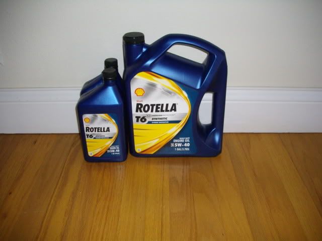

Update: drove up to Drift Motion the other day and had aaron instal an HKS FCD, witch he set to level 9. He also rebuilt my fan clutch with some special oil he has to reduce the viscosity slightly so it wouldnt be so loud, but still be able to cool the motor. I also picked up some Rotella T6 5w-40 the only oil that truly uses a synthetic base made from wax, it also has high zinc and phosphorus content witch makes it great for protecting turbo charged motors, so well see how it does!

one more thing.....hows that oil working out, and how much $$ does it run. right now i use german castro 0-30w which is a true syn. but its hard to find so.....might be switching to rotella T6:)

Thanks, yeah the FCD works great, im right around 15psi with no boost controller. Now that i have no boost cut i need to work on the speed limiter, lol the car gets up to 120mph pretty damn fast. Dude Rotella is some good stuff, its got like 1300 zinc and 1200 phosphorus where Castrol i believe has 700 zinc and 800 phosphorus. Those are the two main ingredients needed for turbo charged cars. Haha and Rotella is only $20 at walmart!

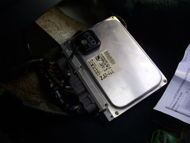

Aaron at Driftmotion did the wiring..

what a good find on the rotella! this is the first time i have heard of it:) i think i will switch over on the next oil change... and ordering a FCD today!!!!

My DSM friend has a Inovate wideband i just need to get a bung welded in my down pipe. heres a picture of the FCD in action:

sweet!!!!!!!!!! it should only cost $40 at the most to weld a bung on there, make sure you have them put it down aways from the turbos so you get a good reading on A/f's.

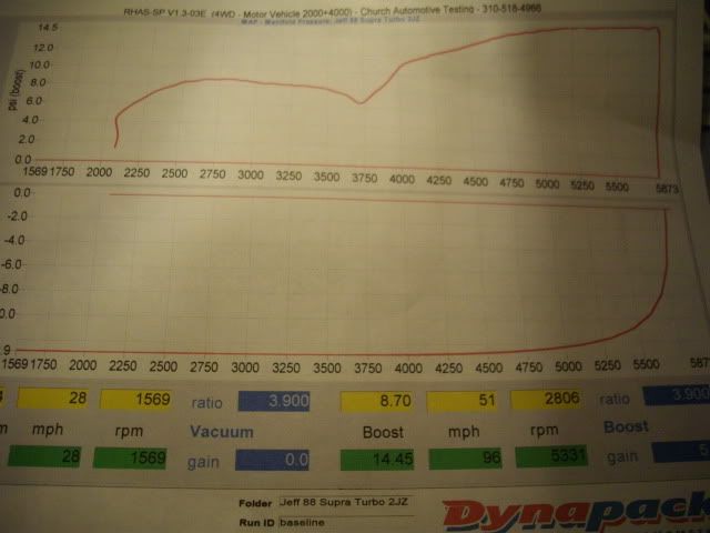

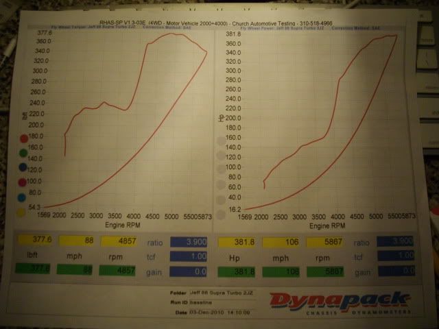

Wow 381hp?!? seems a little high to me for stock setup. I mean its a Aristo set up with the smaller cams and turbos. Did you do a third gear pull of is it the dyno correction?

No it was a 4th gear pull, Sean Church of Church automotive testing did it so i doubt he messed up since he is like the best tuner on the west coast. Dyna pack reads a little higher than mustang and roller dynos because it measures the power at the hubs, so there's no rolling resistance hence it reads a little higher. The leaner you are the more power your going to make, but i was dangerously lean(12:6:1), when i add more fuel i will definatly lose some power. I made a video of the pull so ill post it up as soon as i get it edited.

dang, right near the 400hp mark:) cant wait to see the dyno video! i like to run with a safe tune as well, 11.8 A/f ratio is pretty good.
but i have seen some great tuners go with 12.5, but with a standalone. very surprising to see the stock ecu go that lean, could be because its boosting so hi and having the FCD in.

Yeah im soo stoked! 11.8 would be nice, im thinking once i get that Aeromotive FPR kit made from DM ill probably take the car back to the dyno and see how far i can safely turn up the boost. I would be extremely happy with 400hp :)
