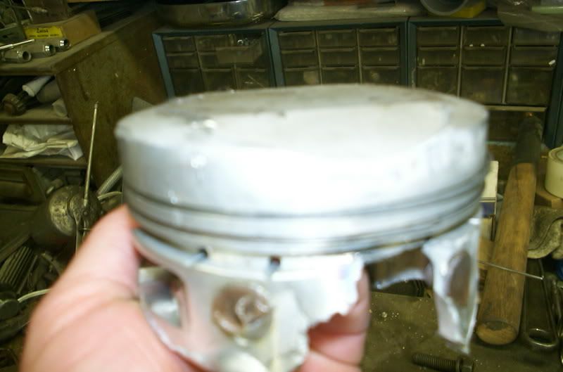

here is a good pic of a piston

Sorry, it wasn't, but like people have suggested the problem is not the pistons. Something went wrong in the engine management/fuel supply realm.

I can try my better camera, if I can find where I put those pistons. I blew one so bad one time, that it almost turned upside down in the hole while still attached to the rod.
