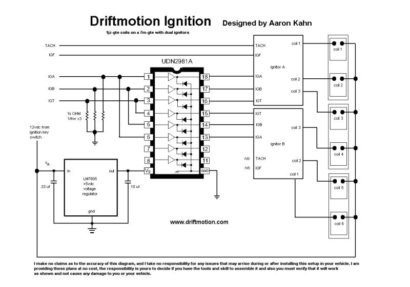

I will have to remember to bring those clips down soon for your plug wires. I will Pm you the guys number with the front end pieces you need.

No problem. I bet I still even have an extra bread board and housing sitting around somewhere.
