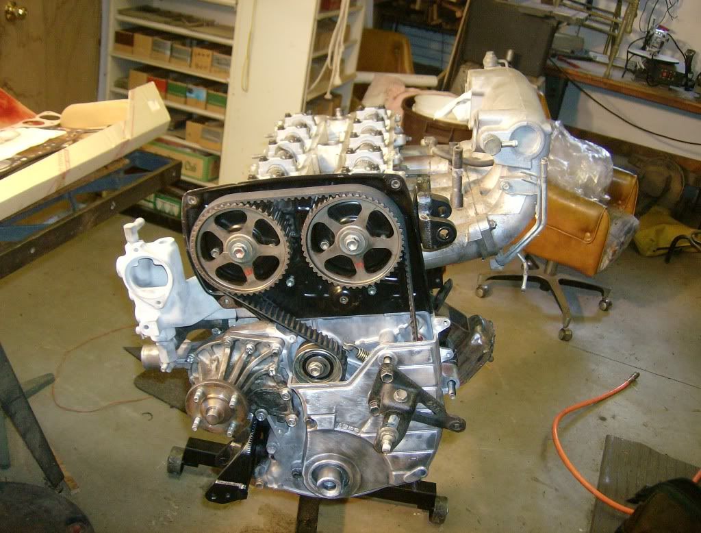

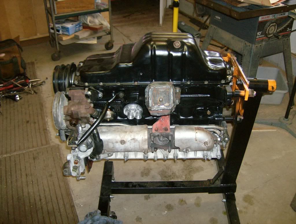

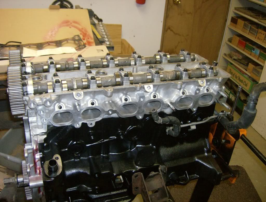

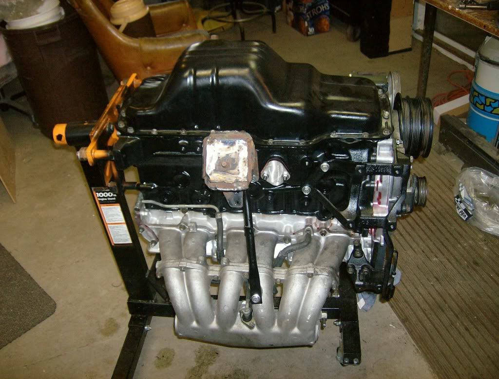

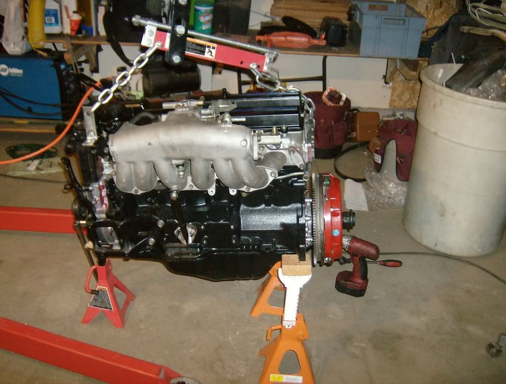

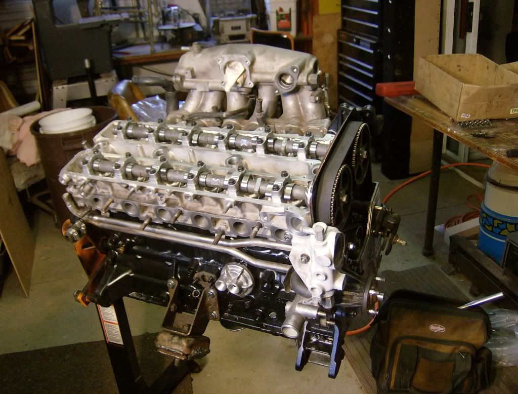

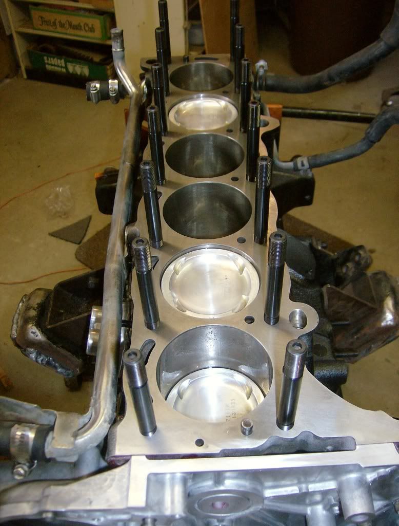

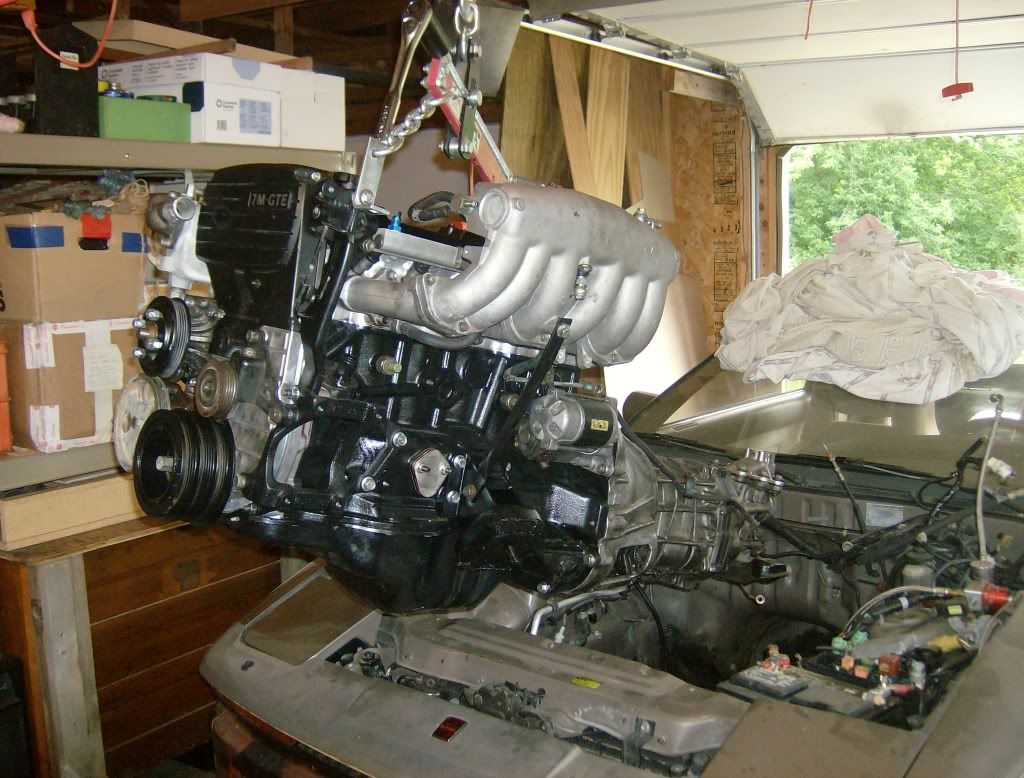

Ok so pictures...
So there is the Motor.
Eagle Rods, Wiseco .020 over pistons, ARP Head and main studs, new factory valve springs, totally reworked head, balance rotating assembly. :icon_evil

funky_monkey58;1350104 said:
Get this shit done already. I swear my supra will be back on the road before this at this rate.
Dude... i would have been running this weekend if Jack was around... I have the motor in and am waiting on IC piping and a turbo install kit:nono:

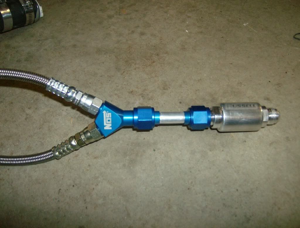

Kept on clogging on the dyno, every 4 or 5 runs we would have to clean it. Then it finally let enough shit through and clogged up the injectors to the point where the car would barely even idle. And that was on 1200cc injectors.
I am using a mallory fuel filter with a paper element that takes me 45 seconds to swap out.

The filter Sean is talking about is linked below. Pick it up because as Sean said those little filters colg really fast. I also was there on the dyno day and we cleaned it 4-5 times that day.
http://www.jegs.com/p/Mallory/Mallory-Fuel-Injection-Filter/745069/10002/-1
^^^ Pick up one of these to do your filtering.

Sorry wasn't trying to be a dick just giving the guy some grief is all. The filter rob posted is the one I am running now. So far so good.

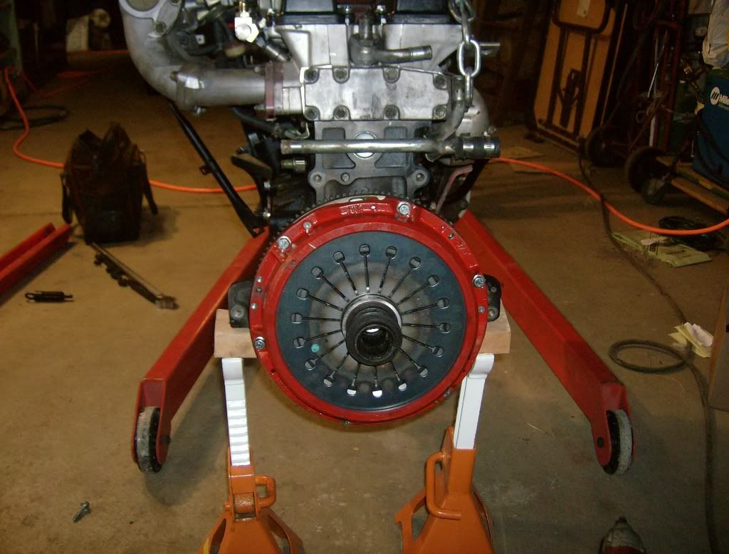

Err. I am an idiot... I knew i was forgetting something when i was putting my clutch together. The snap ring wave washer and plate washer on the release bearing... DUH. Ripped the motor back out in an hour. Now off to work to fix a damn 4runner with a bent axle. Not gonna be fun at all
