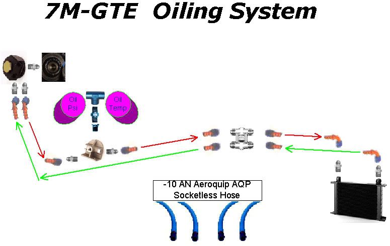

That's what I'm using is the Aeroquip Push-Lock hose. $70 bucks for 20' from Summit.
I am however using hose barb fittings. Some brass and some AN. Everything has been double secured with the wormgear clamps that utilize a sleeve as to not cut/mar the hose when tightened. The clamps are made by 'Ideal'.
As difficult as the pushlock hose is to install on the barb ends, I can't see them coming off! Especially with the clamps. I sure hope not anyway!!!!
EDIT: I think I'm confused with terms here. Are the brass ones 'Barb' ends and the AN ones 'Push-Lock'?
Also, this diagram shows the use of barb ends...

Yea that's what my question was going to be since i'll be upgrading my oil cooler circuit pretty soon..
Should I use standard barbed fittings with push-lock hose or are there AN barbed fittings specifically designed for push-lock hose?

I have a mixture of both in my system.
I will say that the AN barb fittings are MUCH harder to get the hose on to so judging by that, I would say that the AN barb fittings would hold better. That's just a guess of course...

I also have some of these on my bench. It sounds like I should run these instead of the standard brass barb ends.
Here's another question or thought... I've noticed that some of these hoses have resistance ratings on them. Is that because static electricity builds up as the oil passes through the hose? If so, would then the mixture of different metals be a problem? As in brass fittings, aluminum fittings, steel fittings, all in the same setup...

You will be hating it if you ever have to remove the hose ;)
There is no static problem - you can get corrosion between different metals - steel and aluminum primarily. In a system pumping oil though, it should not be an issue.
