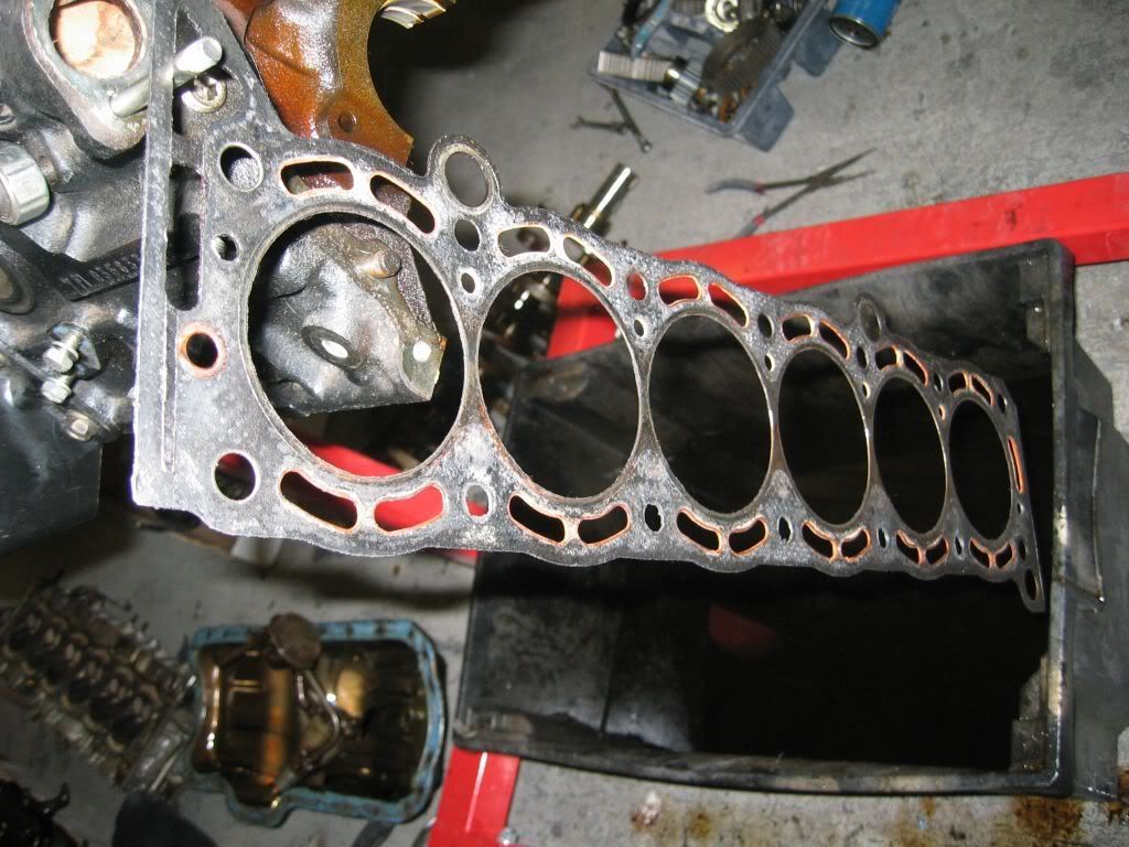

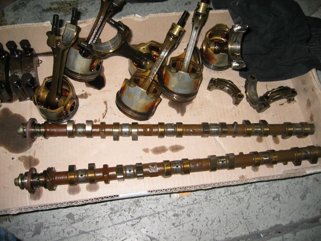

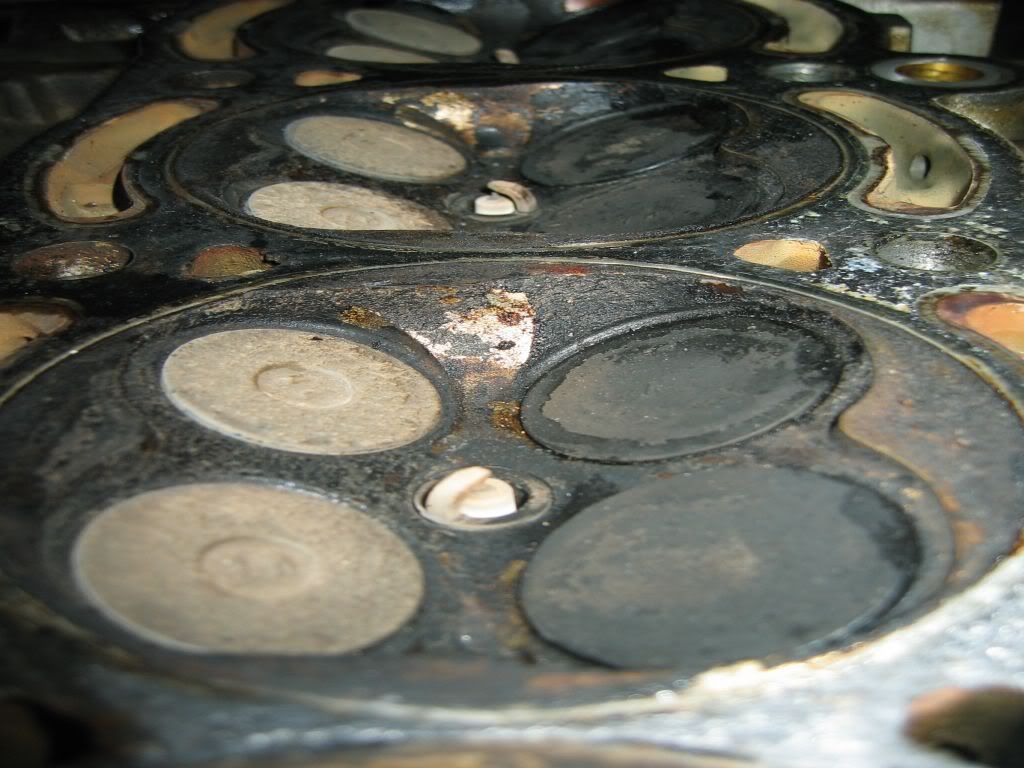

Guess what? I didn't have a BHG! but apparently i was getting combustion passing through the cylinders through the head gasket. and the head bolts were super loose.

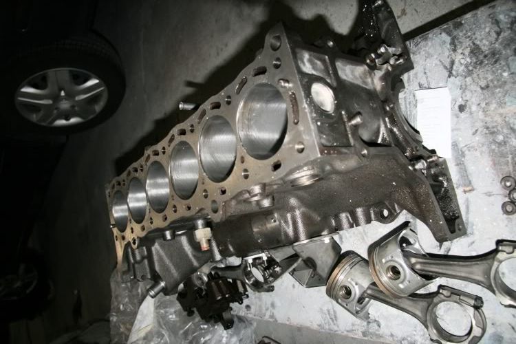

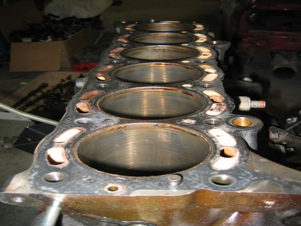

What do you guys think about the block top? I couldn't see much corrosion.
It should be back from the machiners tomorrow.
enjoy the pictures.

Combustion gases passing through the cylinders through the head gasket you say? Um, yeah, that is called BHG ;). Don't assume the only BHG is one where coolant mixes with oil.

yeah, the mechanic explained that he could see marks inbetween the bores where the HG wasn't sealing. I just meant that a Blown Head Gasket in my mind normally means its blown somewhere, but as you can see, there are no breaks in the gasket.
The mechanic is putting a cometic head gasket in it with ARP bolts or studs.

Are they gonna hone the cylinders for you? Is that ridge at the top of the cylinders very big? You can get a cutter just for that. Just make sure its done before they hone it.

what ridge?
I'm getting a standard rebuild done, I don't know if honing the cylinders is included in that. I will ask.

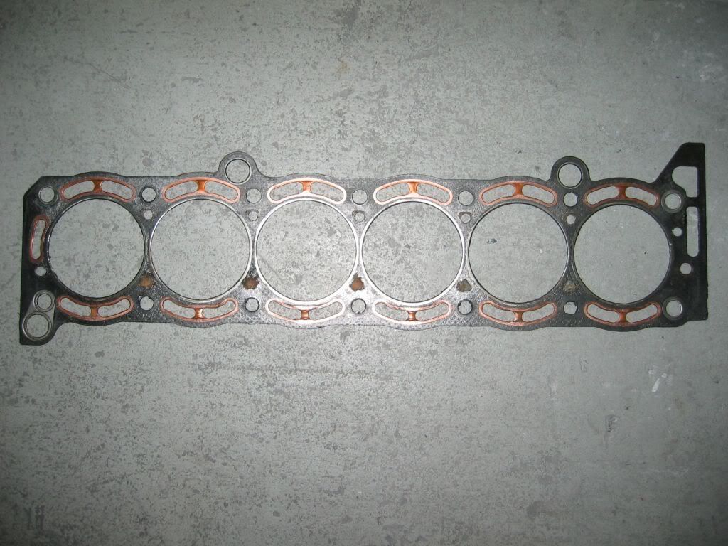

supramacist said:
I wonder if you can tell if that is the og gasket, the stocker???
Some of those bad boys held.
The mechanic doesn't think its an original toyota. The place I bought this motor from 2 years ago put a new HG in it. Its just some composite cheapo I'd say.

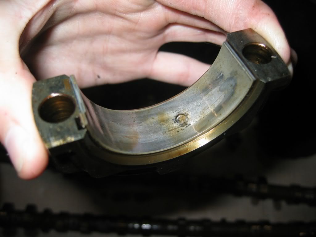

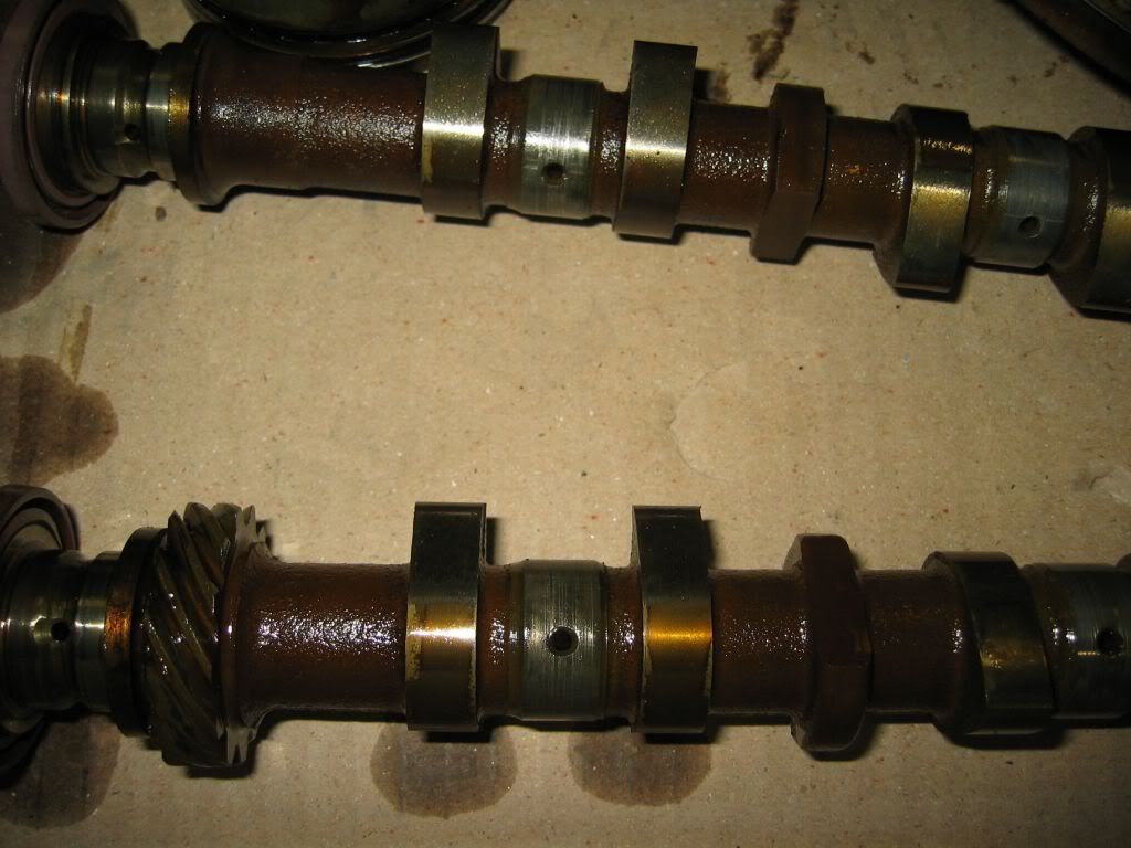

Yes, the bearing you show is worn pretty bad. Can't quite see brass yet, but its close. The cam journals look a little rough. You can mic. it, and compare it to the TSRM here: http://cygnusx1.net/Supra/Library/TSRM/MK3/manual.aspx?S=EM&P=48 If its within specs, you may be able to smooth them down somewhat. Just make sure they don't become to small.
The ridge I mentioned is at the very top of the cylinder, inside of it. You can see it in the pics. Its the top part of the cylinder that is discolored. If you run your finger up the cylinder, you'll feel a bump at the top. The reason for it is that the rings gradually wear the cylinders up to a certain height, especially when the engine isn't oiling correctly(For instance, its constantly run low on oil, or the oil isn't changed at the correct intervals.). The ridge is where the rings haven't worn the cylinder down. Sometimes they are really bad, and sometimes they're nonexistent, depending on how well the engine was taken care of. Your mechanic can get a ridge reamer, which will cut the ridge out to the same size as the rest of the cylinder.

Thanks for the link.
Oh that ridge, yes someone showed me how to feel for those. but the ridge is not where its discoloured, its lower from what I could tell. I can't wait to see it all cleaned.
