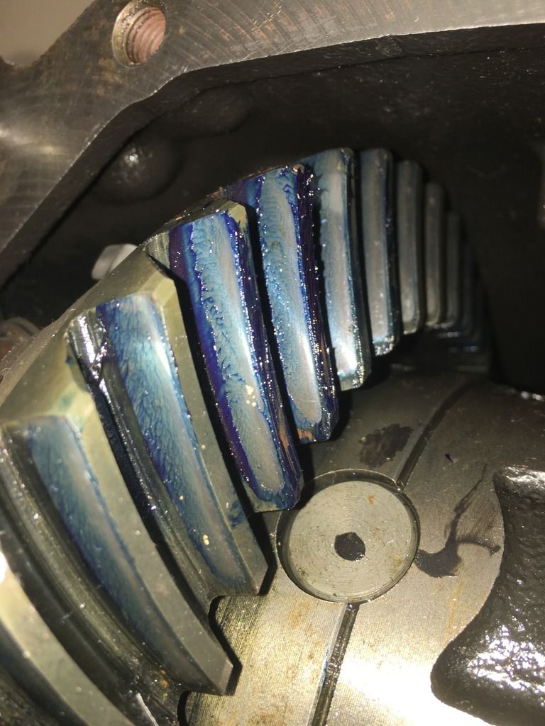

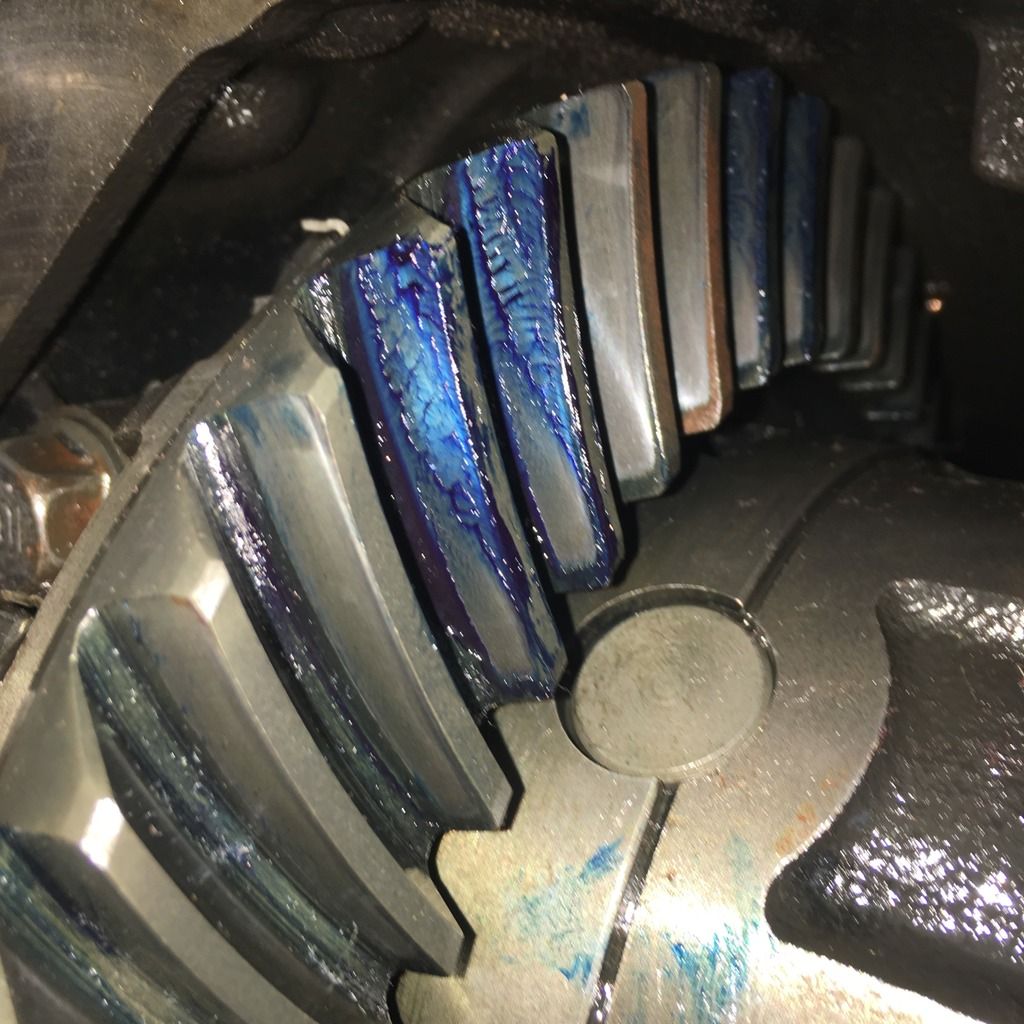

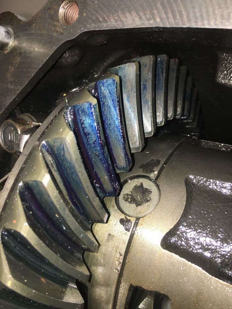

So I'm in the middle of swapping over to 3.73 from 3.91 because I broke the ring gear on my 3.91 and had a spare 3.73. Also wanted the extra mph in 4th and just see how I like it since I've had 3.91 ever since I did my swap. I tore it down to put in a newer set of clutch packs I had and to add shims/ the extra spring from the weir kit. Got that done checked backlash and it was good at 6-7 thousands but the contact pattern isn't ideal. It's on the toe of the drive side pretty bad. The coast side looks better but still on the heel a little much. It's looking like the pinion depth is the issue. I really didn't want to mess with doing the bearings. especially adjusting pinion depth because that will require pressing the bearing on and off that everyone seems to have a nightmare doing. Looking at turbo street cars pattern his is sorta similar. thoughts??

It does look low on the tooth. Mine was low, but centered higher. Yours seems to be centered right at the bottom of the tooth. Maybe contact weir And see what he thinks?
We're those used gears?

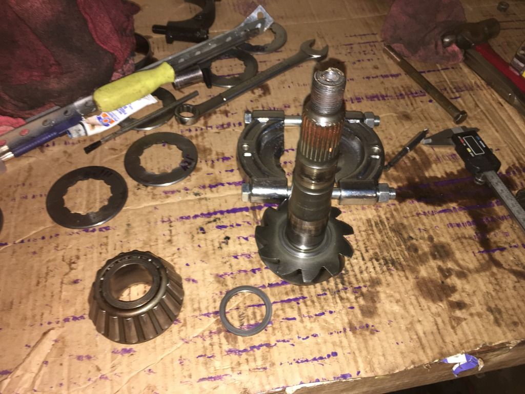

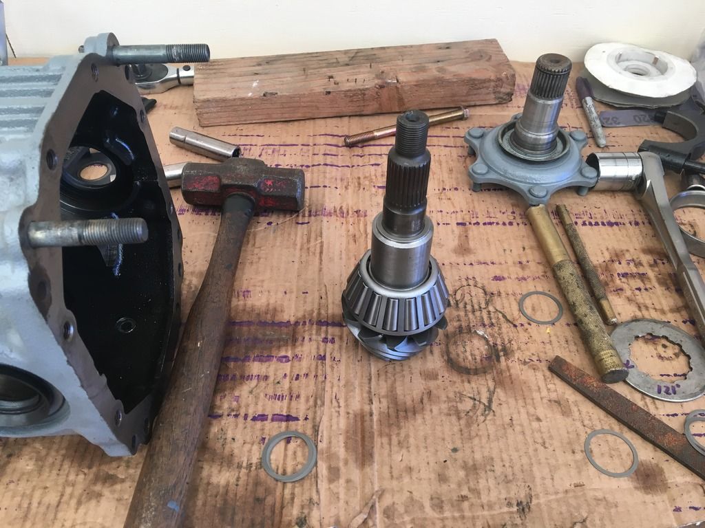

yeah this diff i took apart to just do the clutch pack/shim/spring. put it all back how it was and this is the pattern i got. i do recall this diff whining. i'm curious what will happen if i adjust the pinion if it will run quieter and get a good pattern so decided to tear into it. got the pinion bearing off pretty easily actually. just heated with a mapp gas torch and pressed it out. i have the same press as you too. it made some noise but nothing out of the ordinary when pressing stuff. the shim in there was .076-.077 i'm guessing its the .0764. thinking i'm going to order the bearings get the .0669 or .0681 not positive which one yet then throw it together and see how it looks. those are the two thinnest on the chart.

When checking the pattern, it's important to get the side bearing cap bolts torqued a bit. The diff case must be solidly in its place before you measure anything. I will also suggest making sure the outer races and the carrier are perfectly clean so they sit together properly.

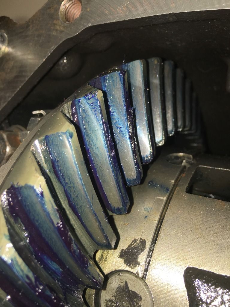

finally got to messing with this. ended up getting a .0717" shim to play it safe and put it together. the dam pattern isn't really looking as good as id like it still. you can see the prussian blue isn't as thick at the top but i'm still not happy with it. the .0669" is the thinnest looking like that might be more where it needs to be.
and i have the caps torqued when checking the pattern and all. it lays pretty consistent patterns with the prussian blue. also doing the crush sleeve eliminator have had one for a while now. pretty sure its a yukon its high quality and fits perfect though! was sorta a pita getting the preload right but happy I'm doing it.
the hardest or more so annoying part for me was i installed the larger race and looked to see if it was seated. there was a small space on one half and was flush on the other side. so i knocked it back out (brass drift work best doesn't bounce around and won't damage anything) to find that side of the case had a slight chamfered edge making it look like it wasn't seated. knock it back it with the old race agian and was good to go :biglaugh:

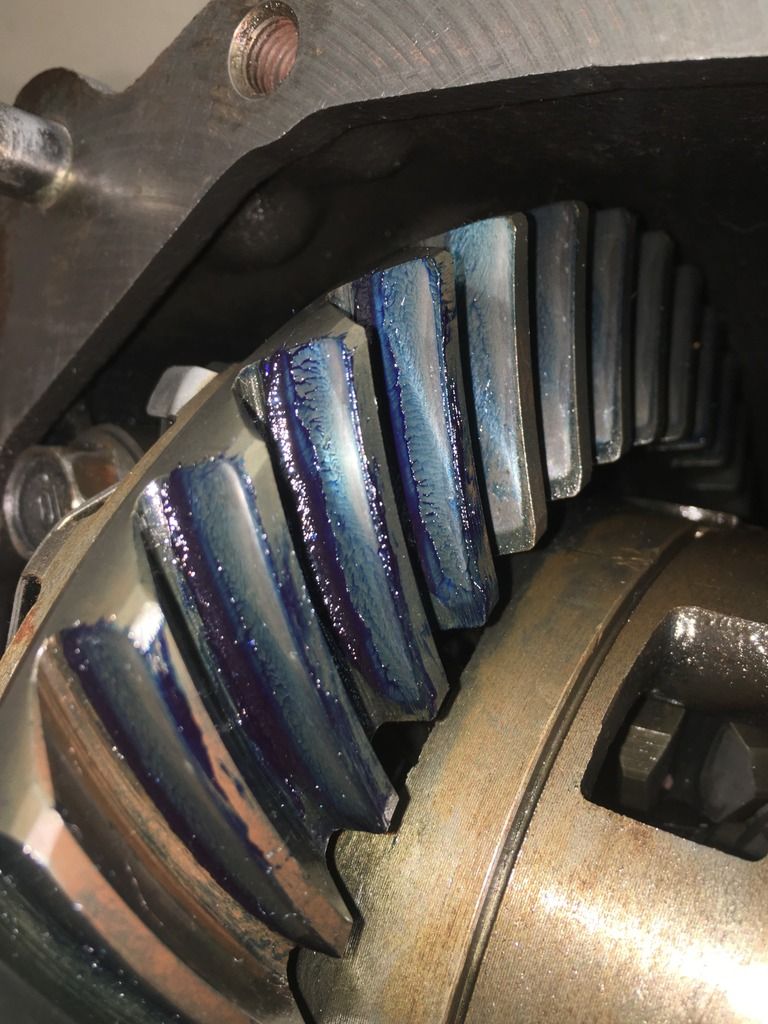

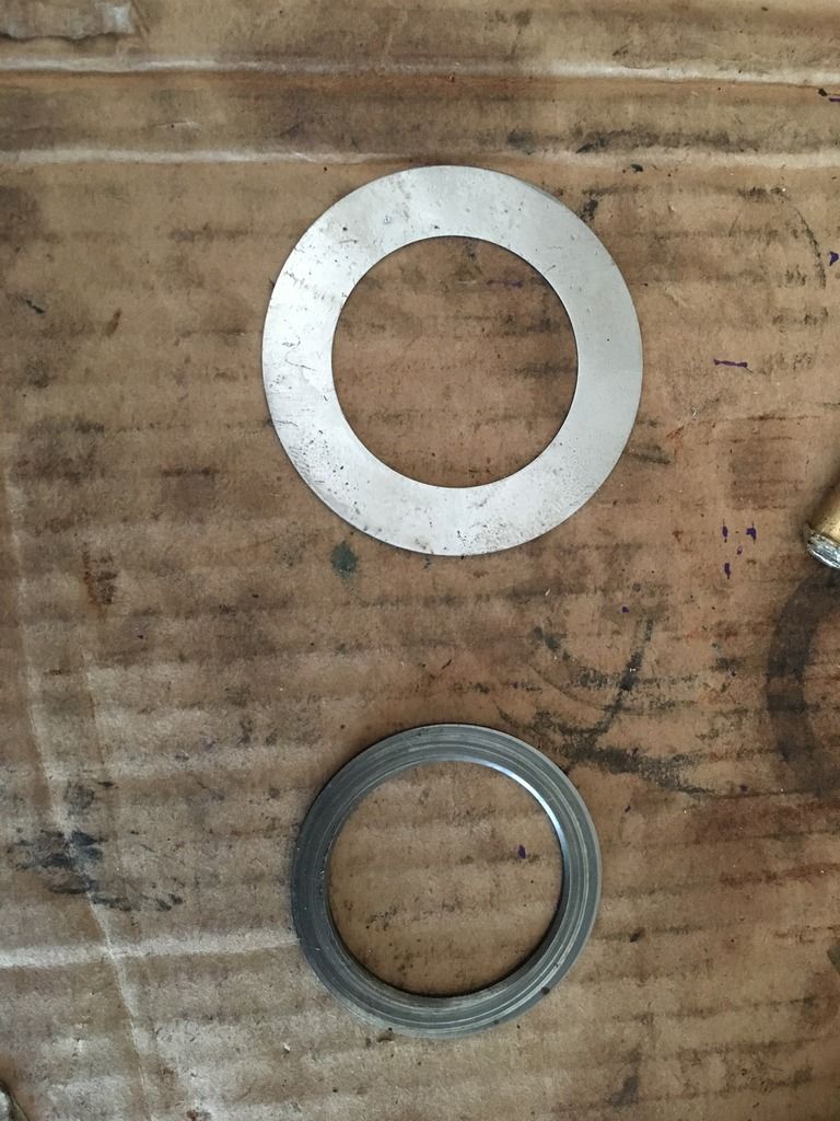

ended up going to a local off road shop that does lots of lockers and gears. they had some shims they gave me. rockys off road ftw. i got a .050, .010, and .015. tried .060 first and it put it on the opposite side too much. then went with .065 which got me a pattern im happy with. its a little on the toe side but with used gears apparently you want it more so there if it has to be one or the other. the new bearing presses on and off easy too nothing like the old one thats been on there forever so thats not anything to worry about. another thing i did was the shims on the diff i swapped to get the backlash a little tighter. was .119 on the ring side .121 on the other. went from .007-.008 to .006-.007 and made the pattern a little deeper in the ring gear. think this is going to have a lot to do with it holding up to launches better. i'll let you guys know how it runs when i get it in the car!
this was with the .060
the .065
this was after the backlash adjustment and the pattern im going to run.
the aftermarket shim. it actually has more surface area for the bearing to seat on which is nice.

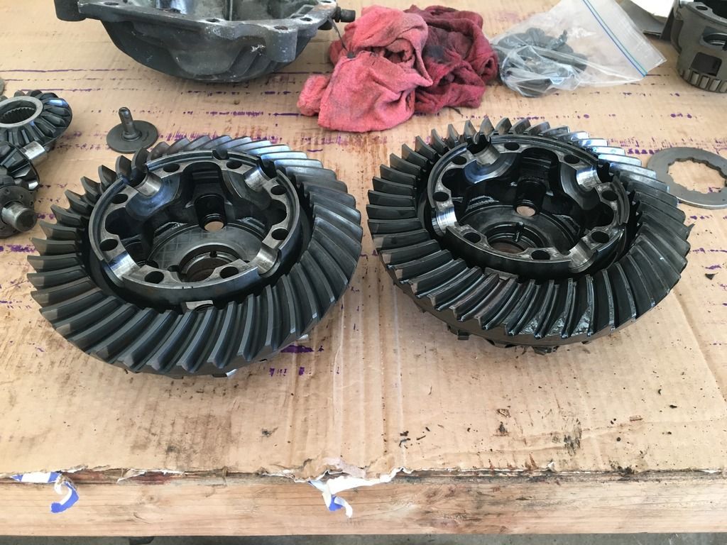

and cause i know we all like pics heres my broken ring gear. looks like it wasn't meshing good either how it just broke the heal off. also you can see the 3.73 has larger teeth than the 3.90 which is a plus.
