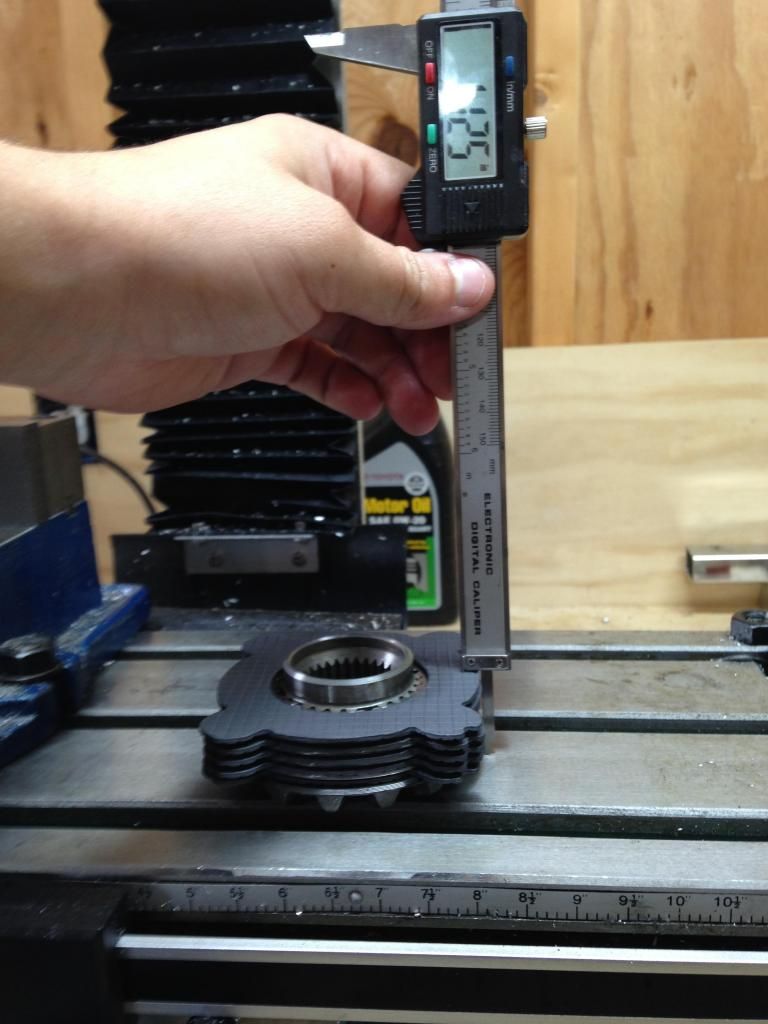

I have three photos to add to the mix.
For measuring the thickness of the clutch stack and side bearing, as well as the depth of the carrier, I found a way to use my dial indicator and magnetic stand. My dial indicator has only 1" of travel, so it can't measure these directly. Turns out my "LH Retainer" is exactly 1.200" long. So, it's easy to use the "LH Retainer" as a reference. The side gear and clutch pack is about 1.130", and the depth of the carrier is about 1.770". Two photos show how I measured. It's important to squish the clutch pack as it will compress 6mils or so.
Sure, I made some assumption about the flatness of my table. The side wings of my old table saw are flat enough for me.
The 3rd photo is my pinion in my press getting that huge rear bearing off. It's basically straight out of the TSRM, but thought I'd show it in case anyone wanted to see.
