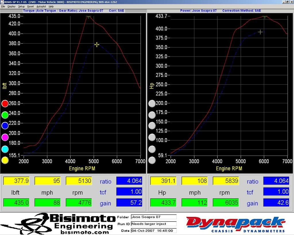

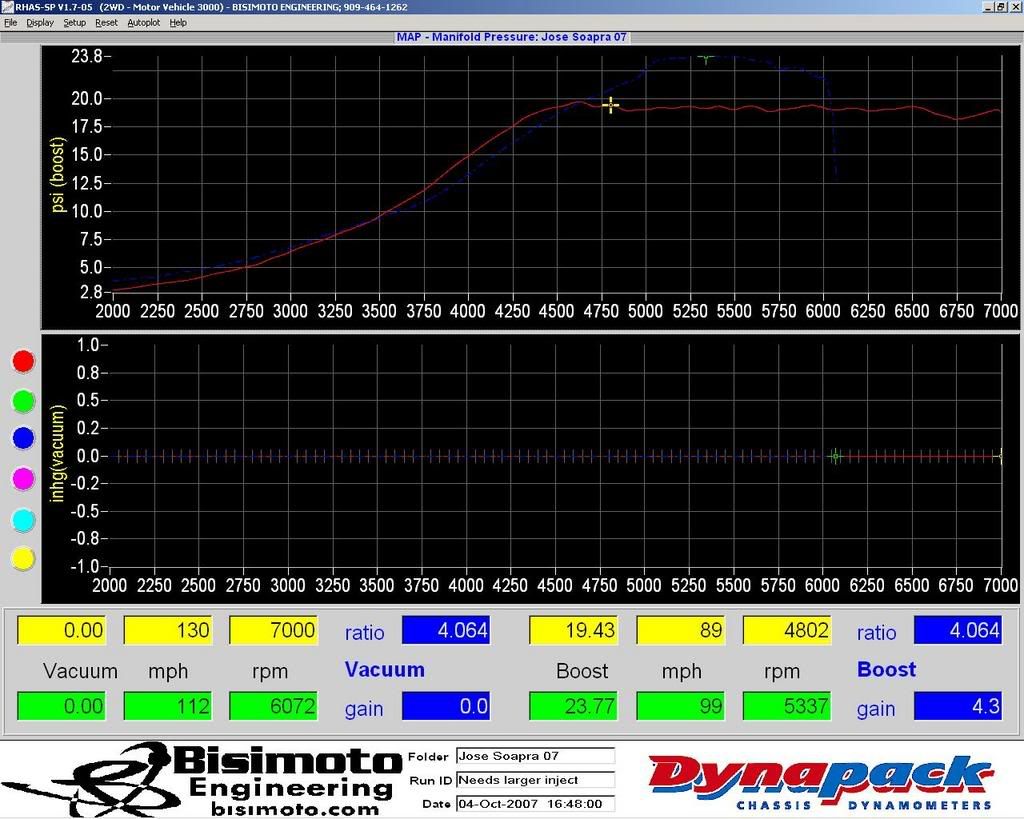

soapra;1351579 said:Sorry for the late reply guys. Shop keeps me busy. Here is my dyno sheet with the same twins that terror owns now. this was on 100 octane, 440cc injectors (should of had 550's) stock cams, 3in dp, no cat and hks high power catback, SAFC Neo and HKS intake. 23 psi of boost. I think with 272 cams and bigger injectors i could of hit 500+

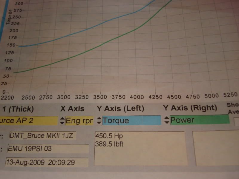

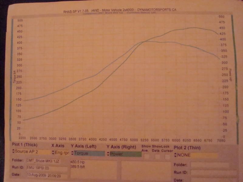

You're turbos must have a different exhaust housing if they are holding 23 psi to redline on the 1J. My turbos wouldnt flow enough gas to make this possible. Sounds like your housings might be .64 or similar.
