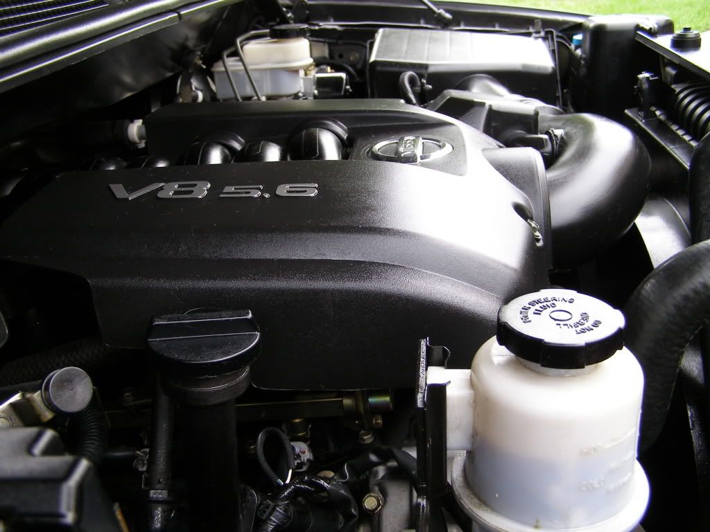

Here is my engine bay. What is safe to use for cleaning it?
