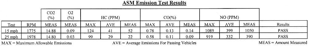

I PASSED NAZI-FORNIA SMOG!!!! WHOO HOO!!!!
nox barely passed, so obvisouly my egr valve needs to be replaced or cleaned... but my brand spankin new cat sure did the trick for my HC! only cost me 80 for the cat and two flanges!!!!

i REALLY didnt want to... and i figured i get a free re-test anyways, and nox was never my problem, so i said lets go for it! i only had 5miles on my new cat when i passed... so im very pleased.
the new owner is coming back monday with $1800 cash to take it away, and then i get to register and smog my 90 turbo!
