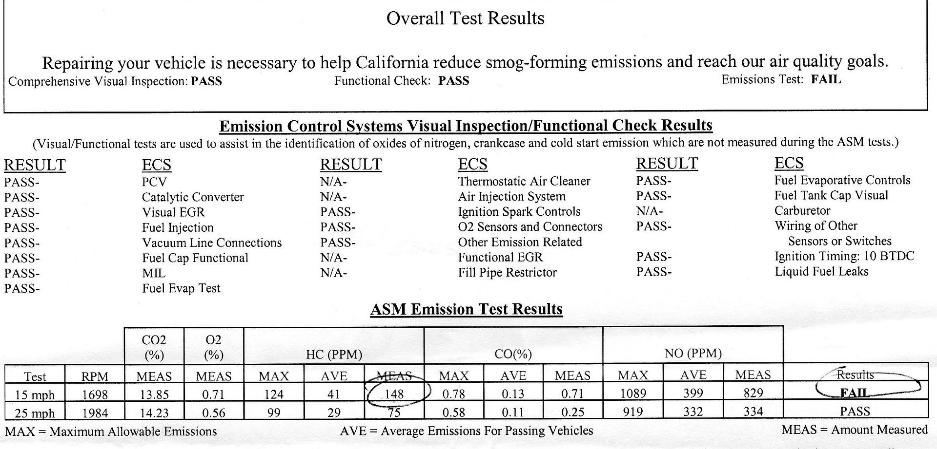

First smog: went, everything was fine, passed everything except my HD was at 148, and the max is 124.... sigh... my car was starting to overheat because the tech forgot to put my e-fan on, so the first smog was done under a MUCH hotter engine than normal.
went home, and looked over everything and made sure the car was all good. ends up my timing was at 8 Degrees on the first smog, so i reset it with a wire hooked up the diagnostic box, and reset it to 10 degrees.

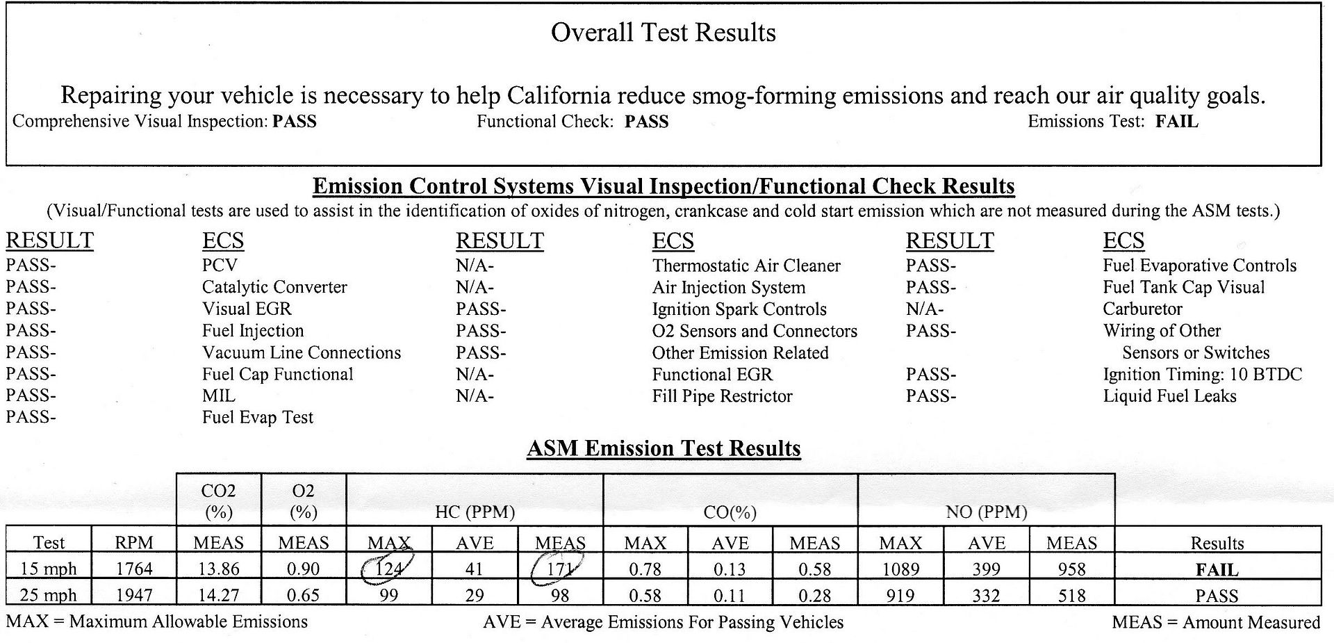

Second smog: made sure the e-fan was on during ALL testing, and everything was fine and checked out good, NO over-heating what so ever, test was done under normal operation temps.
now, i do have an exhaust leak, but its after the cat, and the smog tech didnt really seem to care, even though its a little on the big side... i can feel about a 1/5 of my rear flange isnt flat anymore, so it leaks out of there, but that shouldnt effect my HC...
AND: i passed evap both times.

OK, I'll write em up for you, I'll edit this post with the what his results where. Also, upon looking at it, I wouldn't have passed either as their levels are much lower. Typical Cali crap...
EDIT: His high O2 levels and his high NOx levels compared to me looks like he's not properly igniting the fuel and looks like EGR isn't working. Also, he said he had a code 22, but the engine assumes normal operating temp in that case.
First test
High speed (25MPH):
HC 75 (99)
CO 0.25 (0.58)
CO2 14.23
O2 0.56
NOx 334(919)
Low Speed (15MPH)
HC 148(124)
CO 0.71(0.78)
CO2 13.85
O2 0.71
NOx 829(1089)
Second Test
High speed (25MPH):
HC 98 (99)
CO 0.28 (0.58)
CO2 14.27
O2 0.65
NOx 518(919)
Low Speed (15MPH)
HC 171(124)
CO 0.58(0.78)
CO2 13.86
O2 0.9
NOx 958(1089)
First test
High speed (25MPH):
HC 75 (99)
CO 0.25 (0.58)
CO2 14.23
O2 0.56
NOx 334(919)
Low Speed (15MPH)
HC 148(124)
CO 0.71(0.78)
CO2 13.85
O2 0.71
NOx 829(1089)
Second Test
High speed (25MPH):
HC 98 (99)
CO 0.28 (0.58)
CO2 14.27
O2 0.65
NOx 518(919)
Low Speed (15MPH)
HC 171(124)
CO 0.58(0.78)
CO2 13.86
O2 0.9
NOx 958(1089)
