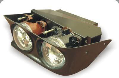

For those that haven't done the conversion, these are the arms that need to be modified. To make the installation as user friendly as possible, I think I should provide modified arms for the conversion, but I'll leave that as an option.
Thanks in advance to Tekdeus for this pic from his thread...
The arms are minor details...my main task of the project is to be able to mass produce the Hella 90mm mount/bezel. For the mount/bezel, I've got to decide between a unit that will require cutting the headlight assembly vs a full replacement (of the headlight assembly)..

For my setup, cutting my headlight bucket, creating a mount, installing the headlights, then wiring the lights in took a day. The only thing that I haven't done is create a bezel, which will not be very difficult.
KeithH;1366716 said:
There is no need to replace 54110/54120. You can actually use these as the base for your new assembly. Remaking these so you can keep all of the factory mounting points will be a HUGE task. Just cut out enough material to fit the new lights - trust me... it can be done. Also, you don't have to cut the radiator supports or anything... just the headlight bucket.
For my setup, the only thing that I've cut is the headlight bucket. I trust you, that it can be done, the setup is already on my car :icon_razz.
As far as making a new assembly. Yes, it's a huge task, that's why no one has created this part. I want to create something cleaner than "cutting" the headlight bucket. Basically, I'll be recreating the headlight bucket that is purposely for the the Hella 90mm headlights. In order to use the factory mounting points, I'd be reusing the bracket that holds the headlight bucket onto the radiator support. Ultimately, I'd like to have something like the setup below
