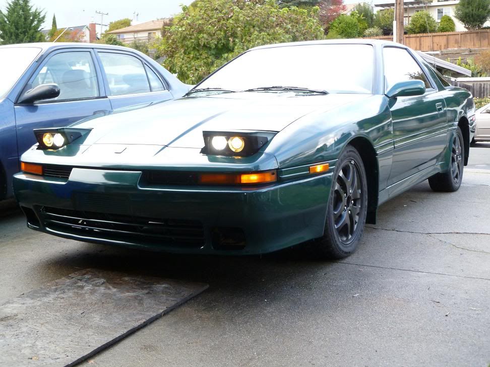

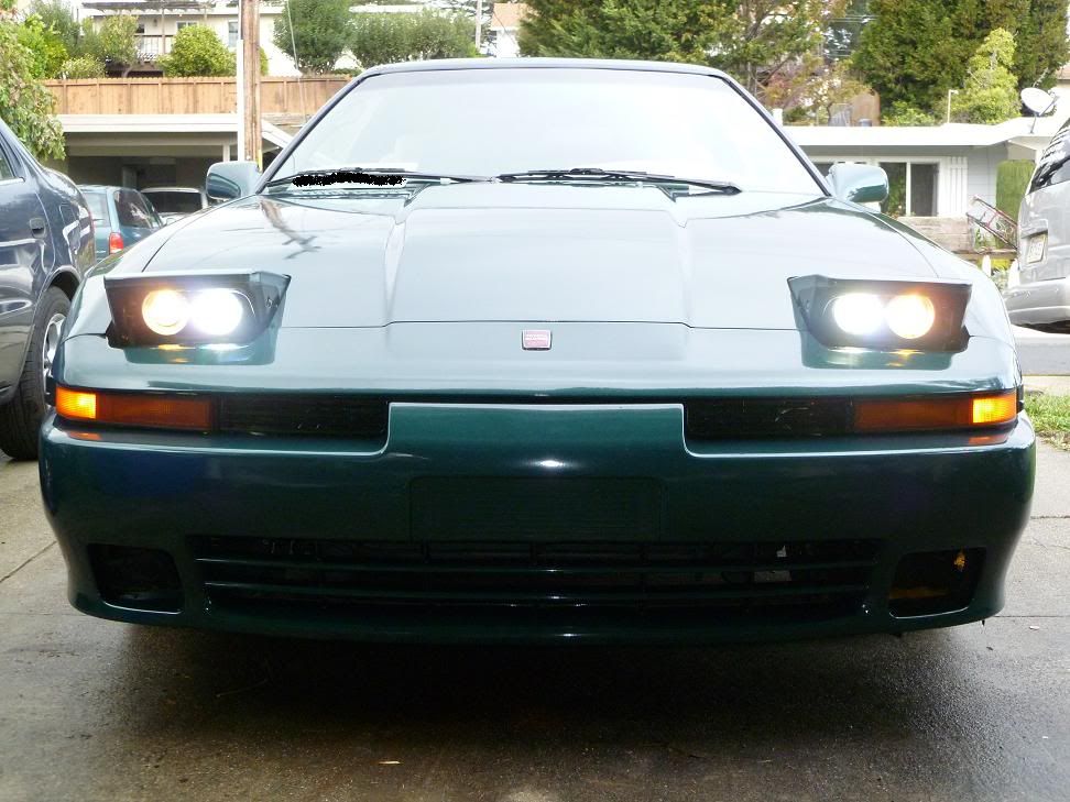

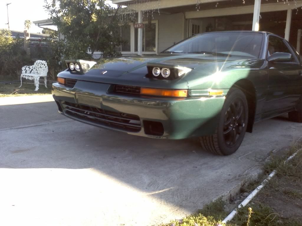

the flip headlights irritated me while driving at night so i did a sleepy-eye mod and also a head light housing mod and this was the result:

Looks good!! what kinda projector and housing did you use? I envision mine would look something like that... have you thought of a custom plastic molding for the housing? and how did you mod the height of the headlights?
btw whats up with ur tires?? why so far in? =O

hahaha the tires are of some honda definatly gonna need some spacers or go with some 17X8.
anyways i used a bixenon hid projector and random projector fog light kit off ebay. i took the original bracket for the headlights and i welded a piece of sheet metal to it that i fabbed to be able to put both lens in it then i sealed it with roof sealer ( i figured that would be weather proof and sturdy enough).
as for making the sleepy-eyes theres two arms that make the headlights flip. 1 is the one connected the the motor and the other goes from that arm to the housing itself. I head to cut both of these the same amount and then i riveted another ball joint to the arm connected to the motor.
only thing i wasnt happy about at first was i had to remove the stoppers and cut of the part of the stopper that connected to the chassi but the motor automaticly stop when the arms reach a certain point so there is no wobble

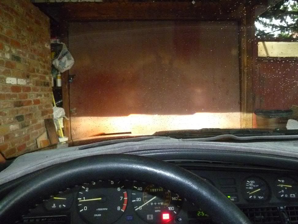

hmmm ic ic... looks like it worked for you!! and I see you have a good cutoff... but I am no expert so don't quote me on that lmao... and I presume ppl don't flash you?

at first they did but that was because i was stupid and didnt realize the smallest angle upwards would travel so far with these bright ass lights lol but since they are sittting in the original housing the lights adjust the same way
