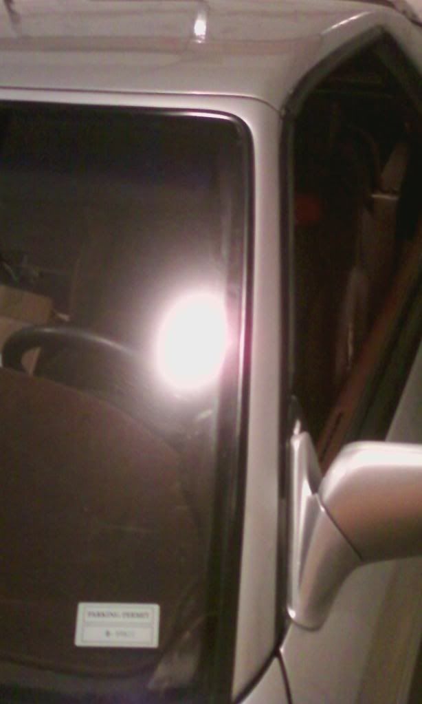

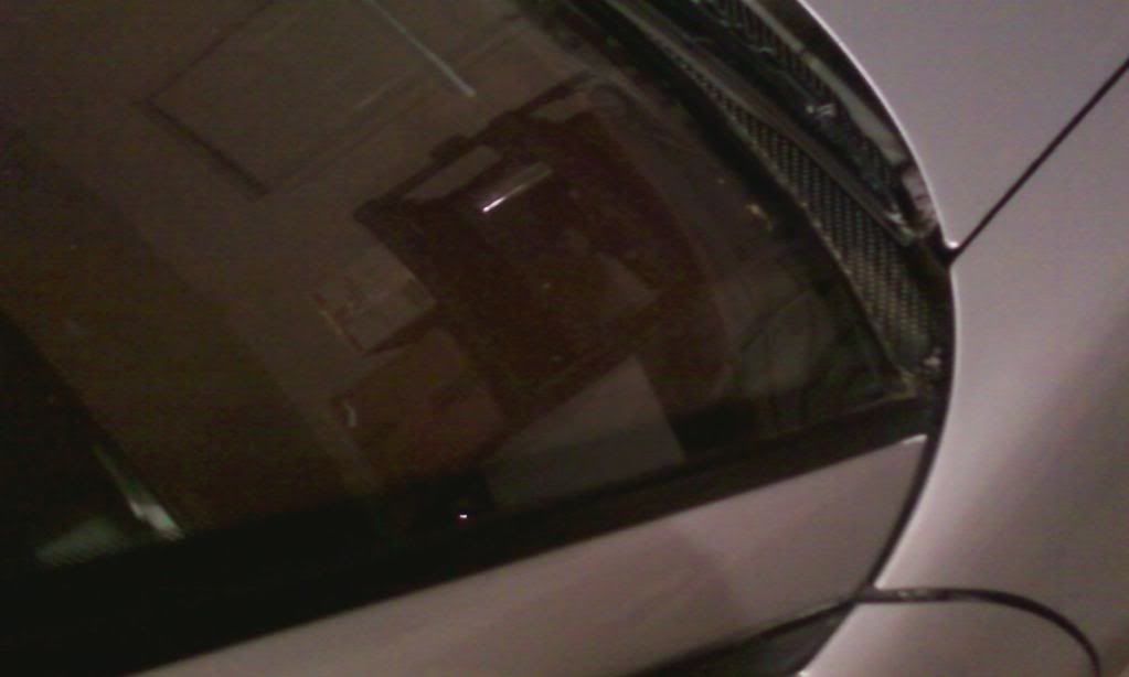

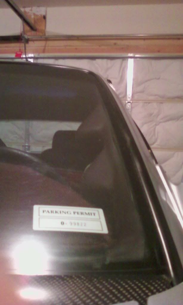

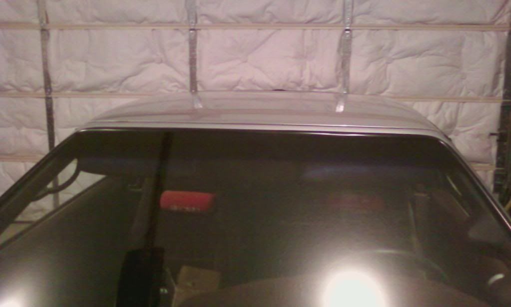

hey can we get some closer pictures of that updated windshield trim? is this something you can buy and do yourself?
right now i don't have any trim on the windshield because the top piece fell off and basically one piece holds another..
details please, undergoing trim crisis here! haha

George, the window replacement guys will have a new type of trim that doesn't use the hooks. Phillip's said they are going to use it on his car as well when he replaces his windshield. It's about a half inch wide and will be brand new.

I just had my windshield replaced on Friday, and I had them use the new-style trim as well.
Looks fantastic., and I imagine that due to the lack of a raised channel, there might be less wind noise from it too.
