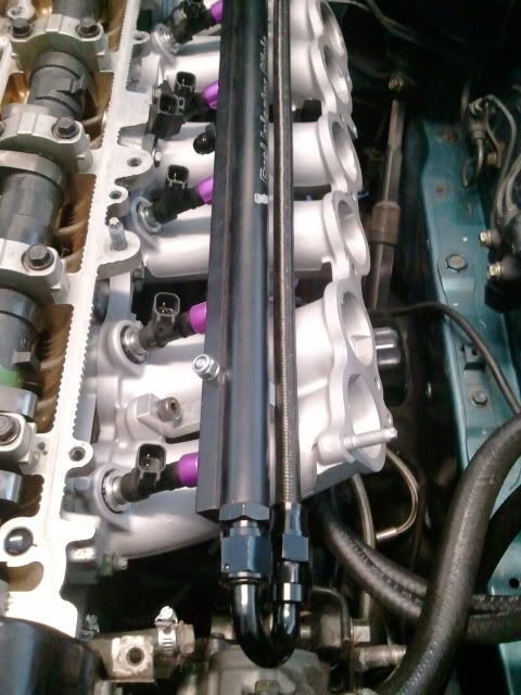

Got all my AN fittings in and laid it out how it will go in my car. one -10 split to two -8 then a -6 return. White box signifies regulator and the pen signifies my fuel rail.

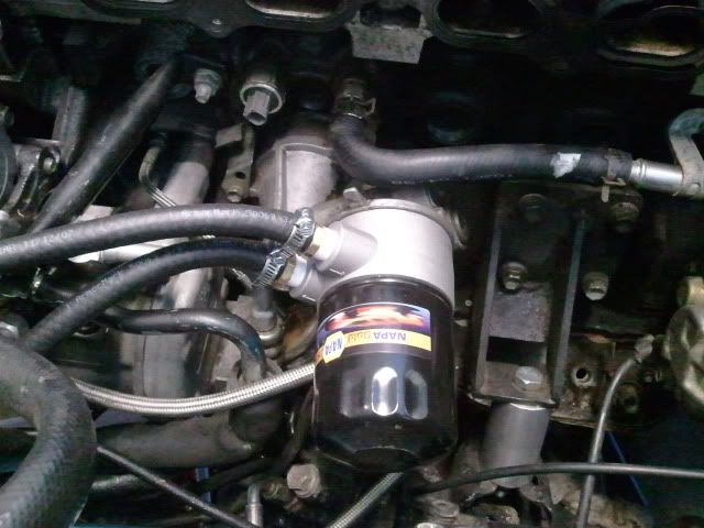

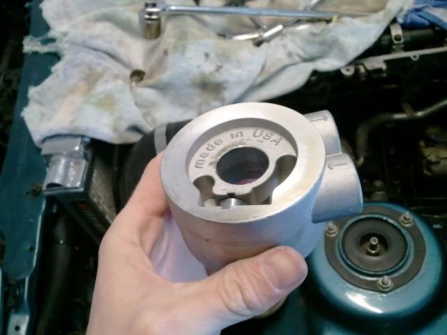

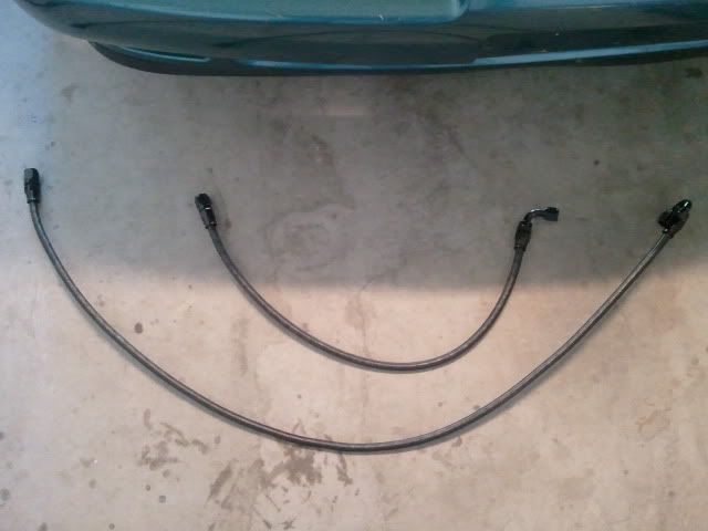

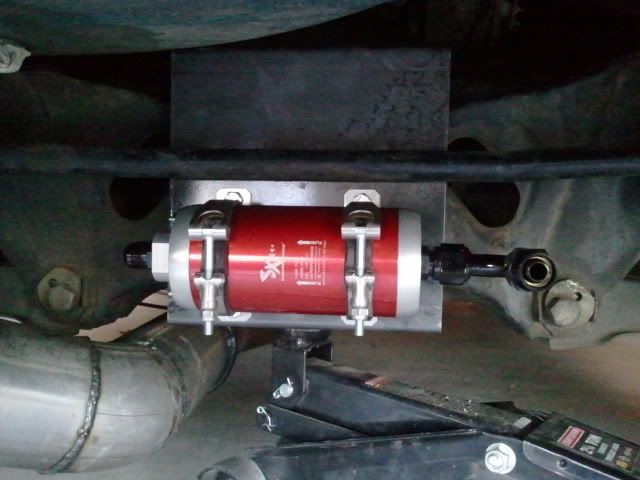

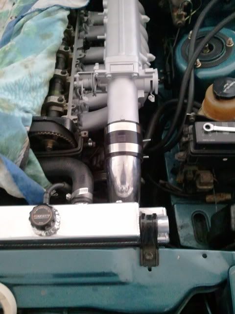

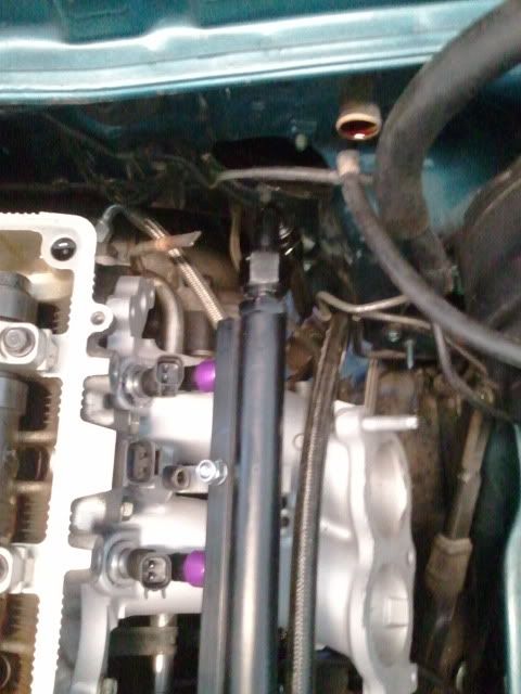

Well made some progress, started working on the fuel system and oil cooler setup. Here's some pics
Thermostat Plate
Fuel lines
Fuel pump bracket that uses the bolts differential to be mounted, I'm not quite happy with the placement Im going to place the sump above the swaybar to protect it more.
And I have re-routed the IC piping for a cleaner look as well instead of the swoop around :)
