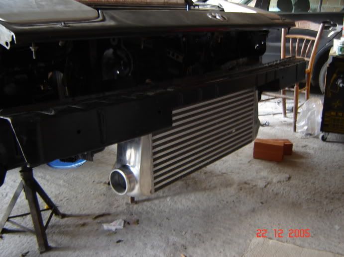

Hmm...I guess it has to do with the structural differences between the mkiii and mkii then. You see my intercooler is in no way bigger than yours :aigo: but it's still quite big, here's a clue:
so basically the top is level with the top of the bumber where I mounted two brackets but the rear is way off the lower frame support, plus I have the oil cooler hanging right behind the lower portion of the intercooler. So two straight brackets similar to the top ones are out of the question :(

YANNIS thats good to know but dont forget mine is already relocated (alternator that is with a ron r bracket ;) )
ah as far as the intercooler goes i'll post some pics for you as i sort ripped everthing out on mine to make room for it ;)
