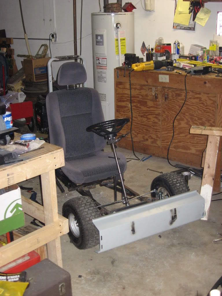

figit, ive just got ball joints hookin mine up and its turnin out ok. ill have pics here tomorrow after i finish the shift setup

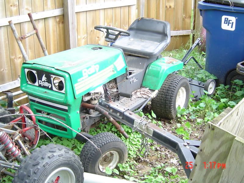

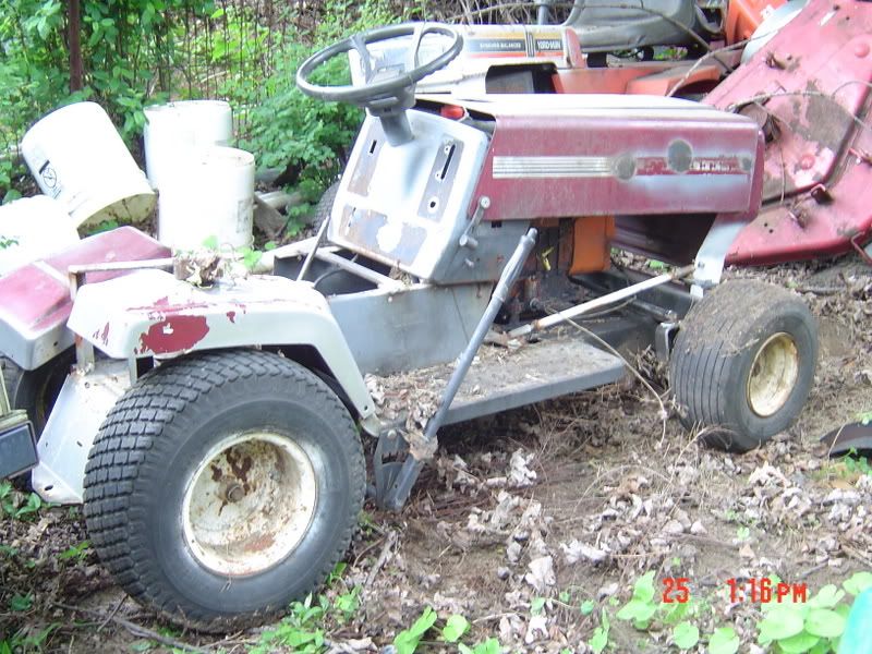

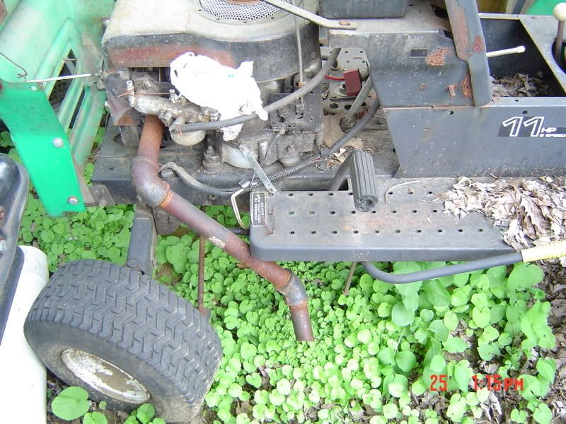

ok guys! update! I found a new engine! well, its used, but looks to be in great condition because the case has no surface rust, and the owner said he kept up with the oil changes and maintenance on the engine but the rust got to the mowing deck and its shot so 3 years ago it went into storage and now he took off the tarp and its got some rust down low but its fine where it counts!
so i've upgraded to a hopefully perfectly running, non-smoking (lol) engine with 1.5 more hp! and a cast iron sleeve if that helps at all...
now i just have to get it home. :D
but the difficutly doing this with my small truck (with a shell :icon_mad: ) is worth it, for the mower is FREE!! (not including scrap fees, but those are minimal)
here are some pics. basically everything but the wheels, tranny, belts, engine, electronics, and the seat will be scrapped. same procedure i did to my last dead mower that dared to throw its rod... :evil2: and to let you know i wont be using the 7 speed tranny except for possibly fun to see how long it takes to blow it up, as toyotah8tr says they, like the 5speeds, are not designed with the same integrity as the 3 speed i already have.
if only i had two identical engines, i'd do a dual setup...or try it at least. :biglaugh:
maybe someday i'll make a dual-engine 4wd....
sorry sorry...pics!
