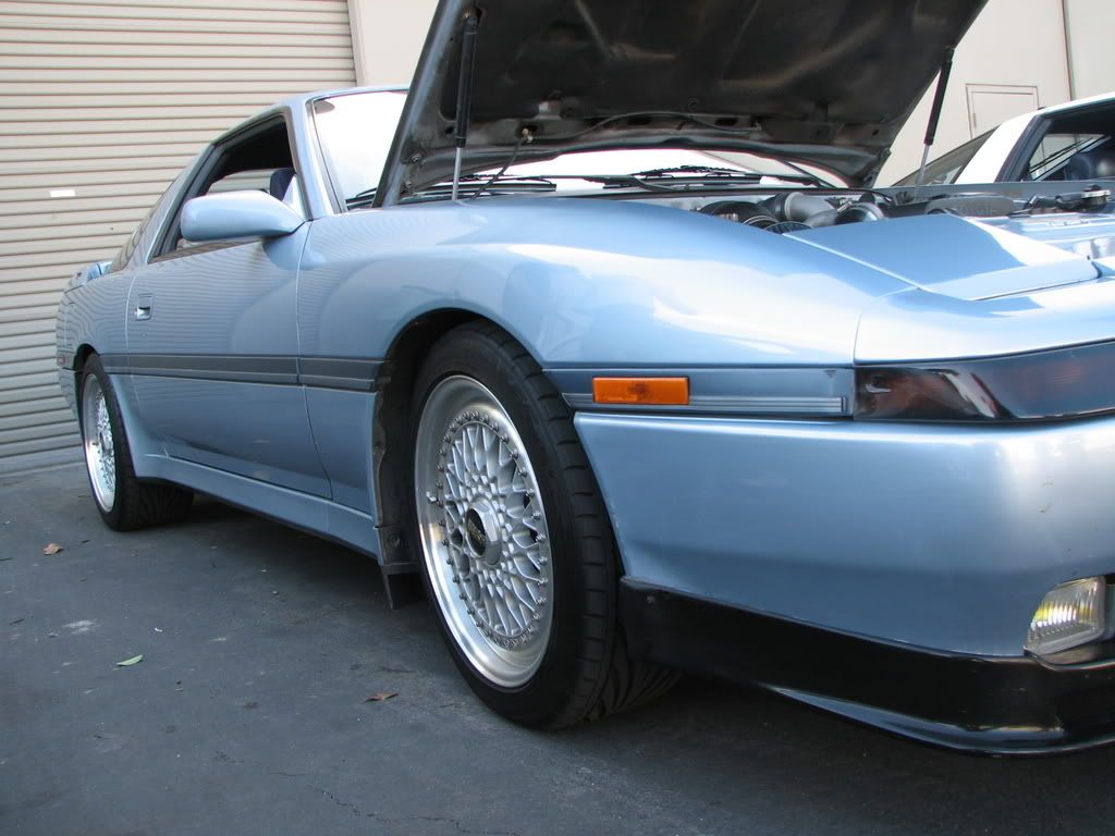

TTR Bilstien + TTR springs in the rear
TTR Bilstien + H&R spring front.
Gave me this

if you want daily DONT get H&R's...
you feel everything. and they make the car pretty low. i have NO wheel gap in the front, and 1 finger in the rear.
and these are on hp blues.
i love the look though, and gettin sideways with stiff suspension is even better!
