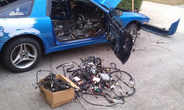

Ive stripped my entire car of wiring and Im re-wiring the entire thing from scratch using a simple hot rod style universal kit. There will be one fuse box located behind the passenger seat (rear seats are going), and all wires will run from there. At this stage it looks like I dont need to lengthen any wires, except the included headlight circuits will only trigger a relay, which will then have its own circuit.
Battery will be moved to the boot (or behind the seat as well), factory battery tray is being sliced out. Engine loom is getting a new loom to suit the Haltech.
Should be a MUCH simpler/lighter way of doing things as there are alot of circuit check/etc wires which I wont be using.
Heres how much I removed.
BTW, the previous owner had moved the fusebox under the wheel arch......it was the most horrible and stupid idea I have ever seen. Please do not do this!
