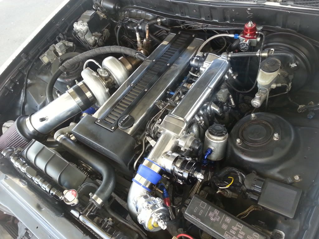

One thing that needs to change is the fan clutch setup. The ls400 fan clutch is on 100% of the time and loud as balls.
Anyone know of any other setup that will allow to run a 7mgte fan blade ?

Is you Iac recirced into the inlet too?

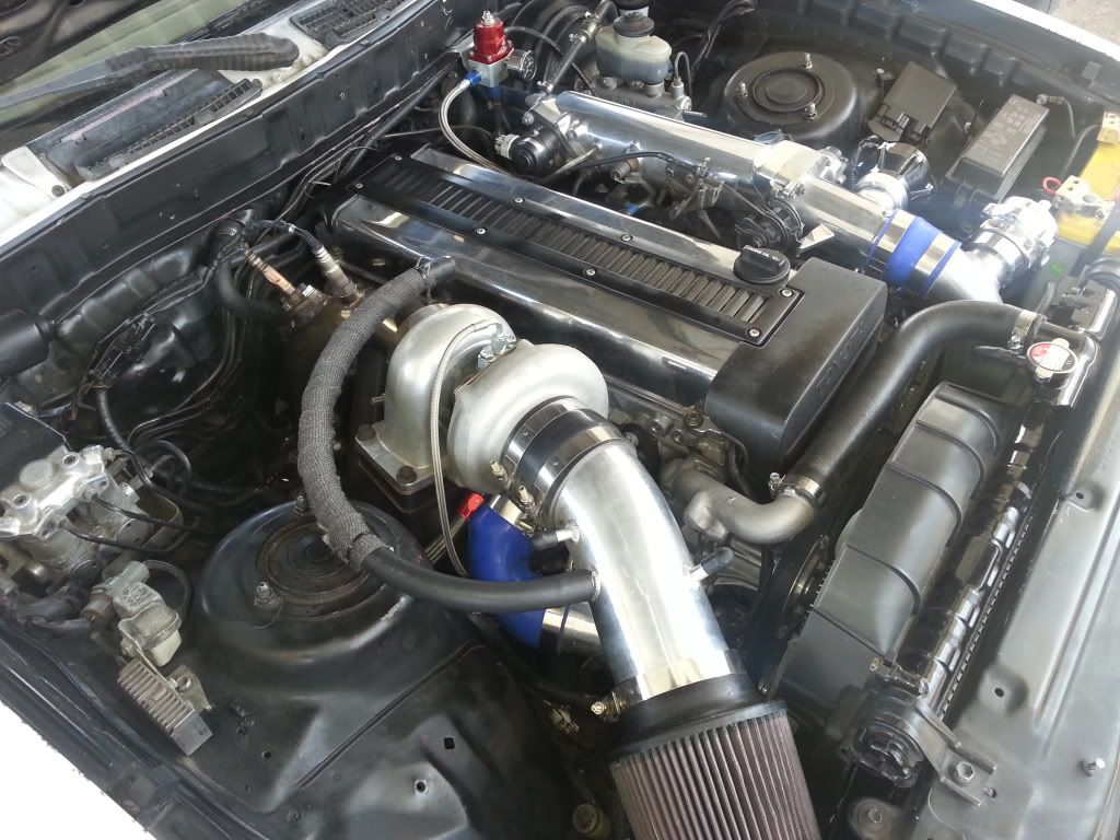

please do something about that hose from PCV to inlet
Its slow. But no big deal to me im just haply to have it.
I will take care of that hose asap just not sure how yet.

Just go to a RC car shop and buy like 1k or 2k silicone diff fluid for the fan.
I put 3k in mine and its a little too much for me. Might work better for you since your in a hotter area.
Or you can switch to a 2jzgte fan clutch with 2jzge fan blade.

Okay I got ya.
You should do custom bent lines that hug the motor to firewall and do a catch can.. Or do what I did on a fresh motor that has no blow by, put a filter on it

Use a 2jzgte fan and 2jzgte clutch, I used 2k silicone and its amazing, fits the oem shroud too
