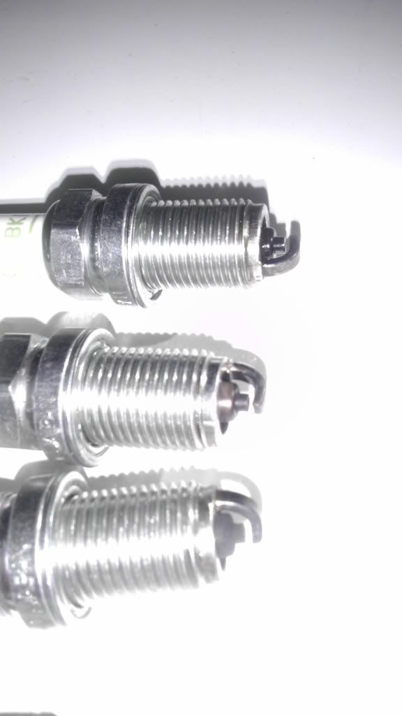

I'm no expert but this looks like an electrode indentation on your piston man..... look at the wearmark here on this pic looks like your pistons are slamming the plugs....?
You took a good side pic of 3 plugs, and not the rest......are the bottoms of your plugs worn or bent wtfff did you check the plug gap across all plugs to see if theyre in spec.....I dunno I think your pistons are hitting the plugs
If youre playing guinea pig with those ngk's and piston dome on those CP's bro I think you ought to look into different plugs. I think that's the problem. If im right you drive to MN and give me a ride in that car kthankzzz?

That pic is of cylinder number four
I looked at all plugs and all are seem to be untouched by the pistons.
Also it wouldn't explain why the sound is slow or why it comes and goes.
In this photo the plug at the bottom of the picture is plug #4

Just from eyeballing that top plug in your pic looks like the gap is off? Do you have a gapping tool? Check that gap across all plugs. Then check to see what NGK reccomends the gap to be for a 1jzgte for your particular plug model. I hope youll find your current gap where your plugs measured at are way off. I hope at least.
If non conclusive, ask your guy if he has a bore scope and have him come over again. If not, you can rent one somewhere or borrow one, check if valves are hitting your piston before you yank the head. That should be the cheapest route. I think your piston is touching the plug. Rods may stretch over time, the machining done would bring the head closer to the block as well. Not to mention your possible head gasket choice. I can visibly see the electrode mark on your piston. Well, at least, it sure friggin looks like it anyway....

The plugs are NGK bkr7's gapped to .028 I've never had problem with these plugs on any of the motors I've ran 7M and 1J's
Also when cranking the car with no fuel or spark and the plugs removed it sounds normal. You can look down into each cylinder and everything seems to be looking and sounding good.
But, If they all measure at .028, nothing bent, and the piston is not hitting my theory is wrong, Im full of shit. Listen to me and possibly get hurt or killed or worse.

and this one.jpgelectrode.jpgTwo sounds now, two pistons look like they got the same indentation marks, what is on the top of this one too? Looks like a ball of crap, and an electrode mark as well for 2 pistons hitting. Used to sound like just one specific knock in your gopro vid at night, I will agree also the sound is faster. Rather, Im saying 2 pistons are hitting now. Kind of imitates rod knock sound, but it not as fast as rod knock sounds as Ive heard on that youtube either.

Is it unreasonable to think the "bright spots" were caused by the plugs contacting the piston?
I can tell you with 100% certainty that the plugs are not touching the piston.
Is it unreasonable? Yes.
Why?
BKR7E are the plugs that are used on MANY JZ engines and they don't cause any issue.
