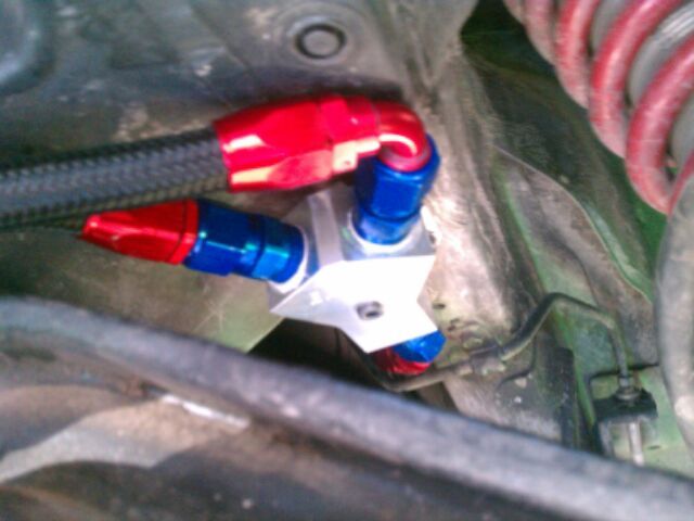

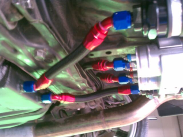

This is something a local friend built on a 10sec all motor civic.

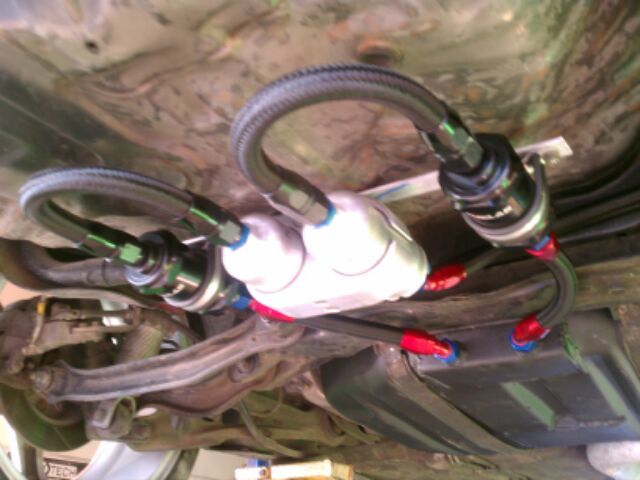

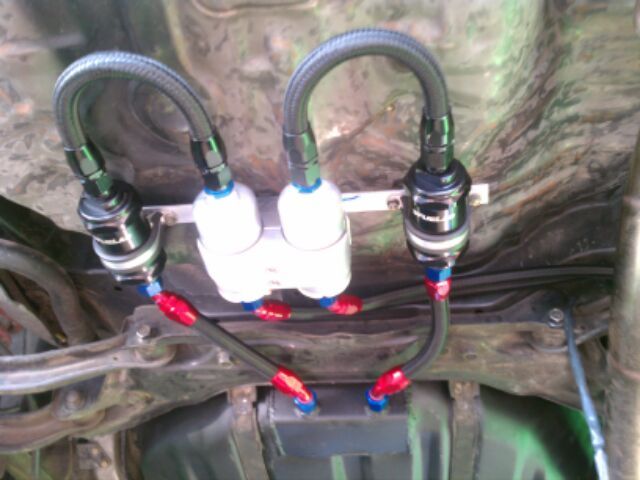

Building the fuel for 1000rwhp on e85?
That's a lot of fuel..
Run I the same as me Jordan.
Driftmotion fuel rail
Id1000s or and FIC 1000cc+
1 044 in tank
1 044 inline (secondary trigger)(boost only)
Run dual feeds and a return.
I would run the PTFE
I ordered:
30 feet of -6 line
6 Feet of -8 line
8ea straight ptfe -6an fittings
2ea straight ptfe -8an fittings
I had to order more fittings like 90deg and special degree fittings for the fuel rail
Get two inline 10micron filters with brass element. $27ea
http://www.robbmcperformance.com/products/filters.html
Then get a pre filter sock for the inline and possibly another 40micron pre filter for the secondary pump.
Get a check valve for the secondary fuel line, so when the first pump is on its not back feeding the second pump.
Hangers from Home Depot
Wired it up 12v to the aem.
