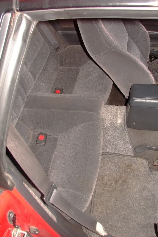

Oh, and here is the lost rear seat picture. It shows the color of the shadow cloth a good bit better. I also put my JDM floormats in it for a little floor contrast.
